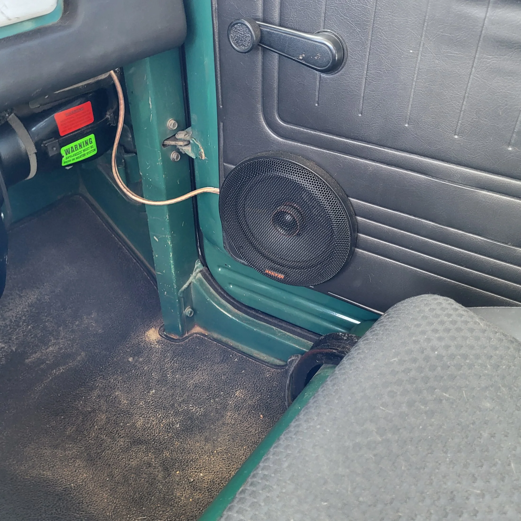

I hacked holes in the door cards.
I still haven't figured how I want to hide the wire.

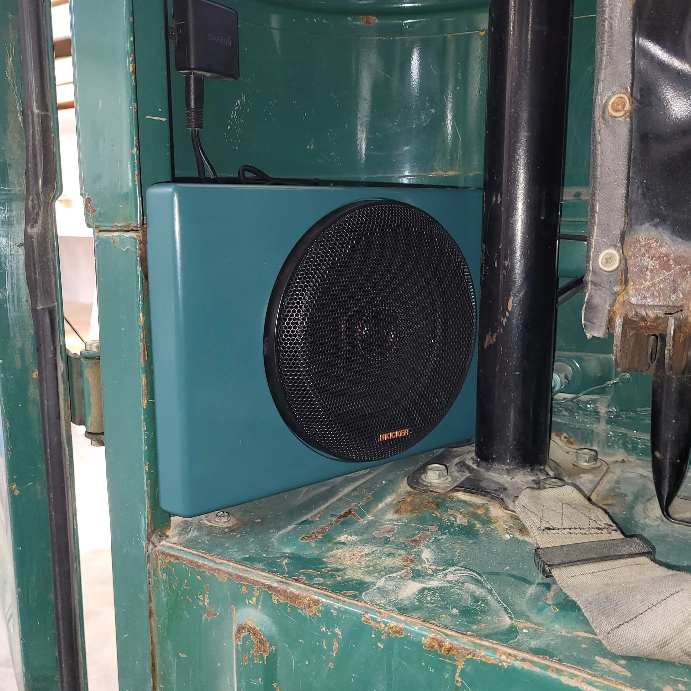

And made enclosures for the rear corners.

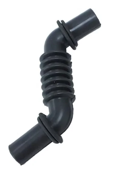

Drill hole in door and jam - use secured accordion plastic tube to shield the wire.
I was thinking about spring loaded contacts so I'm only making 4 small holes versus 2 big holes.
The problem there is FJ40 doors are dogsh*t and they don't sit that solidly on the hinges and striker.
Also, no speaker when the door is open. Not the end of the world, but some times it's nice having the tunes on while doing something outside of the vehicle.

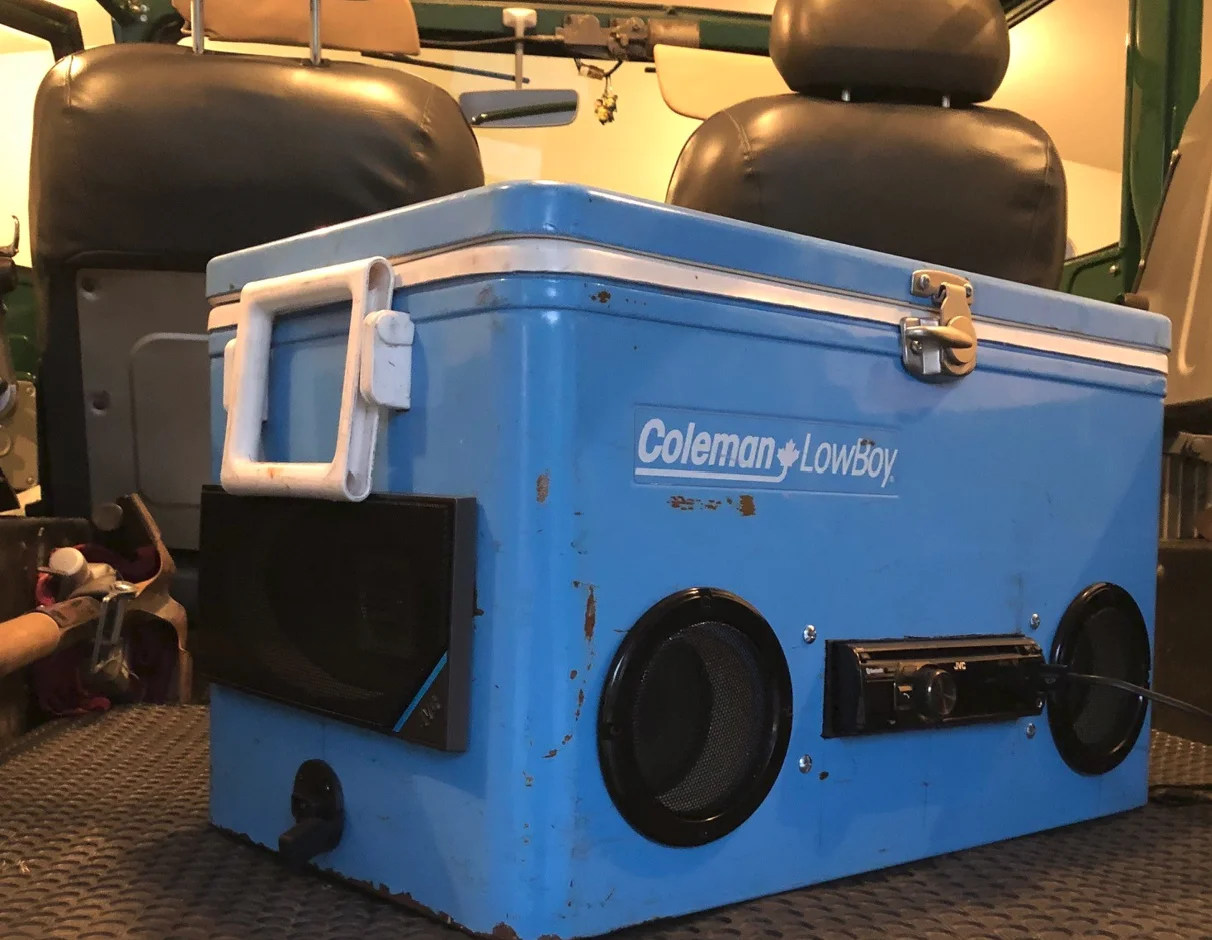

I have posted this before... I wanted to keep the stock look for Louie so I have the original radio installed however I did want music. My son and I built the cooler music box together using inventory that I had in the garage. It was a fun project to do with him. It plugs into the truck using a SAE connector so I can remove it, if I need the space. It is also locked to the truck using a chain so it doesn't go for a walk when I park the truck unattended. Added bonus is that I use the top part of the cooler for storage.
The cooler is from the early 90s and the 6x9s are from my Dad's old 82 Cutlass. We took out the aftermarket stereo before we sold it. I still have the Pioneer Cassette Deck in inventory. :)

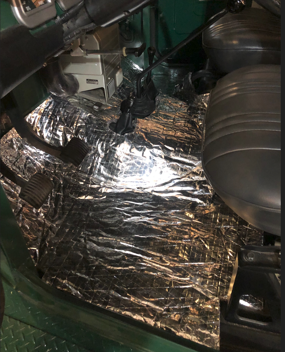

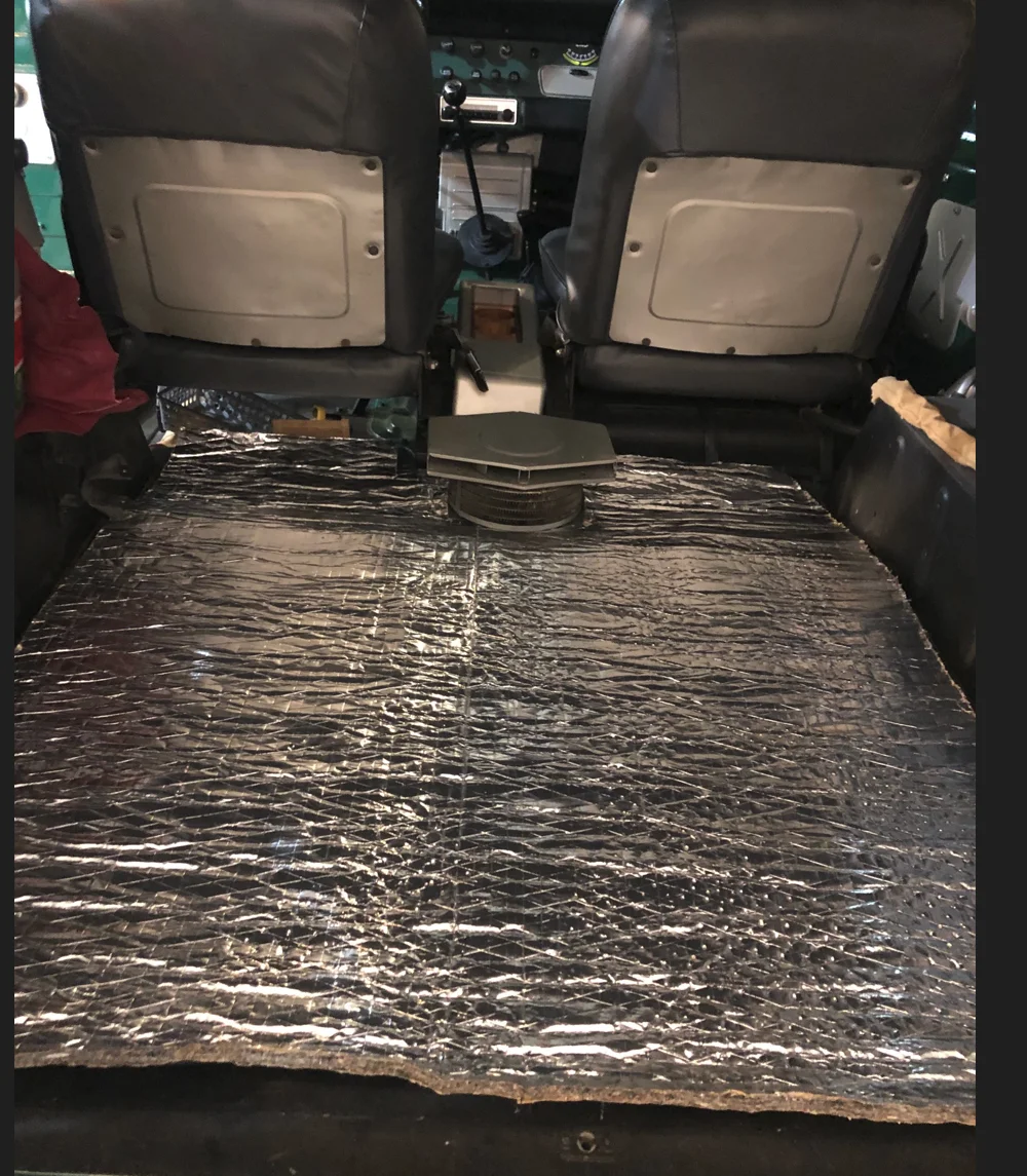

I installed the fiber backed heat mat to manage the heat and noise under the rubber mats. It did make a difference.
I installed the fiber back heat mat to manage the heat and noise under the rubber mats. It did make a difference.
That is so cool, the ice chest, very creative…..I hope you saved room inside for at least a 6 pack and a few ice cubes.🤣🤣🤣

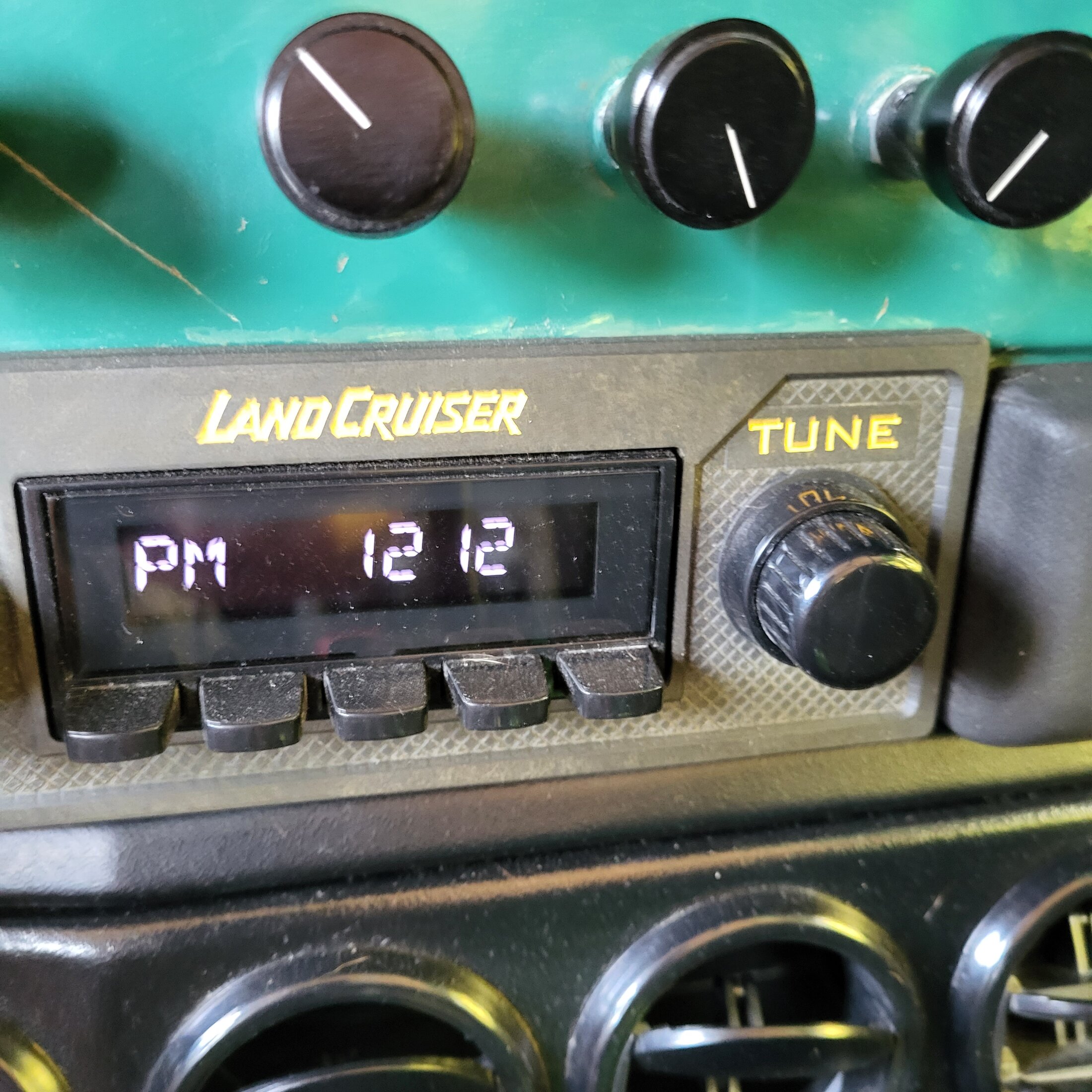

This is what i did and it works great for less than $200
Cool concept… I have an AM radio currently in that dash. I have not listened to am radio since they killed WCBS 880AM newsradio 88. That creates another option for connection to modern electronics…I’m thinking most of us are overloaded with.
are speakers wired to the Bluetooth device so you only connect the “player”…phone or some wireless source?
Yes, the bluetooth player/amp is built into the 3D printed radio delete panel thingy. You hard wire the bluetooth player to the RADIO fuse, and the speakers are wired to the player. Works great!
