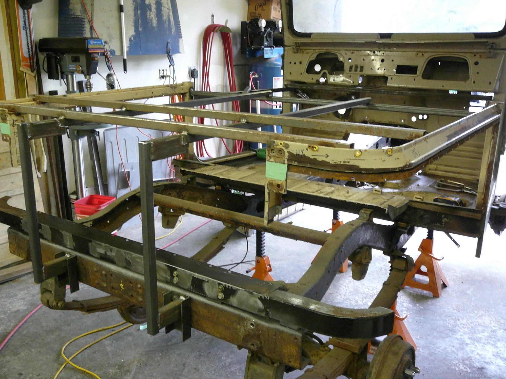

To be honest, there is a fellow in France making full tubs for FJ40's. Expensive - yeah. But I built mine
and with all the time and delays and finally buying from CCOT and making of outer quarters..
It would have probably cost the same. And been done years earlier.
But CCOT parts are really perfect fitting. I always recommend them.

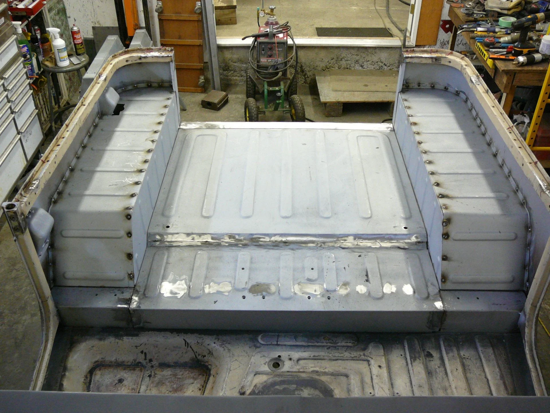

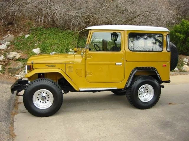

Like this
To this, CCOT parts except for the homemade outer skins.
