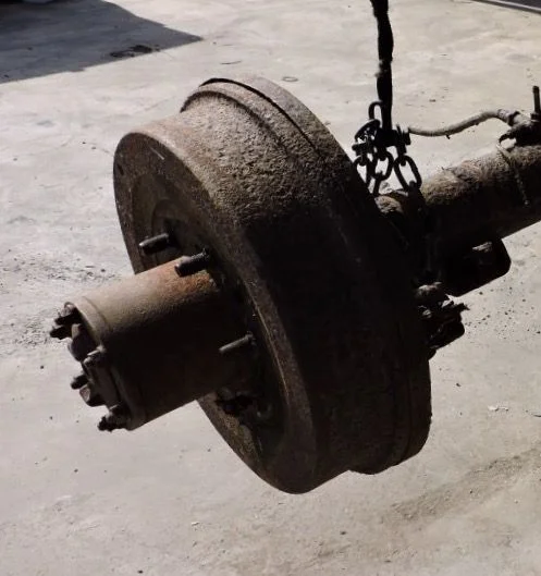

Wanted Fj40 Rear Full floater drums
I need the drums for the drum brakes
So you have yourself a 08/80 and later full float rear axle.
They share brake parts with the semi-float, USA stuff.
So any rear brake drum from a 08/80 and later 40/60 series will work for you.
Go to your auto parts drones and tell them you need a pair of brake drums for a 1984 FJ-60.
:beer:
:beer:
Thanks for the info
OEM is still available for everything if you want to stay Toyota. I just rebuild one with all OEM parts.
