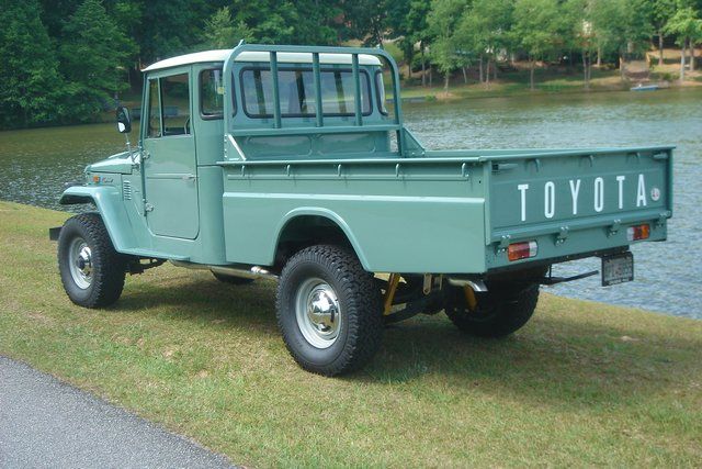

Spring green/mint green from the early 40 series would look great.

It is pretty easy to get at things like that... the glove box hole is right at chest height... and that color green was one of my choices....
I'm thinking a satin version of that stock mint green....

I'm thinking more green than blue... but I do like the "aged" aesthetic...
