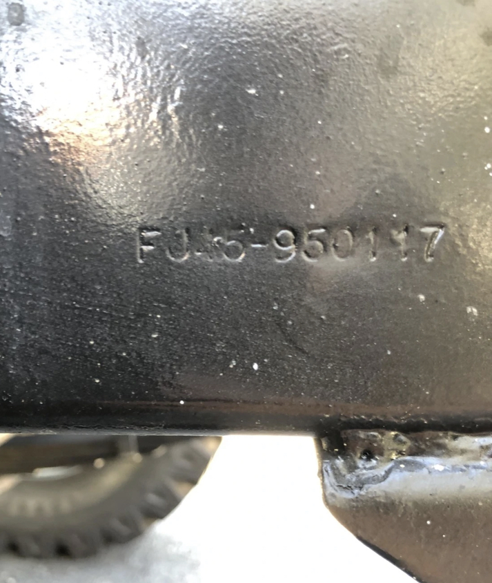

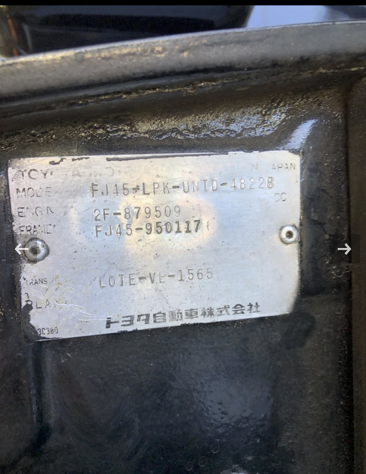

It's not clear to me when export frames were numbered. I do know a couple things. We have a very late 1985-build FJ40 that was assembled in Venezuela. It is a one-owner vehicle and we have the original sales papers. The VIN stamp font is totally different than the typical font seen on Japanese frames.

Excellent example of what came from the Venezuela assembly plant as Dan shared. That frame number doesn't appear on any of the published assembly line sequences for an FJ45. So I imagine that that frame was either made in Japan and sent un-stamped, or created in Venezuela or somewhere else. "VIN" plates are easily reproduced and stamped, frames another matter.
Seen have been Spanish VIN plates going back to the 1950s, Japanese worded plates, perhaps others for Europe, but frames not certain about. Certainly the font you illustrated is different in style and size. Likely that frame was NOT a replacement frame, but part of a production sequence done in Venezuela.

That one btw is a 1986 fj45 from Venezuela
Those crazy Venezuelans @Exiled :)
From what I can see production on 4x ended in September 1985 and that may have been Venezuela exclusively. Ours says 1986 on the paper work and it was sold new in march of 1986, in Venezuela . It too has a leading 9 in the frame sequence. That is probably the assigned range for CKD 4x in that market.
