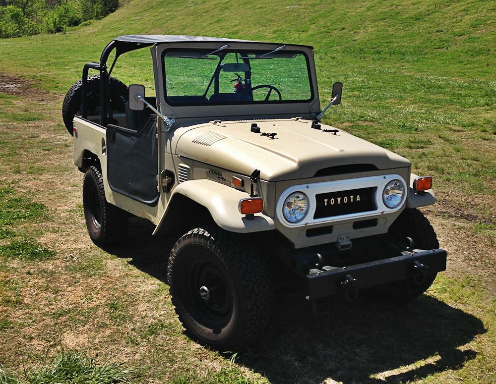

hello! I recently bought an FJ40. I have always believed that the headlight bezel should be 'thick side up'. When I bought it, the thick side of the bezel was down. So I flipped it. Here is a picture of it now. I thought I fixed it, but now the Toyota emblem doesn't look centered. Is the front bezel correct now? Should the Toyota emblem be centered? Thanks in advance!
almost looks like there is too much bib showing above the bezel and below the hood

Unless the roll bar has been removed this is a 73 which still had the metal emblem. Something doesn't seem right. Maybe a later bezel or expanded metal grill?

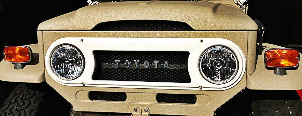

The grill sticks up farther than the body of my truck (about an inch or two). Is it not supposed to? Here is a picture.
That is correct it protects the upper part of the radiator should projectiles make it through the opening created by the hood.
So then, do you know if I have the wrong emblem?
I don't think so the 73 and earlier used the metal emblem I'm pretty certain.
My 74 has the plastic emblem and is slightly off center.
Various snips of 73's found on google. Looks like the mounting bar should center on the head lights and the way the emblem is designed will cause it to be off center towards the top.
