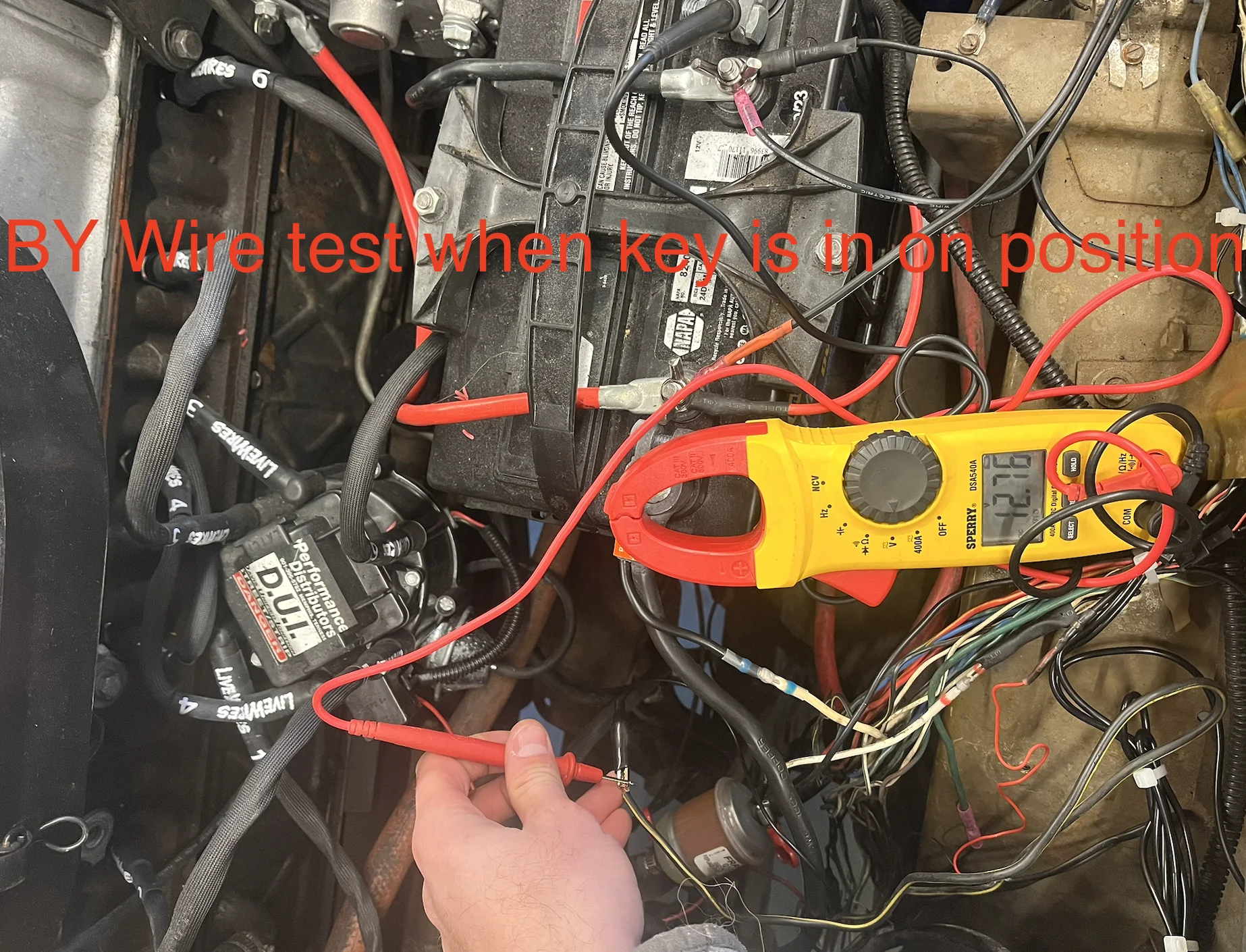

The fat BY wire is the resistor on 78s. To test if this is the problem, hot wire the distributor directly to the battery and if it runs, then run a new wire from the key to the distributor. 12.8 V at the distributor doesn’t mean anything if it isn’t running because it is an open circuit.

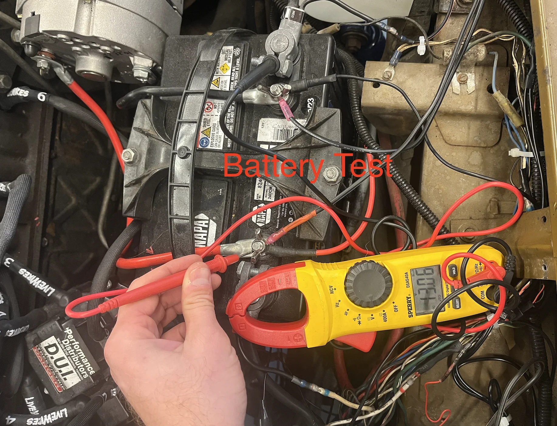

so I have been running a DUI for a few months on my 78 fj40 2f. Last night it suddenly died on me. I connected the ignition wire from the distributor direct to the battery and it started right up. Got it back to the shop. When I try to start the engine with the ignition wire from the DUI connected to the BY wire it will not start. When I connect to the battery it starts right away.
Voltage when tested not trying to turn the engine over on the BY wire
photos
