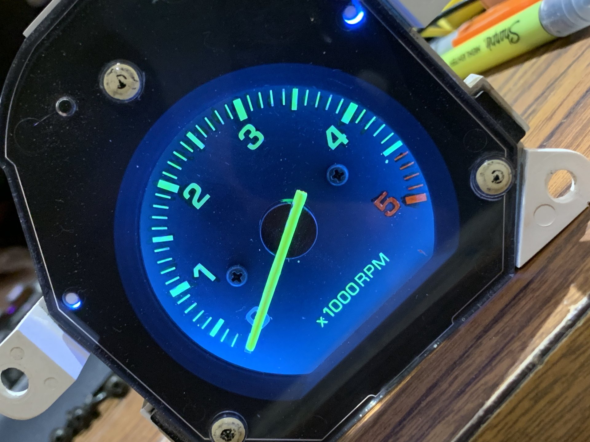

the FAA and USCG did a joint study on LED color spectrum and teh human eye and how it would adjust at night in the wheel house and cock pit too
this is the result and the ONLY way i roll now personally ...
this is my FJ62 for comparison
When I have time I will pull one of my FJ40 new OEM cluster meters that has had the light shade’s Modification also proformed and illuminate it with the new FAA / USCG light blue color lumen tone
I wear prescription glasses and I can’t tell you what a difference it makes over cool white or any shade of white or any other LED color for that matter
In addition this lumen color LED makes white paper such as a trail map or other thing like oarnge or yellow gauge needles POP out in a really killer kool way
Here Rocket Science truly exists …

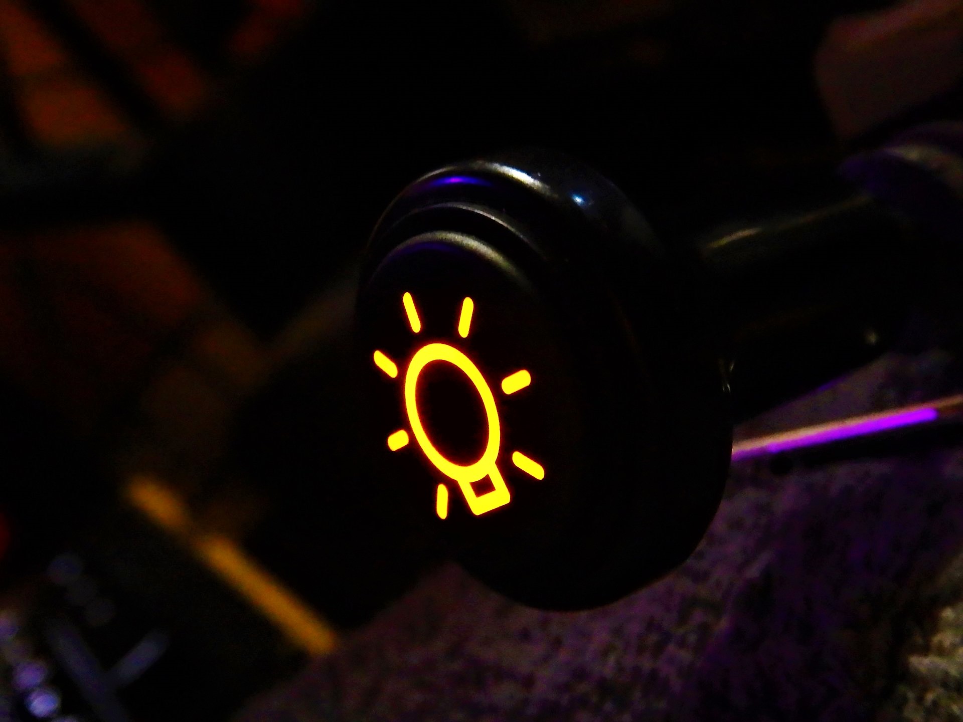

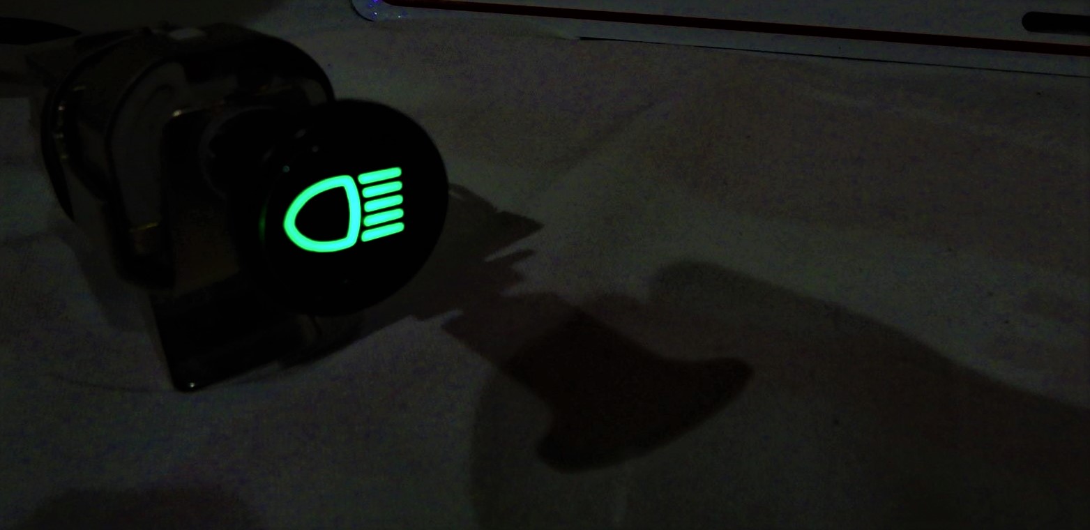

i have updated and upgraded BOTH the Padded Dash Switch Panel LED Bulb amd the Heater Lever LED bulb too ,
Both are now in what's called the Color Temperature LUMEN Spectrum , or in other words Precisely matched with a NOS Green LENS specimen , this yields a way way warm rich uniform level playing field even GLOW
NOT a intense ones with areas of HOT-Spots and COLD-Spots ...

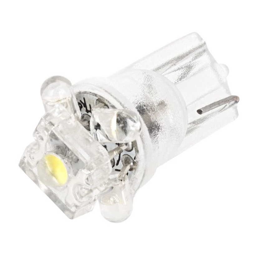

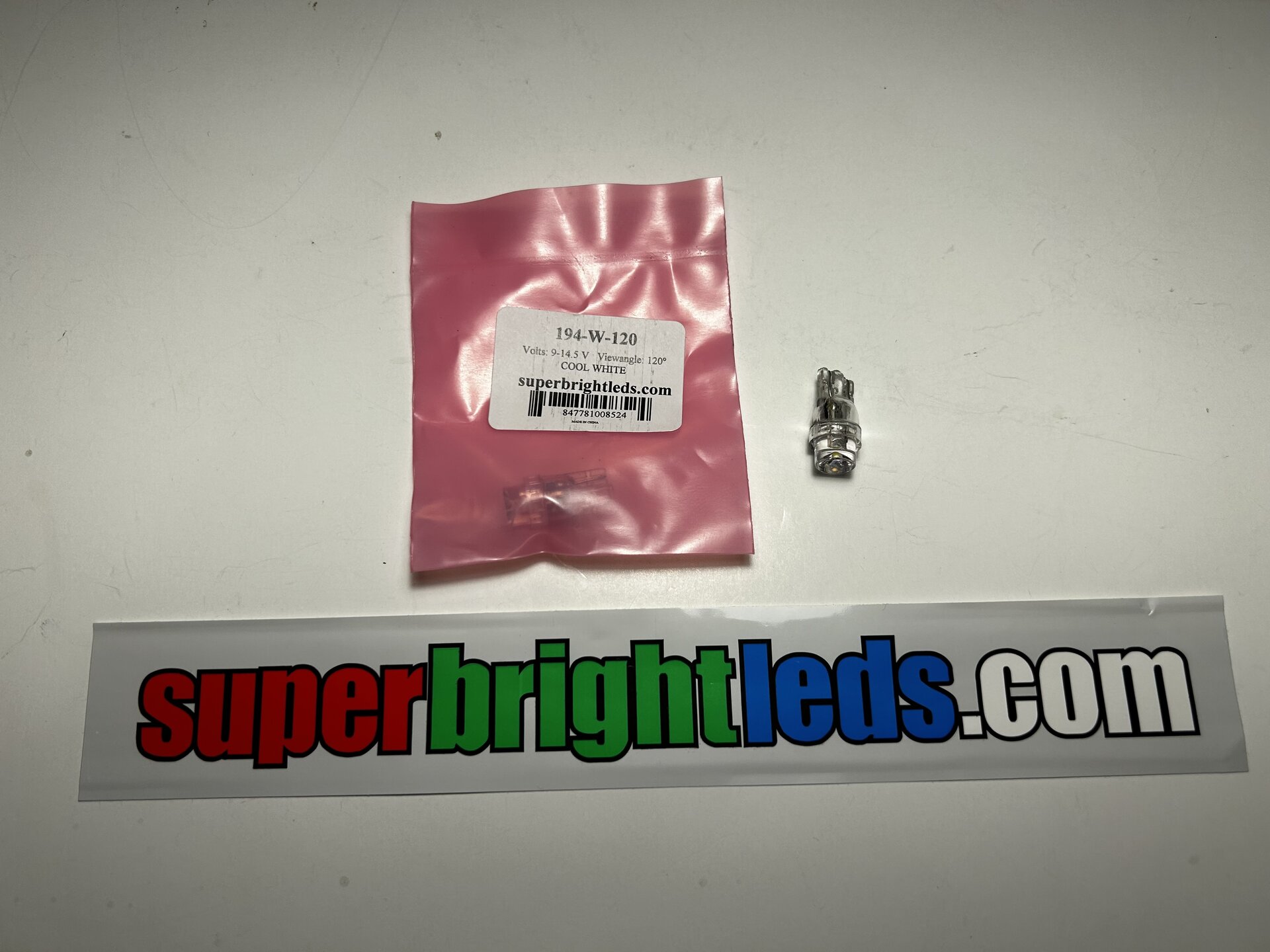

These are the bulbs I ordered from Superbrightleds.com.
They are all the right sizes for my 1973 FJ40, although I can't comment on if I got the brightness right, as I haven't tested them yet (truck is in pieces). Going down the list, this is where I will install them.
Blue one: High beam indicator
2 Green ones: turn signal indicator
2 Warm white: instrument panel housing lights
The three Festoon Base bulbs of varying brightnesses are for under the dash and the dome light, I got an extra so I can experiment with the brightnesses a bit.
The red one is for the parking brake indicator light.
The cool white is for the light in the headlight switch.
Again, these are the right sizes for me, but I'm not sure if they're the right brightness yet. But it's a good starting point.
