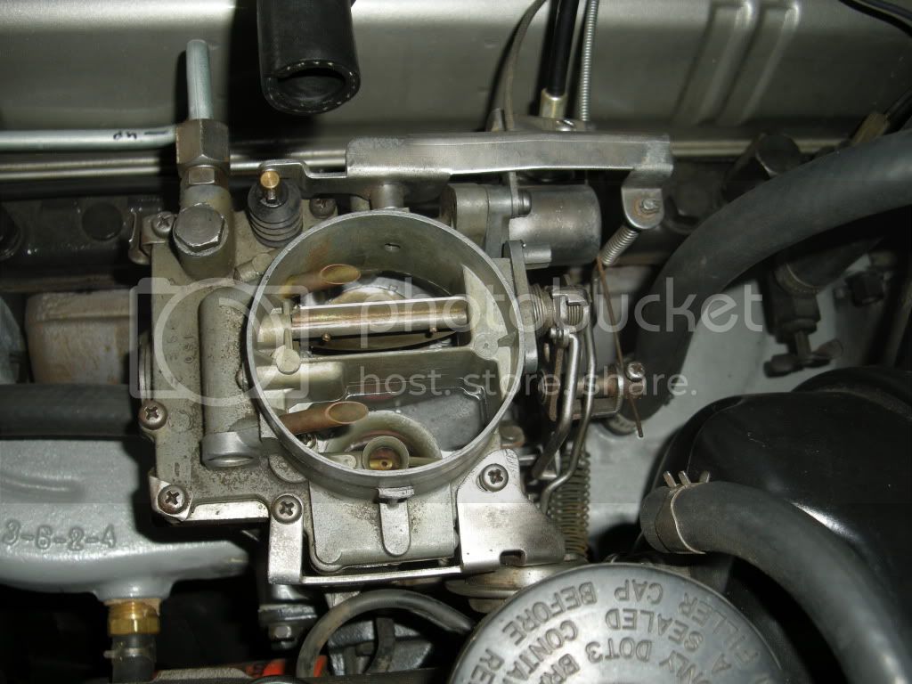

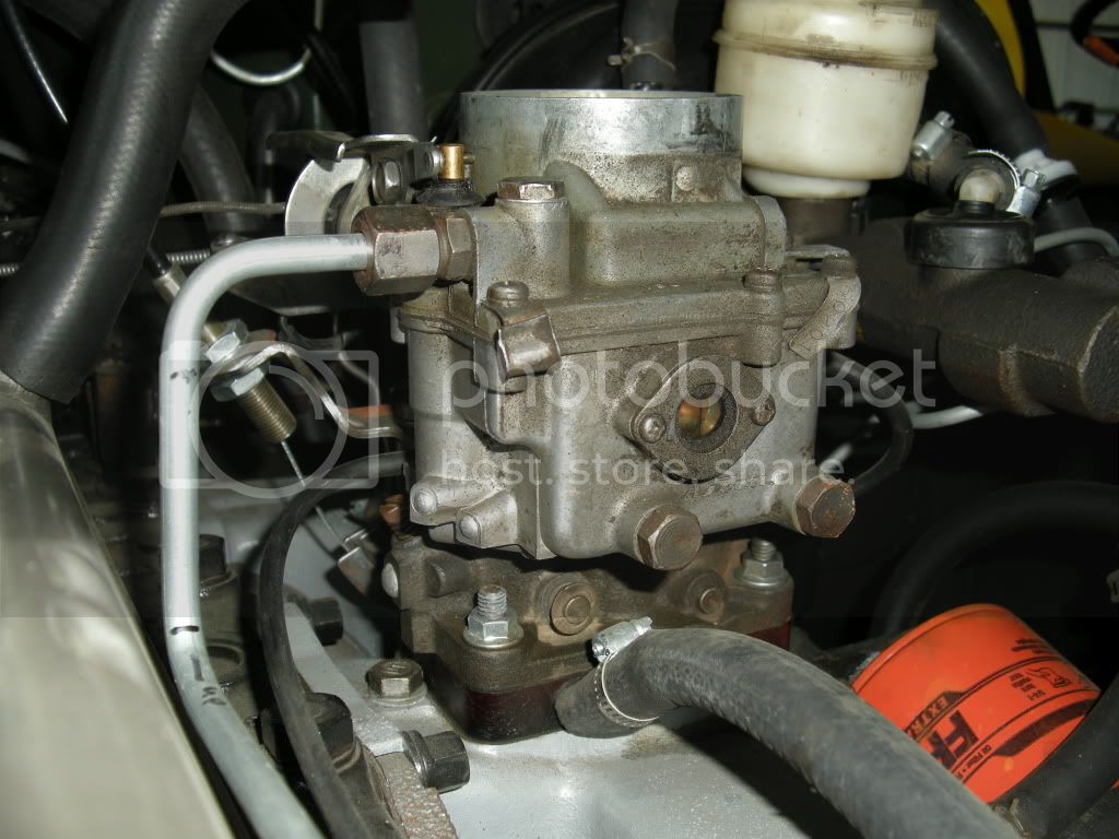

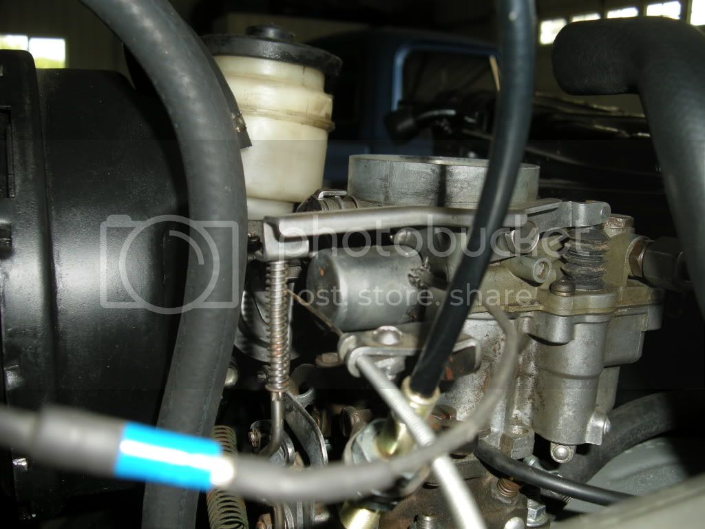

I am having a challenging issue with my 70 FJ40. This is a rebuilt carb. It is running rich at idle, and I can't get it adjusted out. When I disconnect the idle solenoid, the engine will die if i do not hit the throttle. The idle mixture screw has no effect.
so it is too rich with the idle circuit open, but must be too lean if it is disconnected.
HELP!--here is the carb
http://www.sor.com/shared/image/042B2.gif

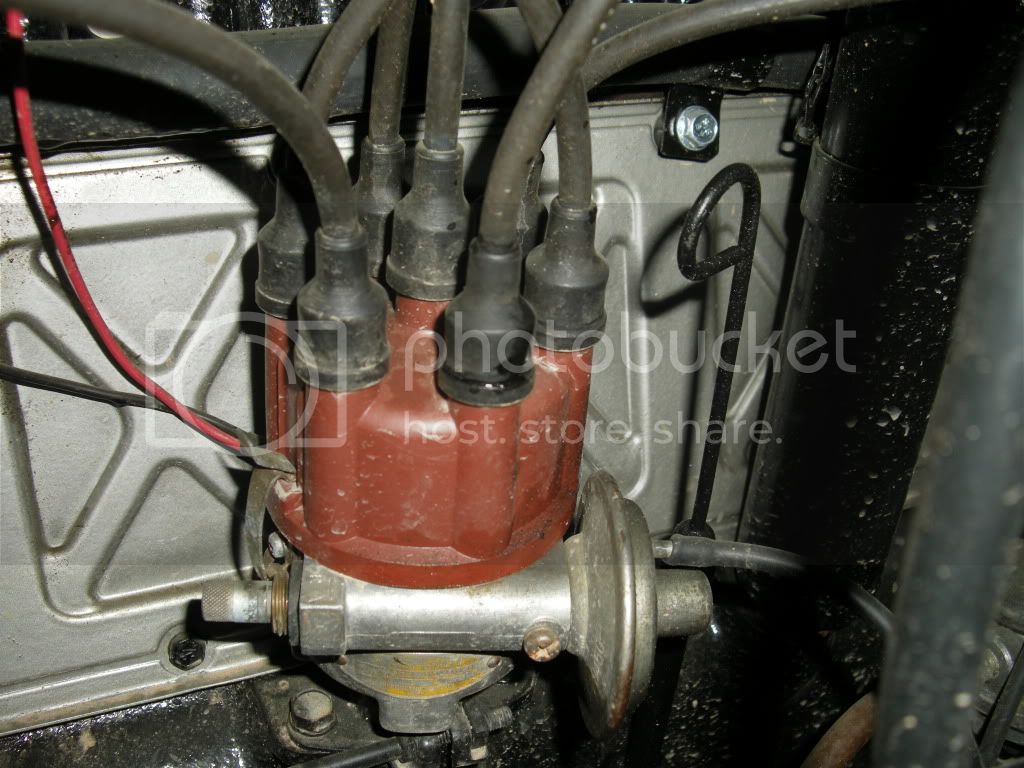

Here are pics. The timing was set above factory, but I can't recall--but I thing it was 9-10. I also included a pic of the dizzy I got from Marks.
It runs great down the road, but backfires a little bit out the exhaust when you let off and coast in gear. Not really backfire, but noticable puff sounds.
Trollhole asked for pics.

Hey sorry for not posting sooner. It looks as though you have everything installed correctly. That is always a concern.
As stated above. What's your vac reading?
Does it bounce much?
It sounds like the idle solenoid is working considering the motor dies with it disconnected.
Also I'm not exactly certain but your port for vac advance isn't right. I'm not familiar with that year carb. I thought all vac advance ports were on the cast iron base. Mark or Jim would know this answer.

I'll get some vac readings tonight if I can get it to idle at all. The only vac port on the cast iron base is on the drivers side, and it is hooked up to the vac module on the choke linkage. You can see it in the third pic under the master cylinder cap

I will check the timing and advance tomorrow. I believe the factory mark is 7. Should that be what I time it at? What should the advance be, and at what RPM's. Sorry, I dont have a FSM yet.
