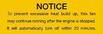

Where that yellow notice sticker goes on?
Would like to get one.
Thanks,
Here's mine.
In all fairness our signatures don't show on most mobile devices so fair question. My is a 1978 but that is a reproduction sticker so may not be true to year.
