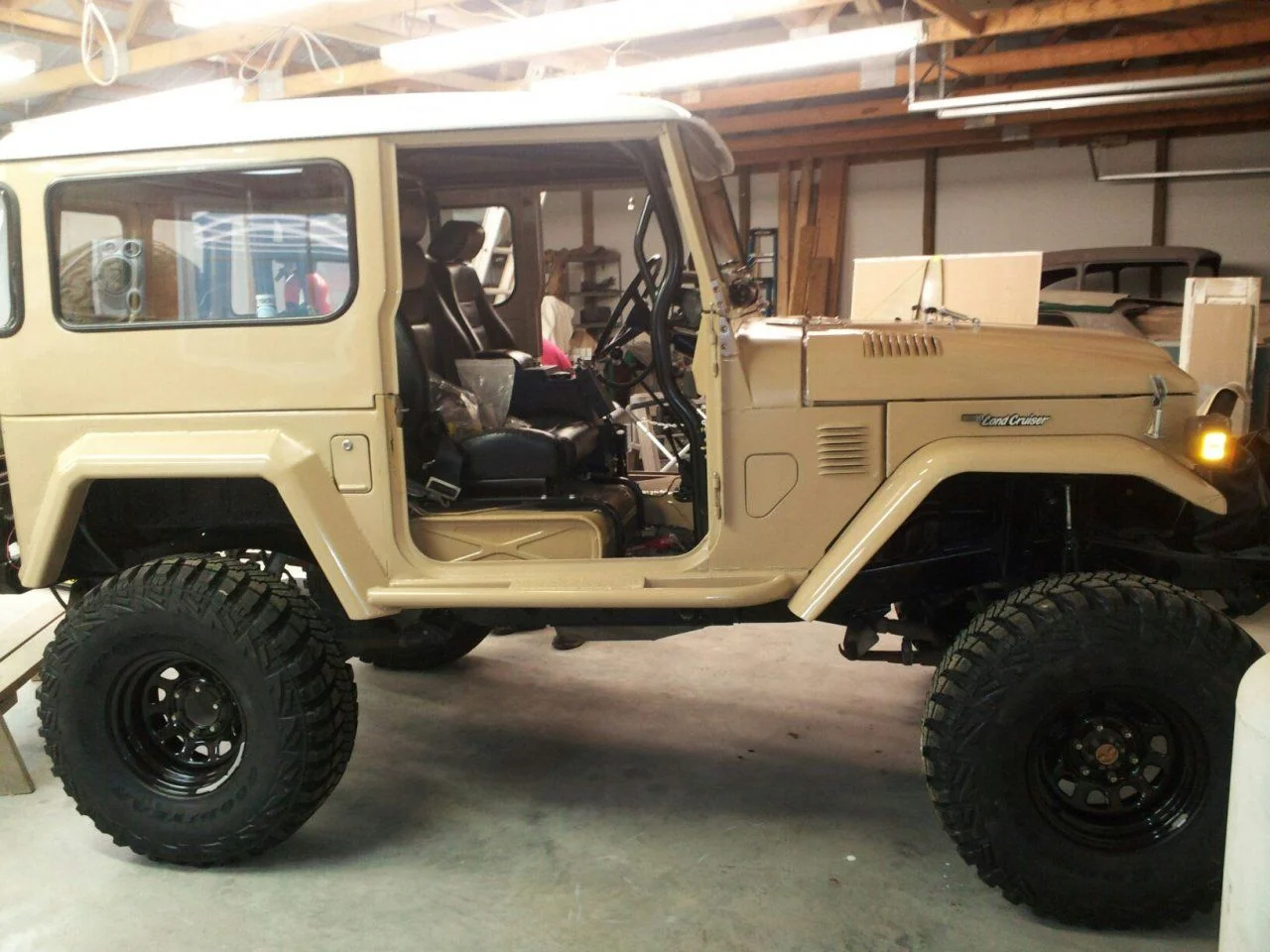

I love the Procar seats in my 40 they're the ones that Ironpig sells. Spent many a long day in the drivers seat including five days at Moab two weeks ago. They fit me well, offer good support and seem to be pretty tough. No signs of wear on them after seven seasons of use. Might not fit you right but I love them. You're more than welcome to give them a try at coal mine in July!
