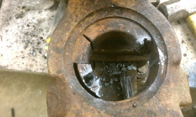

Last night I removed the knuckles on the D60 and found the kingpin bearings to be covered in a brown mustard grease, I cut the front D60 axle tube down, started to cut the tube out of the C and found that my Rip-saw needs new blades.
Here is a question that is hard to answer because you can't see the internals, but will post pics on that tomorrow, anyway here goes, when rebuilding the kingpin what can I reuse and what absolutely needs to be replace? Example, the kingpin looks good and is a pita to get out so can I reuse it? I want it done right, but if I can reuse something I would like to save a few $$, but with that said I don't want to go back in there for something I skimped over and have it cost me more. I'm on a tight budget here, so it might be ready in May or July or September, all depends on what will get replaced. Little things add up to a lot. Please chime in.
Here are some pics from yesterdays work.

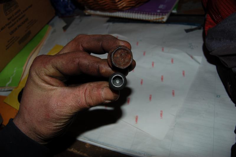

hub flange bolts
I played with the lathe tonight and turned down the shoulders of a 1/2" button headed allen bolt to see if it would work with the turned down 14 bolt hubs. I'm pretty certain it will. I will check on prices for these bolts at the supplier I use for my hinges. Their prices are way lower than the hardware store!
Looks nice, how strong is the outer wall?
