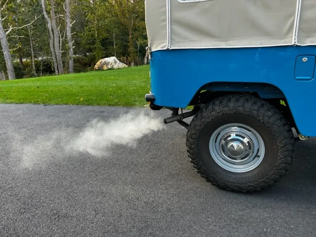

The reason for video was two fold: First, I wanted to see if any coolant was entering cylinder after shut down as white smoke was coming out exhaust when engine first starts (did not smell sweet like coolant).. Second, I bought the camera probe for $19 and had to test it.
