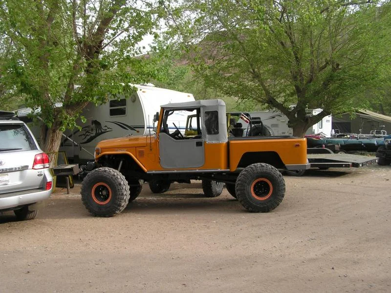

Here is some pics of the finished rig, and a couple random shots at Cruise Moab.
https://forum.ih8mud.com/attachment.php?attachmentid=327358&stc=1&d=1243429320
https://forum.ih8mud.com/attachment.php?attachmentid=327356&stc=1&d=1243429320
https://forum.ih8mud.com/attachment.php?attachmentid=327357&stc=1&d=1243429320
awesome, been waiting for those pix
is that a shortened tiger top? or custom?
looks perfect
We made the bows and had a local guy fab the top from scratch.
Mike that rig looks sweet. Way different than at Rubithon last year. Keep the pics coming.
We should have gotten pics of our rigs side by side.
And then sent the picture to Toyota. :hhmm:
That would have been cool. As far as sending pics to Toyota, I don't think they have their finger on the pulse of what Landcruiser enthusiasts really want, At least not here in the states. All we get is the FJ Cruiser :bang:
