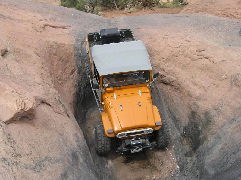

I have a question about the soft top and the half doors. I was wondering if you have something fancy for door uppers or windows?
Thanks,
awp
Right now i have full soft doors and soft 1/2 doors. I am going to make some hard lower doors with soft removable uppers.

Nice truck. Did you have the top custom made? Who made it?
I had a local upholsterer make it to my specs. Are you the guy that gave Don @ Wolf Creek Rod Works some t-shirts ? The guy that made my top does the upholstery for Don's custom builds.

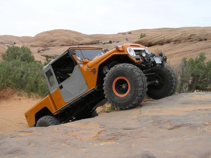

I never did get a chance to look at it really close during Cruise Moab, how did it do on the trails? Did you like the wheelbase?

I really did'nt notice the xtra wheelbase from 105 to 114. It felt the same as it did before, and it wheels like a banshee.
I set up the 1/4 elliptical leaf packs too soft initially, and had to rebuild them and relocate the mount @ the frame after CM'09. Now i can haul 4-500 lbs in the bed and it only sags about 1", and got rid of the body roll which is sweet.
