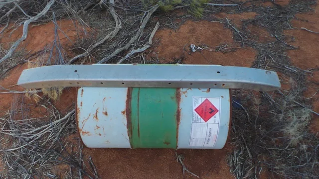

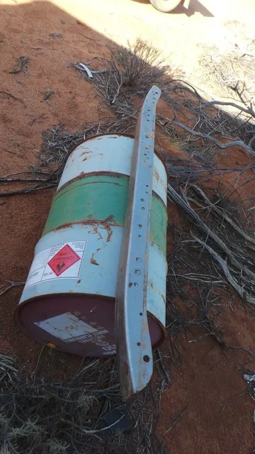

25 (the early bumper discussed) are different at the ends too. way to tell at a glance. i have a new silver 45 bumper in the family heirlooms (woulda been pulled new to fit a roobar). interested now when it dates from. possibly 65; they bought a new 45 then. will find my camera one these days.
here that newish bumper i mentioned. can anyone roughly date this? has lots of holes;may be newer than i thought (maybe even early 80s hj47)?
