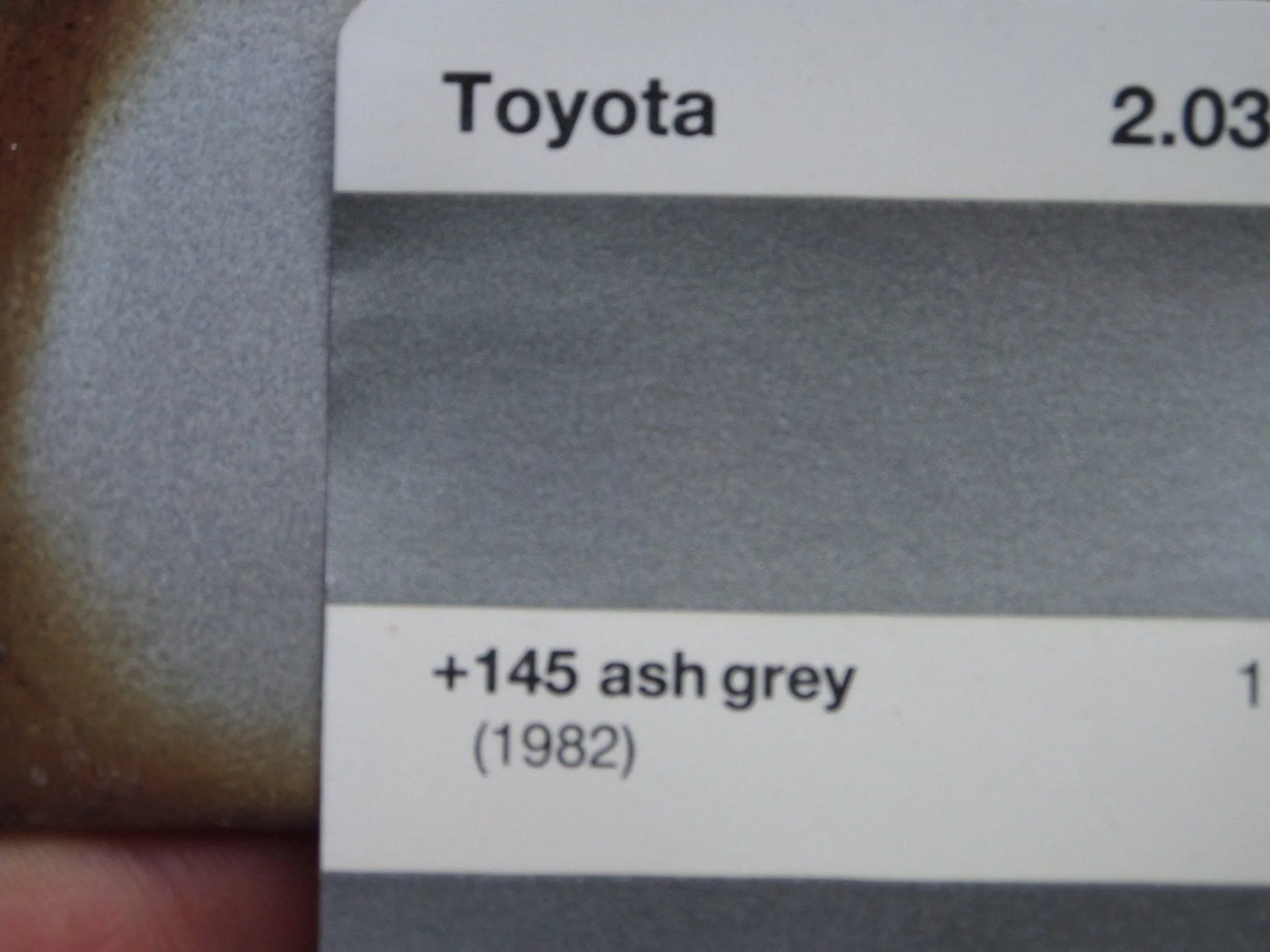

I cannot help with FJ25 but for those looking for colors of later bumpers, I just uploaded a bunch of paint chips in one of my albums. I took My 1977 FJ55 rear bumper apart and found some paint that had not seen light since Sept 1976. Paint code T1434 does not seem to exist anymore, I found T122 to be the closest choice. Most people use T145 but that appears to be a little too dark.
