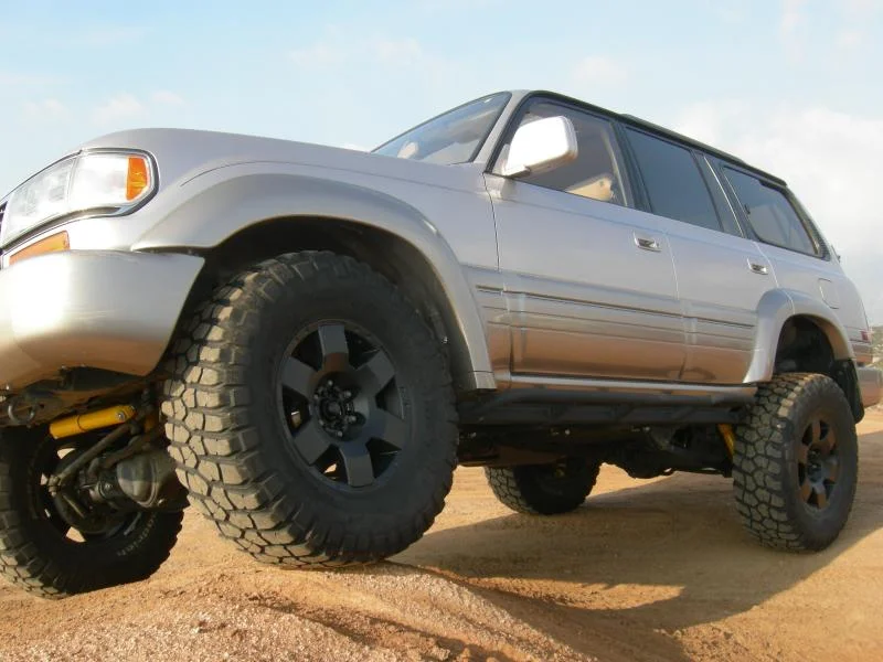

There are many styles out there and posted on this forum. I have the late version and I painted them black. I also used 1 1/2" spacers to flush out with the flares.

The wheels just tuck inside the wheel well and I have minor rubbing on full flex. I think if I could change spacers, I would go with 1 1/4" but I am not too concerned about it. In the picture below, I have pretty good stuff on the front and I did not rub.

Thanks! They do get a lot of rock rash due to the flush spoke design and I have to touch them up after every wheelin' trip, so don't powdercoat them, rattle can for sure.
HIJACK ON
What tires are those, never seen em before.
HIJACK OFF.
They are the new Goodyear MTR I believe.
