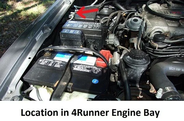

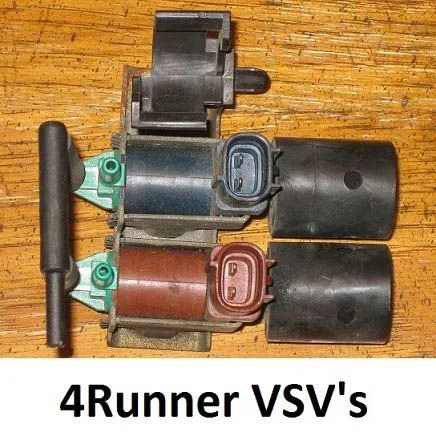

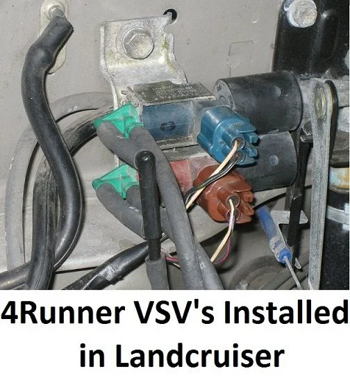

Cheap Fix From 1990-1995 4Runner 4x4
I vaguely recalled that my 1990 4Runner had similar looking VSV’s that controlled the Automatic Differential Disconnect (ADD). A trip to the local U-Pullit confirmed this. At least the electrical connectors were identical. The only difference of the 4Runner VSV’s is the vacuum port is 90 degrees different than the Landcruiser. Purchased the set for $5 and swapped them into the Landcruiser bracket. Low and behold they worked perfectly!! All 1990-1995 4Runners that are 4x4 should have this set of VSV's.
View attachment 358269View attachment 358272View attachment 358273
hello i read it with interesse; it look likes a good option; question is 4runner also24v? because mine hj60 has a 24v system robertcruiser
