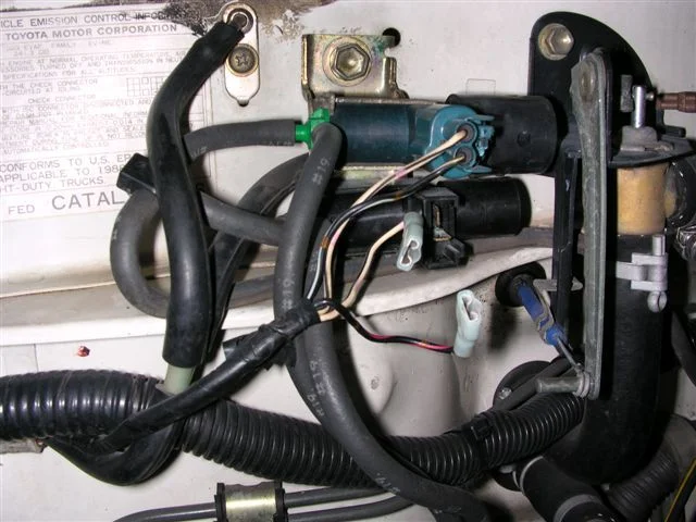

Ordered the parts up today. Overhanger- do you have a pic of the final product? Maybe I could take a few pics for the FAQ section???
I'll take one or two this afternoon and post them up. It's so easy to do the install it hurts.

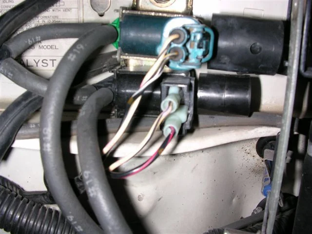

Pics
Here ya go. I don't understand why some have a problem with "messing with the wiring harness" when all you have to do is crimp on two new spade lugs. For around $20, to have a Toyota part doing what it is designed to do is worth it. Mac valves? Who needs them is my thinking.
