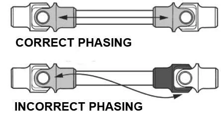

Since the tires are new the tires are probably ruled out so first check driveshafts . Bad u-joint or joints, Out of phase driveshaft. Since it did this from day one with you,is it lifted? Does it have excessively long shackles at one end or the other?

Driveshafts can vibrate from bad ujoints, balance issues, improper angles or bent
