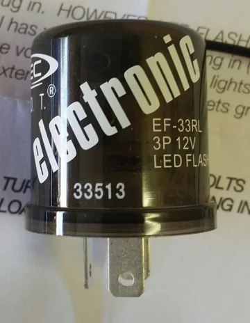

I got the relay with the kit- its a 2 prong relay. My FJ62 needs a three prong relay. So, the one they sent me doesn't work for my rig. This may be different for the FJ60 versus the FJ62's. Dunno. Maybe someone here knows better.
I'll be contacting the Digit-tails guys today and ask what options are available. I'll post as soon as I know more.
Ok, so I got this from Digi-tails, but did not like it and did not wanted to add any of it to my rig.
I instead turned to MUD and found this.
here
Easy peasy..
It worked..!!
My rear signals flash like they supposed to, and nothing was added to the equation.
Now (by removing that resistor) my rig is 0.1g lighter...:flipoff2:
:beer::beer:
