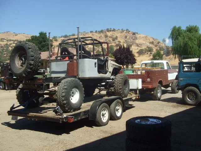

All the parts are in so it is on it's way to get the 4:88's, Detroit in the read and an ARB up front.
Installed my Holley350 and throttle cable setup back on it.
I will eventually find all the right parts for the other carburetor but I need to move this around to different locations. Exhaust shop, Gear Shop, etc. It was begcoming a pain using one link to move different vehicles.
I also installed a new fuel pump.
