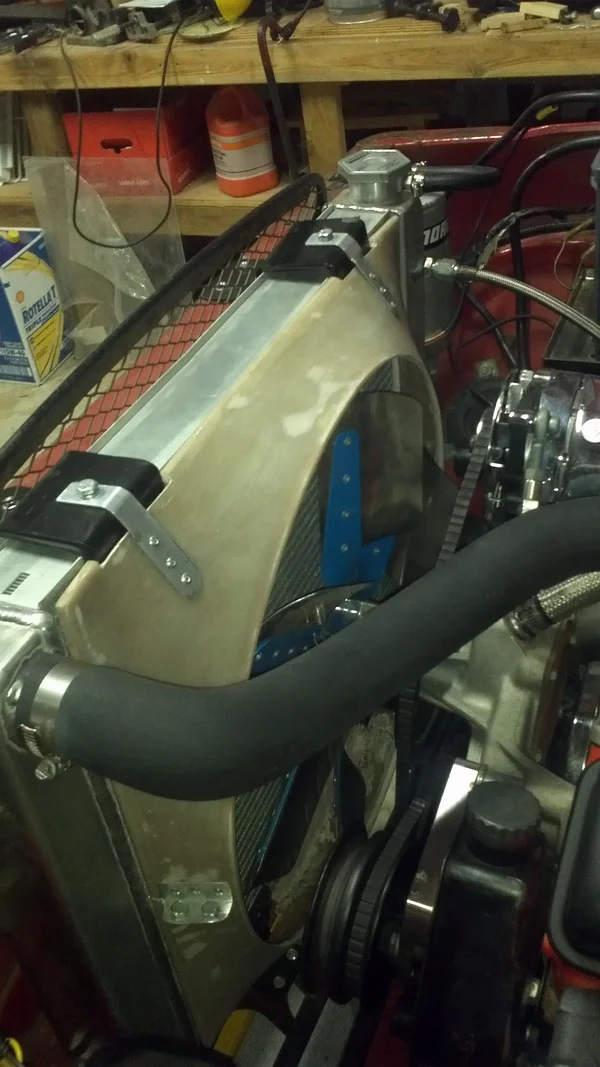

Mine runs mid 180's to mid 190's, occasionally may get to 102 - 105 (on hot uphill drives). Made my own fiberglass fan shroud and just using standard flex fan. This is before I painted it.
I'm using the same fan. What did you use to shape your shroud? Looks very pro.
I did it about 15 years ago, from what I remember, I cut a rectangular piece of 1/4" plywood (same dimensions as face of radiator) held it in place to inside face of radiator, cut a round piece of 1/4" plywood (I believe I cut it 1" larger in dia than fan blade so to have 1/2" clearance from edges of blade) and attached (taped) to front of fan blades, cut a length of 2 x 4 to fit between center of ply on radiator and center of round fan piece of ply, traced with marker the two ends of 2 x 4 so to get both angle (motor sits with a 5 deg slope back) and distance.
I then removed the plywood pieces, cut another 2 x 4 an inch or so longer (so that the round piece of ply would line up to center width of fan blades, screwed together to make a skeleton, wrapped an XXL T-Shirt around face of round fan ply and pulled very tight to around back of radiator ply and stappled it. I the applied a couple thin coats of resin to the T-Shirt to make it stiff, then started to apply several strips of fiberglass and resin to make it solid. I then cut away the plywood (leaving just the edge that the fiberglass shroud was glued to), Sanded and painted.
After cured, cut in half so to install, riveted some small aluminum angles an both halves to attach together (made for simple installation), and made a couple of top straps and a bottom strap that were again riveted to fiberglass shroud.
Hope this makes sence.

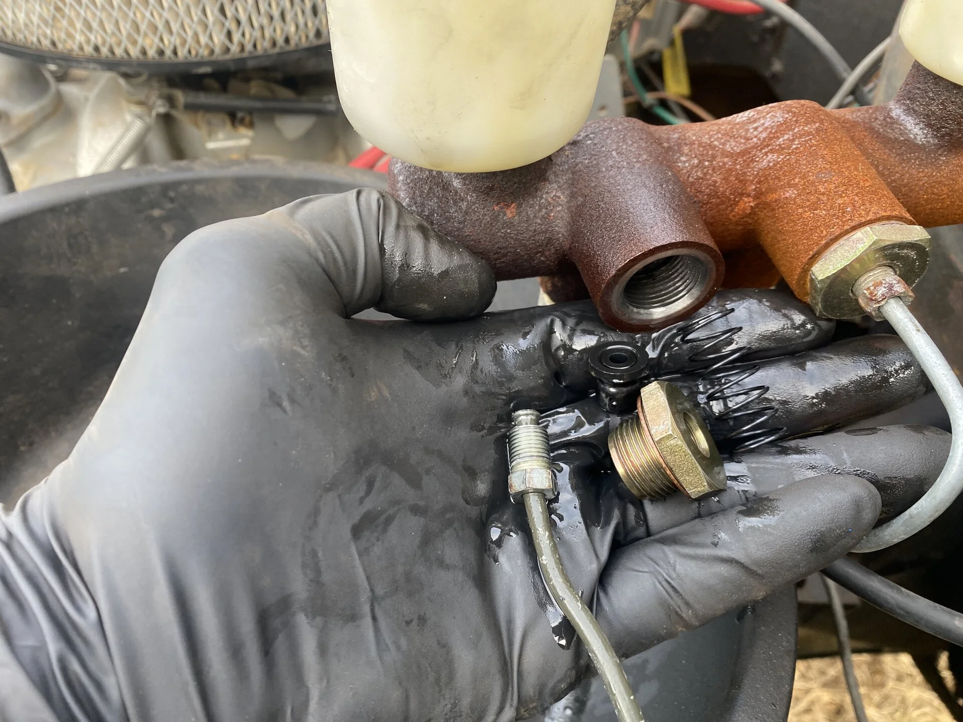

If you added front disc and kept the '72 master and didn't pull the front residual valve that is why the disc stayed against the rotor. Drum residual valve is 10 psi and disc only needs 2 psi or none at all.
Residual valve deleted. Huge difference. No disc drag in my five mile round trip for coffee today. I think my overheating issues are solved. Thanks again!
Did those big fittings come right off, I have tried 3 times over 20 years and never had any luck getting those to move at all.
Yep, though I had to use an impact on the bigger one. I soaked some PB Blaster on it first for a little while.

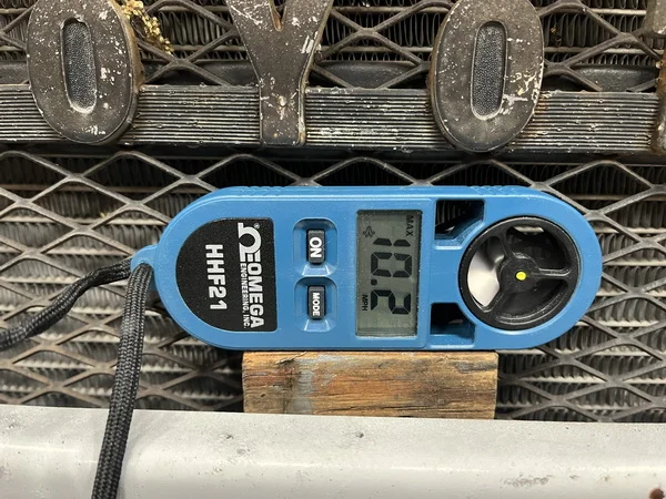

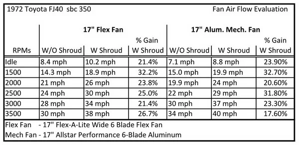

As I have mentioned in a previous post, I did not have room for a fan clutch. I ended up using a 17" flex fan with homemade shroud. Since many have commented on the use of flex fans and what damage they can cause, I just switched to a solid 17" mechanical fan. Before switching, I wanted to somehow check the air flow through the radiator with the flex then compared to the new mechanical fan so I did the following. Note this is not really scientific but gave me a base line to work with.
I first placed a wind speed (mph) hand held monitor near the center of the radiator, see photo below. I then took readings at various RPMs at the same location each time. I did this with the shroud on and with the shroud removed. You will see in the chart below that the shroud made a greater than 20% difference in the amount of air pulled through the radiator.
I then ran the same serries of air flow tests with the new fixed mechanical fan. The results (difference) did Suprise me that the flex fan at lower RPMs pulled more air but at higher RPMs the mechanical pulled more (this would be expected from the Flex in the flex fan.
The one difference is that the shroud was made for the flex fan having 50% of blade inboard the shroud. When I installed the mechanical fan I had to change the fan spacer from 1 1/2" to 1/2" (due to fan offset design. This put the mechanical fan having approximately 2/3 of the blade inside the shroud, 1/3 out v 50/50. Below again shows the method and results. Both fans had a clearance of approximately 1 1/8" from face of radiator.
