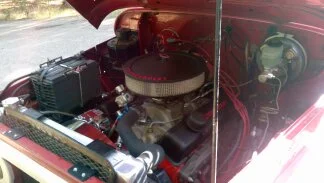

180* thermostat is recognized as most used with carbed/non-emissioned SBC engines. there is always the 165*, and with driving in San Antonio may be your ticket

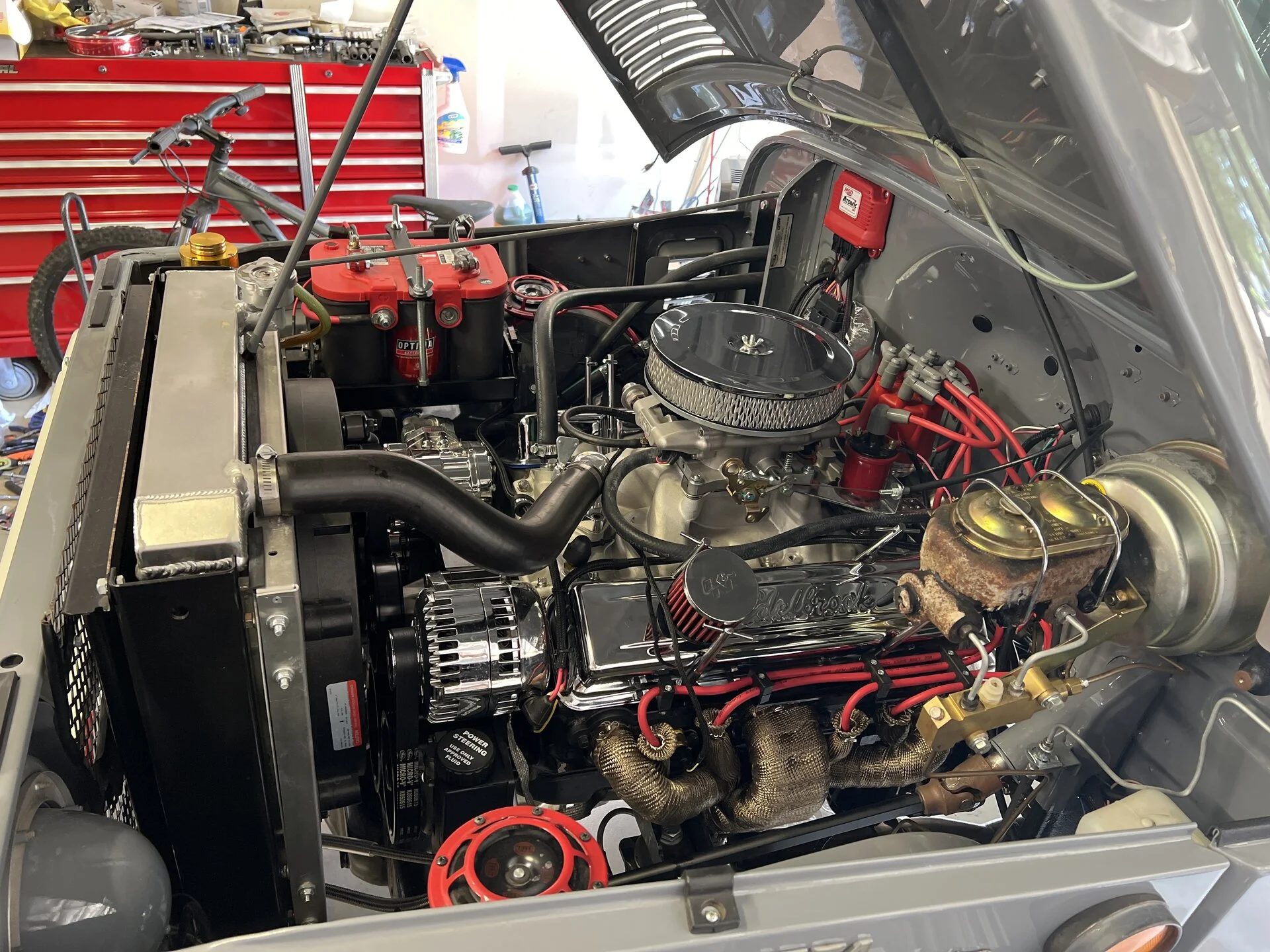

everything looks very clean, and your shroud looks like it fits nicely. just curious, they appear to be stock height valve covers but is this engine "stroked"?
the headers wrapped also look very clean, side note: if you have them started eating up gaskets per thermal expansion/contraction like mine did, my fix were Ram's Horns. they also gave the engine a quieter/deeper sound

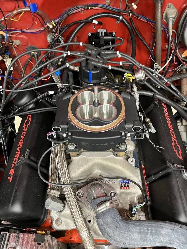

Just installed the Holley Sniper EFI and Hyperspark Ignition on my sbc 355, made a world of difference, although may not add much HP it sure unleashes the HP you have. Throttle response is unbelievable, have to take caution when pulling out of a stop sign for a turn since I can spin my 34's at half throttle. Have timing set at Idle 25 adv. Cruise 40 adv, WOT 35 adv. Any advice on timing settings would be greatly appreciated.

I drove it for the first drive today (about 100 miles) after installing EFI, the temp was at 175 cruising on flat at 60 mph, 196 on 3 -5 mile uphill grade (2000 ft alt change). I may reduce my Idle to 23 deg and cruise to 38 deg to see if it makes any difference in temp.
The motor does have a moderate cam, Comp Extreme 262H thus why I am running more advanced, plus the motor seems to like it.

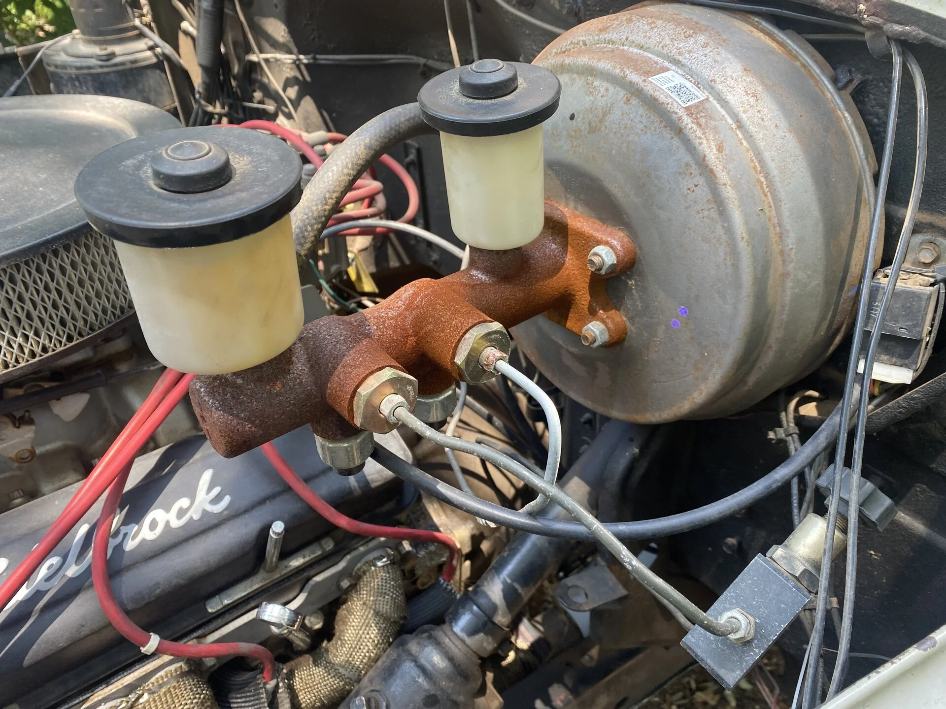

When I did the front disc conversion (about 15 years ago) I used the FJ60 Berts (Chevy Rotors and Calipers bolted right on), had the Brake Booster rebuilt and used an FJ80 Master cylinder (single reservoir) that was a direct bolt on to the booster. Never have had any issues running the discs on front with OEM drums on rear. The attached pic is not best quality, but you can see the master brake cylinder in the upper right.

The valve on the front cylinder looks like an adjustable proportioning valve. I have never seen one installed in the front circuit before. Usually they are added to limit rear wheel lockup after converting to disc brakes. Usually they are needed for both 2 wheel disc conversions and 4 wheel disc conversions. I've needed them for both my front disc conversion and my 4 wheel disc conversion.
