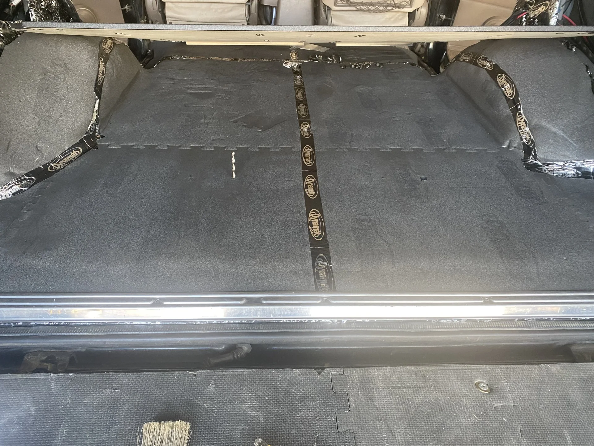

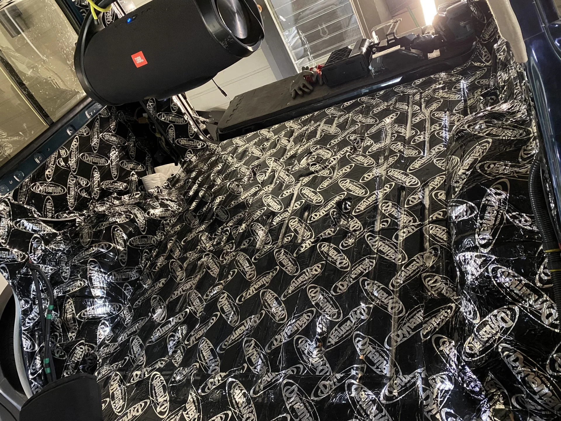

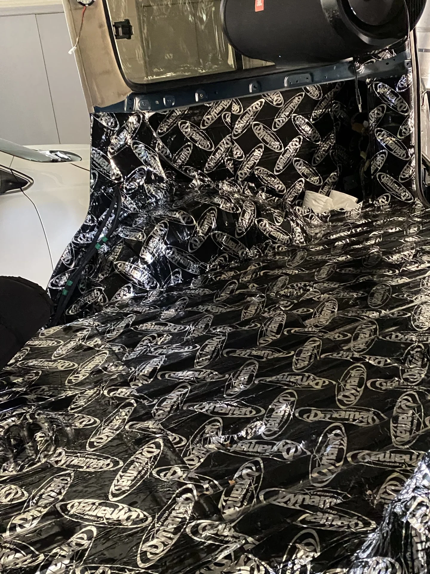

I'm finding I'm not an inside sound proof guy, I find it hard to stop covering metal LOL.... Yes, I hear you don't need to 100% cover, but it is and I did. Will have to trim some back to fit panels but may not even sure I will go OEM paneling on finished product. I will test it on some overnighters, hopefully soon and go from there after I see what works best. Found the roller Dynaliner offers works best. Had some knock offs from Amazon I returned right away.

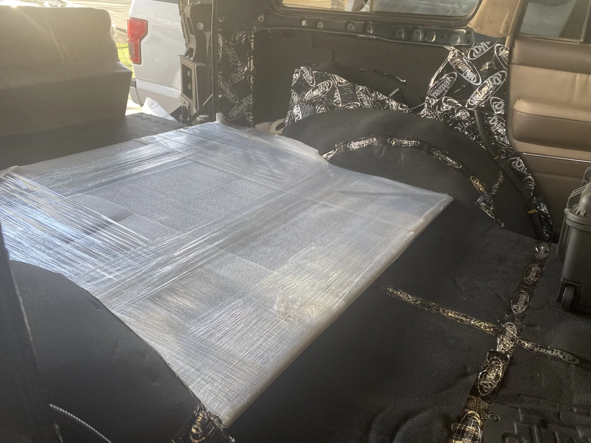

Dynamat, sticky stuff, sound now inside is amazing just from this alone. Only went to the front of the 2nd row. Still debating the outcome of the front row. No doors as of yet, will completely rebuild them then. Looking for clear glass...
Then some Dynaliner. Amazing sound proof and no carpet going back in. Some soft spongy stuff. Tape kind of sucks and is overpriced. Patterns you see are imprints from crap sitting on it for months. Also picked up the Goose drawer system (plate in pic 1)...
GOOOOOOOSE GEEEEEAAAAR. I think it took 12-14 weeks....

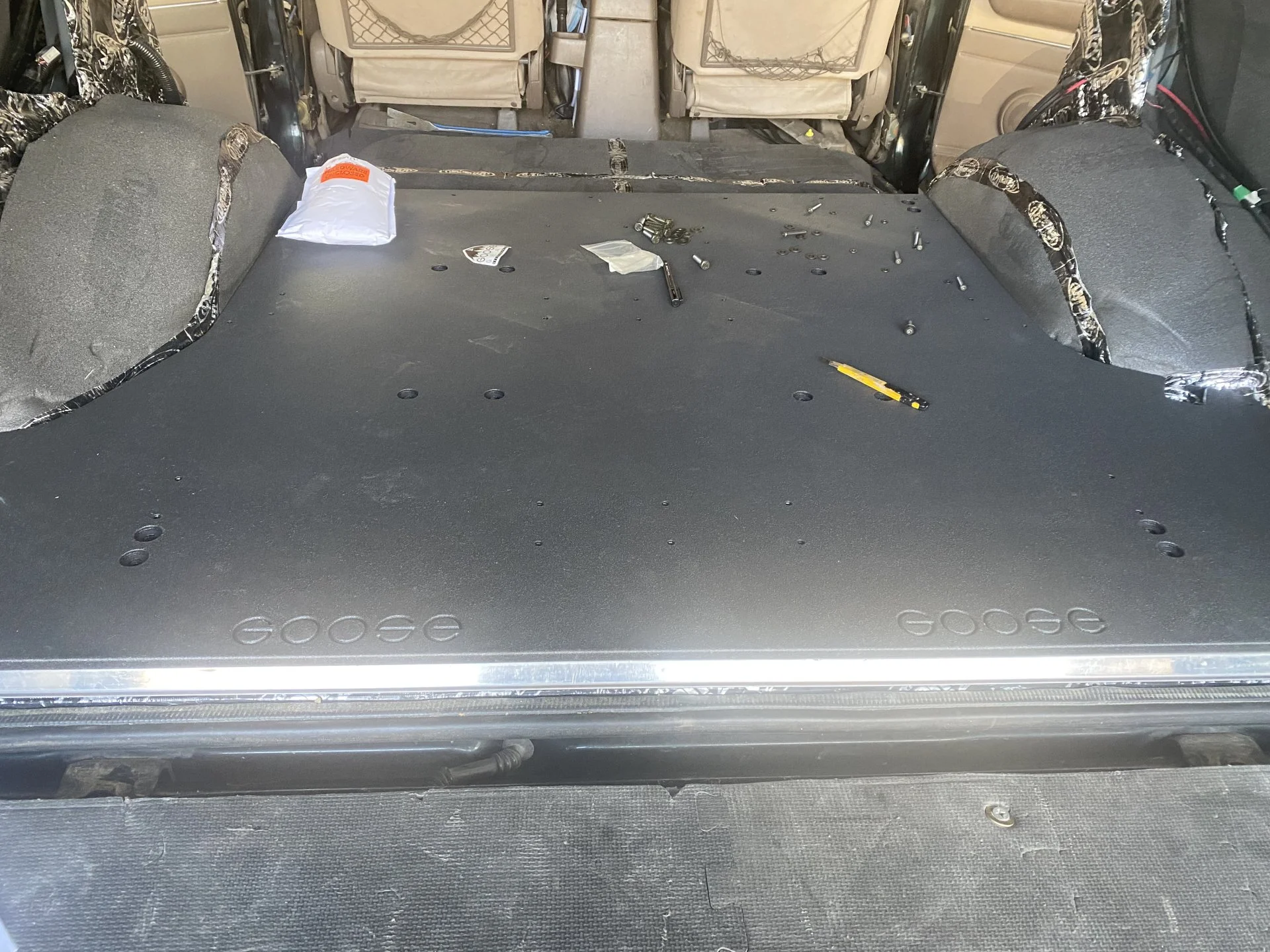

rear plate. The foam Dynaliner is pretty thick. I "think" they recommend pulling the carpet, no instructions. Their tech support guy answered right away on any calls, had great responses and even called back after he found an answer without me asking for it... Excellent customer support. More than makes up for no instructions. Sit back open it up, drink a beer or 6 and figure it out. Not too difficult, much faster with instructions tho oh well I don't read anyway.
So, with the Dyna liner, and covering every threaded mount. it was tight and I'm sure floated the plate some. Still worked well. I had to order longer bolts and the Dynamat "tar" underneath worked for excellent sealer and thread locker. Turned out not to be a bad idea. Bet in 20 years my interior around the removed seat bolts will be more rust free than yours lol. Any potential difficult treads I threaded from below. Worked wonderful. After counting the holes and bolts and looking at their website 100 times because there are NO install threads on these, I got it. 8 large bolts, 8 small bolts. plate in

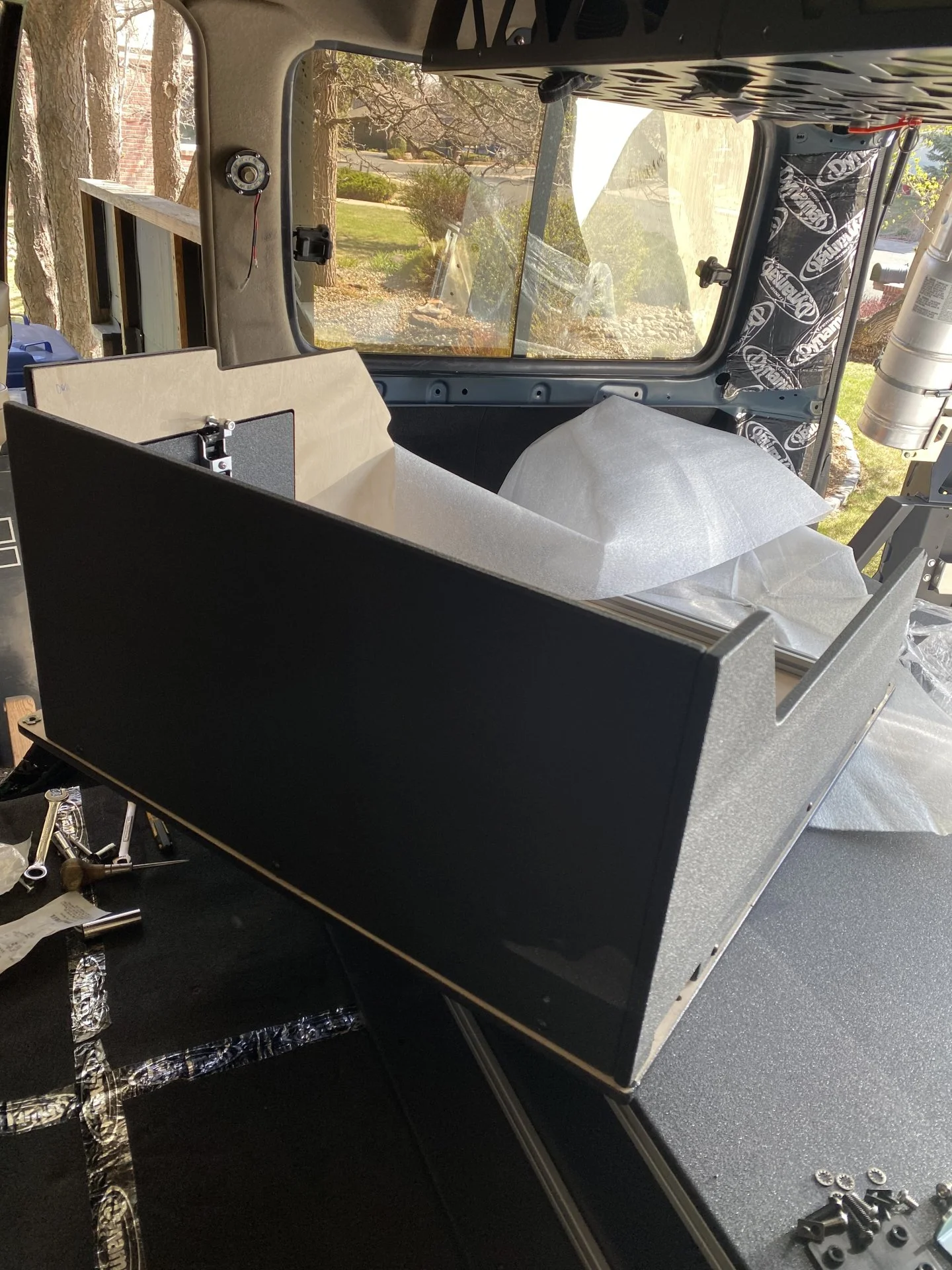

next, the drawer system. Top picture, again, no instructions. This threw me for a loop, I swear I tossed bolts and mounting, trash came that night..... Nothing to mount this. Not possible, it has to be secured. Gave up, probably good because I was a few drinks in. Came back the next day pulled drawers and looked inside. 2 brackets. s***, I have to remove this and look for holes? nope, no holes. Oh shiat, loosen them and adjust to front and rear. Had a couple extra bolts with the rear wings. fit right in the threaded holes!
This proprietary liner is great but marks like crazy. Windex... works wonders. Had to pull the top rear drawer plate to access it all and secure. I'm pretty sure I forgot the tighten the extruded aluminum mounts as the system slid forward when testing the hyrdoboost brakes... NOTE TO SELF. TIGHTEN REAR DRAWER SYSTEM

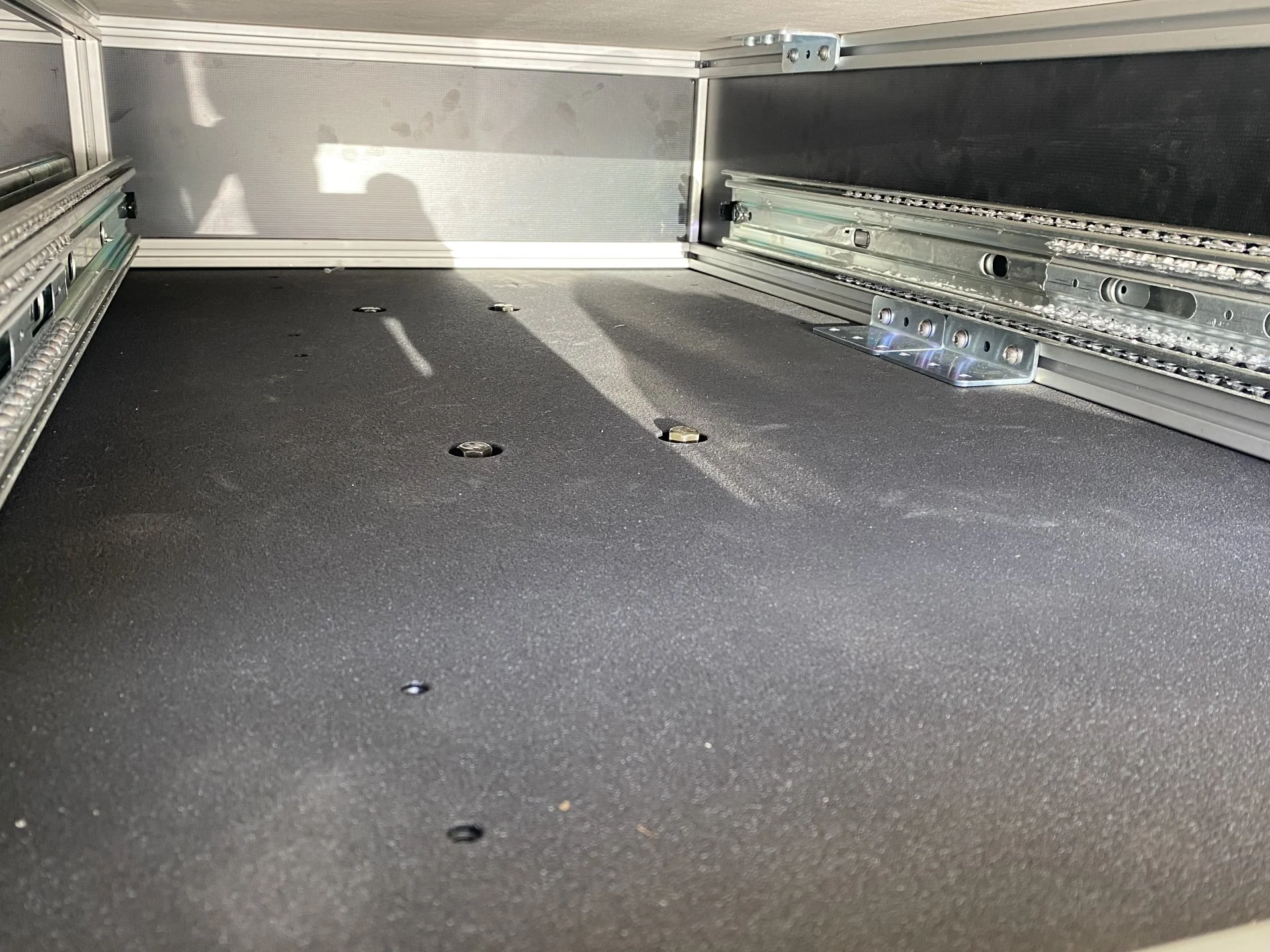

Rear top plate back on, rear seat delete next. Assembled inside and flipped to fit. I used some 1/4"-20 studs I had on hand. The one thing that sucked is the short bolts they offer. Near impossible to start the thread. I know they aren't listening but they should REALLY consider these. It would add cost tho... These were free to me. :p
Pretty slick system, Extruded aluminum 1"x1" and all panels can come off as needed. EVERY door has a lock

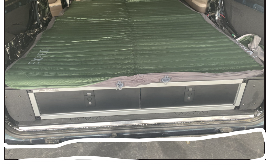

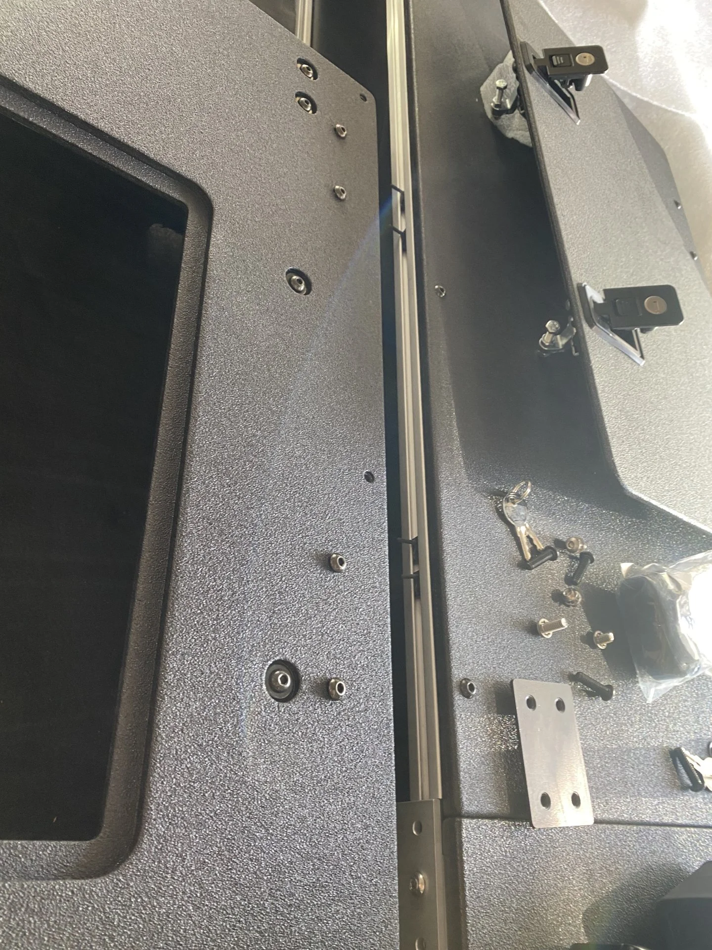

These had a fairly big planned gap in the front outside. Thought it was odd at first but since I have the Dynaliner, I had to trim the side panels a bit and closed the gap to level the fronts, it was bowing the outsides up. I may move out, depends on cable routing and cooling for electronics.
Finished, for now... Testing to come on panels and what to do. Going mostly black inside I do know that. Materials and finish is the question.

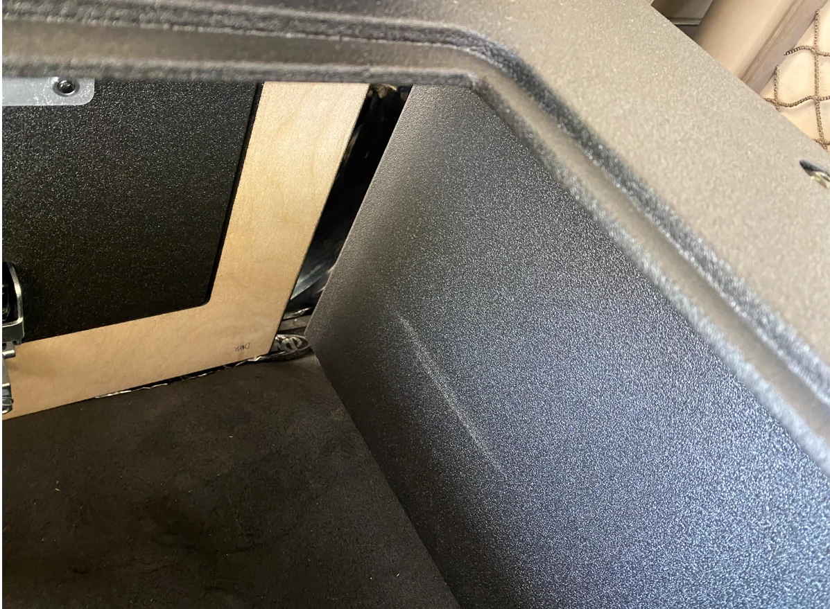

2 , well3 defects I see. I need to call them next week. Both drawer panels were warped on the outsides and not tight, This flip up panel was warped, seems to be coming down in the heat. Test fit the Duo mega mat. Damn, that sucker isn't cheap either, was windy and cold out this day and I had it pumped laying inside looking around and about fail asleep LOL. First test pretty darn good! Long/ wide mat, perfect fit. really, perfect...

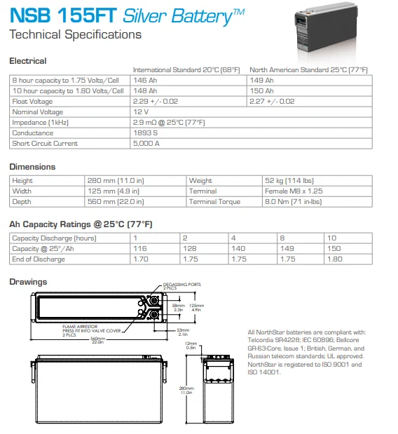

Testing a heavy duty side slider drawer I acquired to support a 114lb AGM battery I have on hand for free. Really don't want the weight but I have had these for years and better yet free to me, a couple going on 15+ years I gave to a friend and his RV. Solid battery's and built for telecom. I have some connections with NorthStar and confirmed I can run this on its side. Vent holes are for Hydrogen discharge and I will vent these outside ultimately.

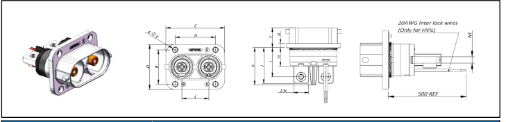

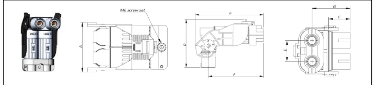

I had to go HVIL option as it's the only type in stock. From what I can tell it's a safety device for EV's. I will utilize possibly and if not use it as another passthrough if I can get this to work well.

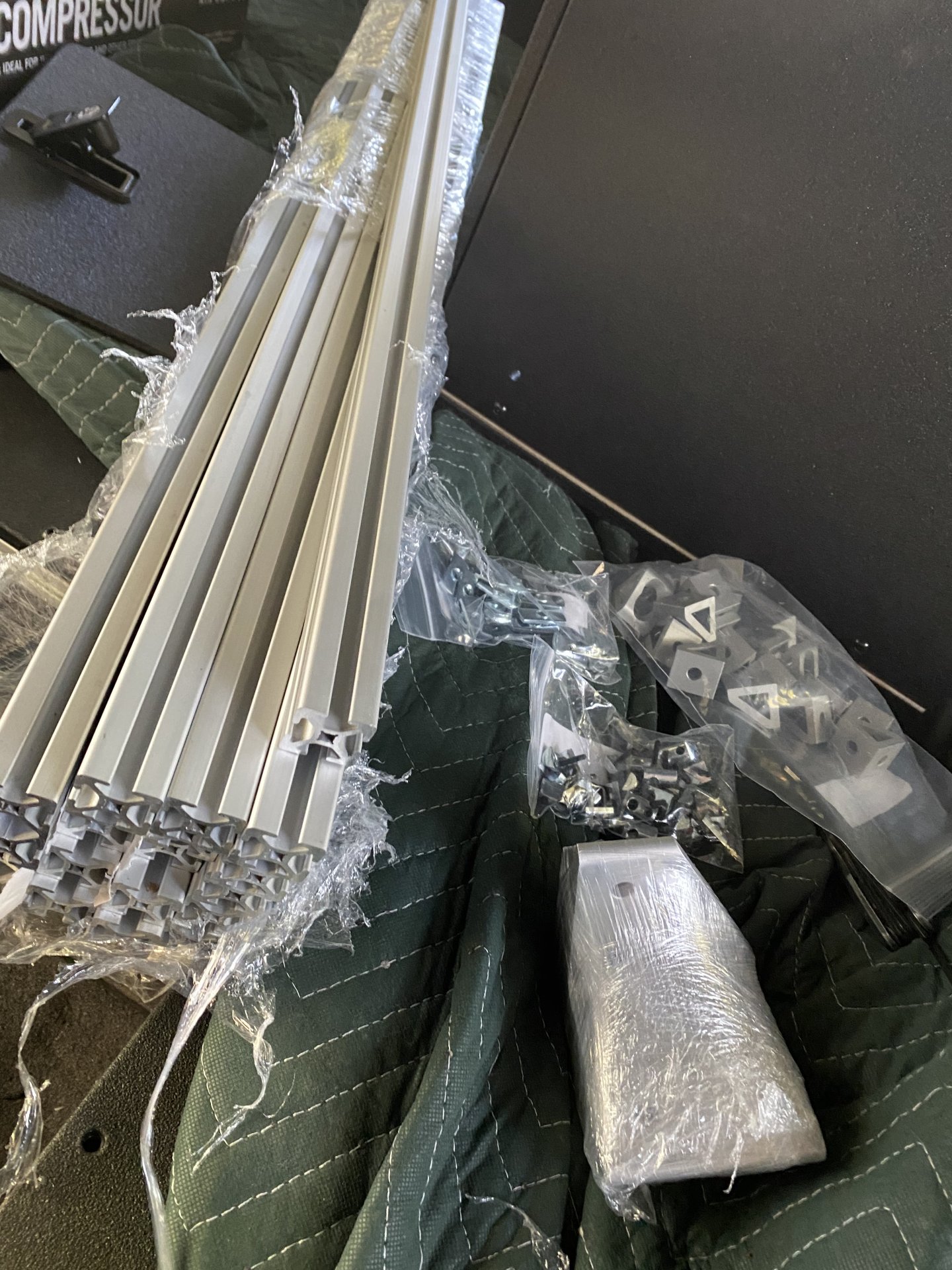

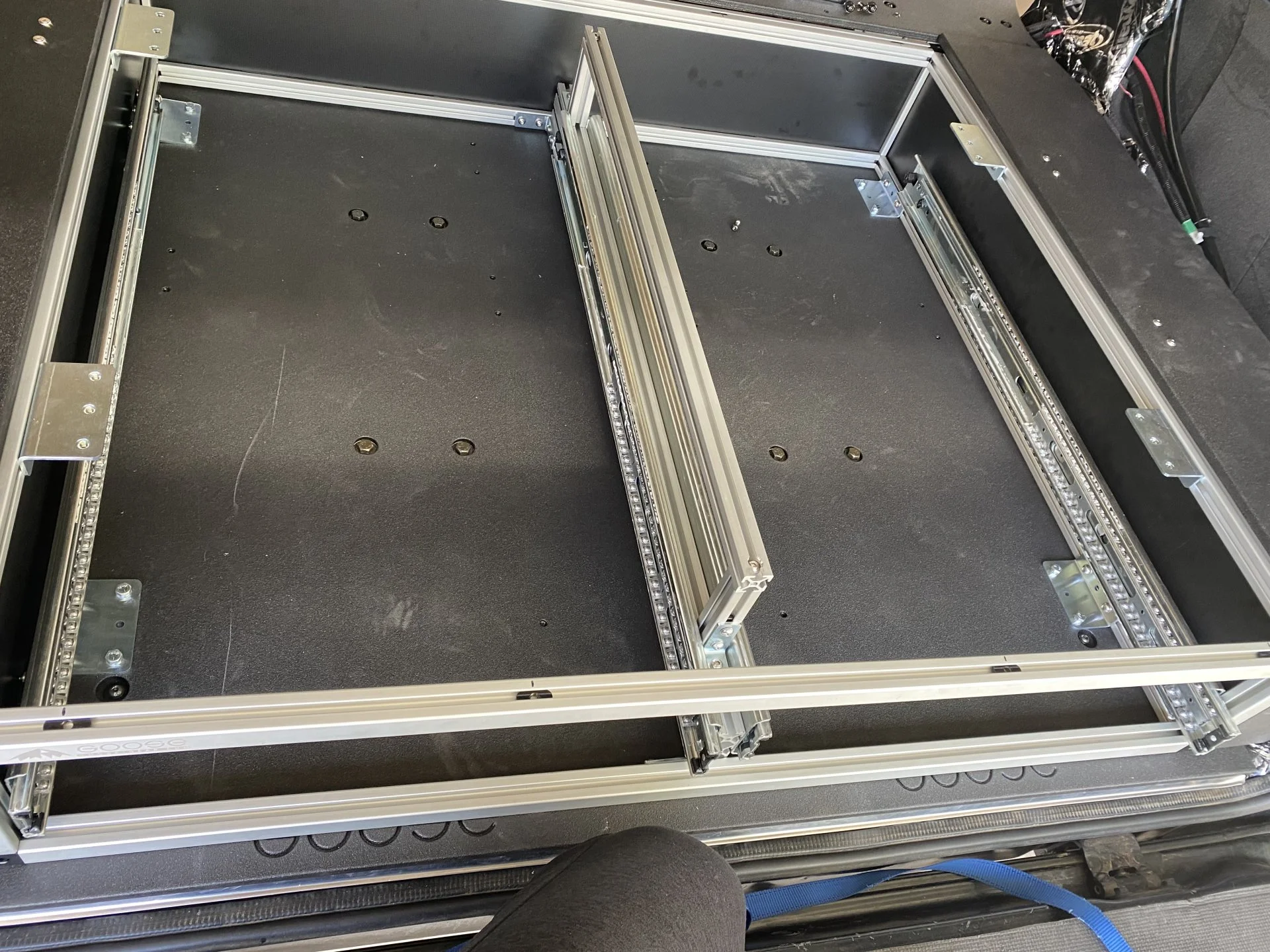

Got some extrusion parts in and doing a little mock-up. Now I know why the GG system is so $$$$. Extrusion parts are not cheap. Went with more 1x1. Few 1x2 possibly for the battery and just go lighter fixed tray. If all goes well I have 15 years until I pull the heavy bastard back out.

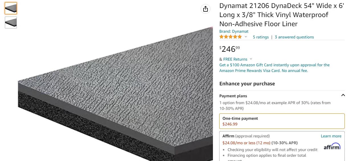

Going black on interior. SEM seems ok but scratches easy. They have a bed liner type product I think will work better but trying this for now since it was recommended by a local shop.

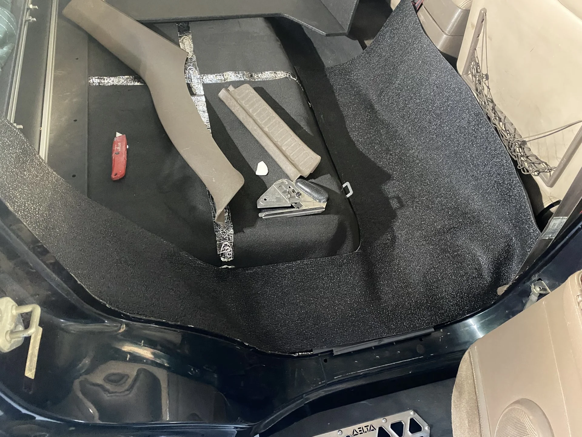

Took the 80 with this dynadeck to a local shop. Unfortunately I can't shape the Vinyl to the body so will have to do it in pieces. They gave me some good ideas so went with cutting in 4 pieces (splice down center, upper/lower) due to the split Goose system and the idea to route wiring from the console to the rear area when I get there. This saved having to get another piece for the area (one floor/ one upper deck, no splice on either). No need to do the rear here due to the Goose drawers, Just stuck to mid front seat section to the rear wheel wells. Front area will meet up mid front seats and hide the splice well, front to likely come next year. Found out the Dynadeck had a foam underside, so the Dynaliner is overkill but it worked well with the system and should help a ton with noise and heat.
First of 3 section I cut out of the full piece ordered(they have a few sizes available). This would be possible with an upper and lower section without the splice but it would obviously double the cost.

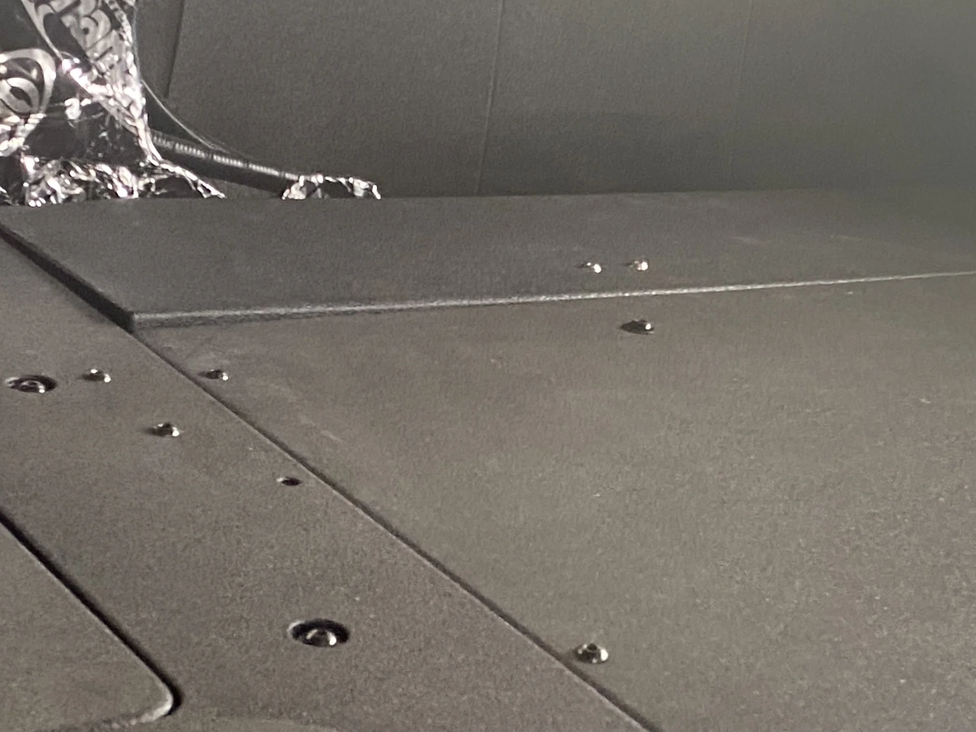

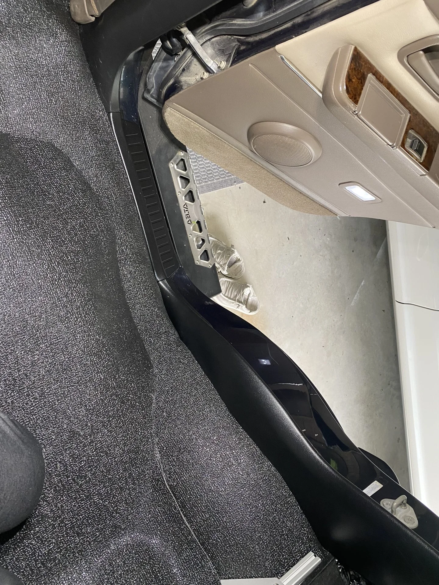

First impression is this stuff is great. Will clean up well, very well made, no issues with moisture here since in the high desert, that the the floor is sealed very well with the Dynaliner. I will for sure extend to the front.

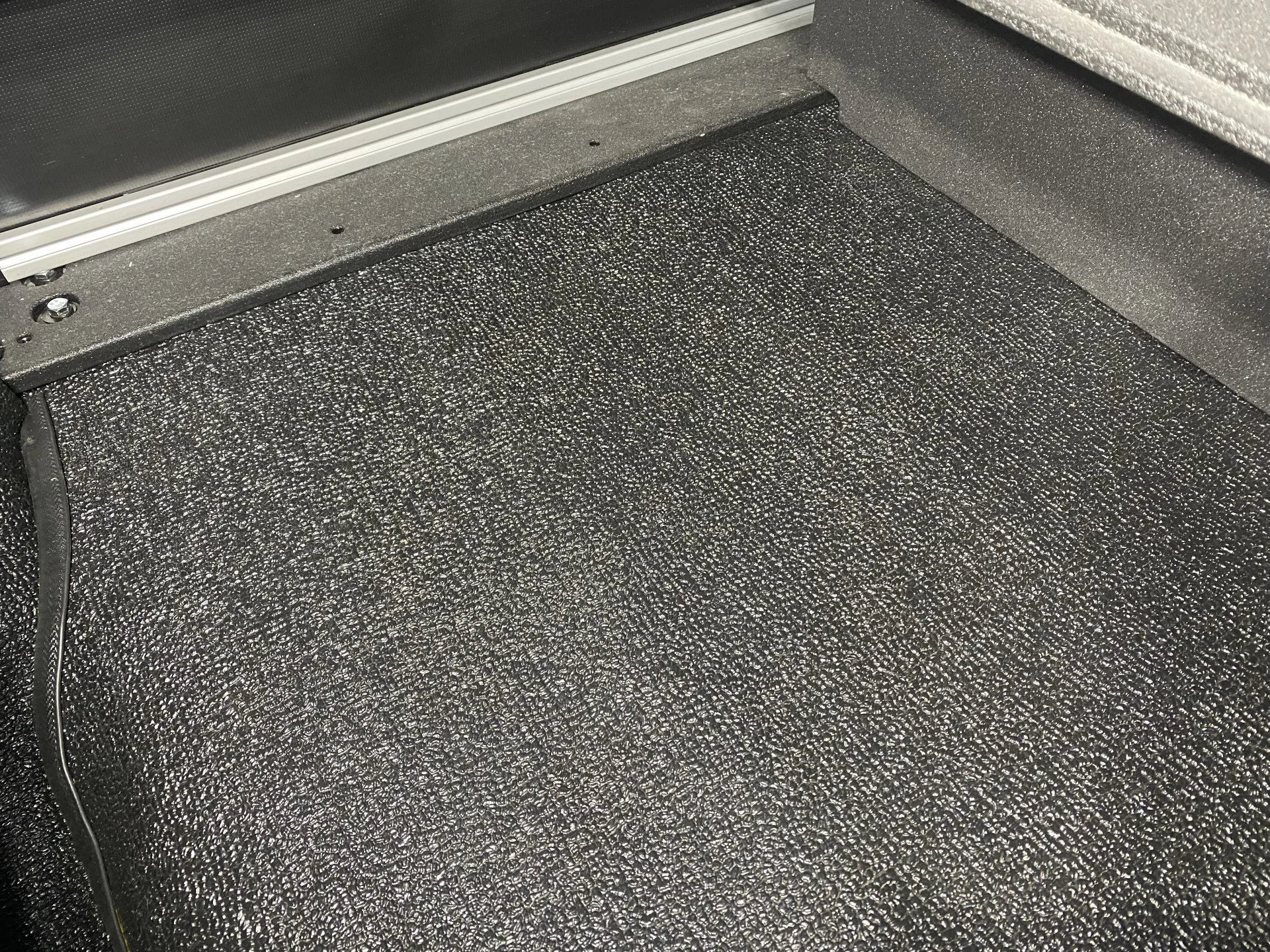

Drove the fat pig about 800-900 miles and over 6-7 passes in 3 days with one a mild offroad and it did amazing. Some gas smell which I'm thinking the rear vent/float in the tank is letting fuel by to the CC(likely why so many have issues with the OEM CC as the vent line is always filled with gas? Will continue to watch and just a guess). Outside this and the fact it's getting WAY heavy on the uphill passes, it did amazing and better than expected, especially, the road handling and braking on the curvy roads.

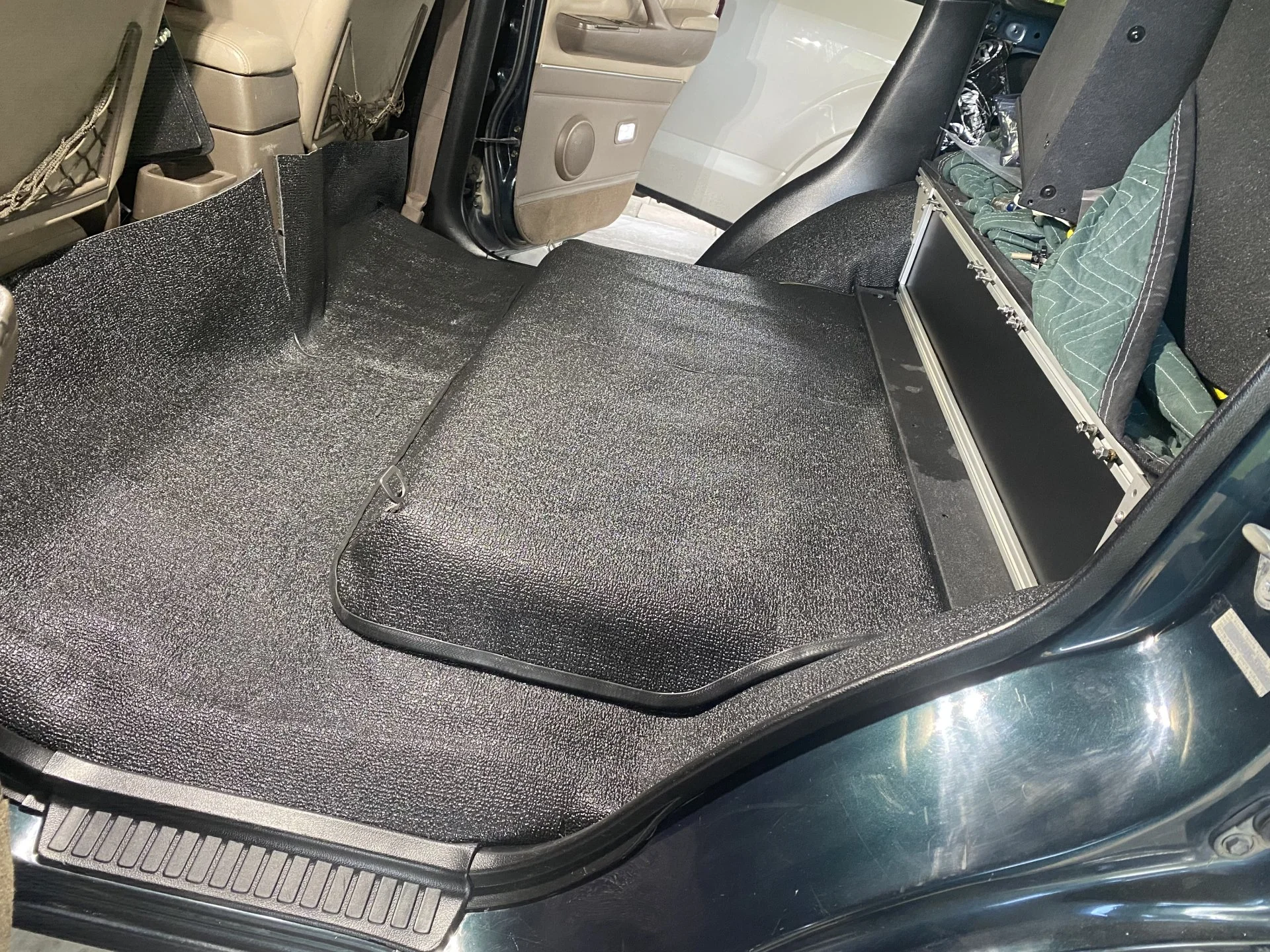

Vinyl flooring and tape is holding up great in the mid section. Excited to get the front done with the same flooring (spray down interior with hose? nope, but way better than nasty carpet and should still clean really well). If you ever have anything to hold in place, the 3M VHB is the tape to use....

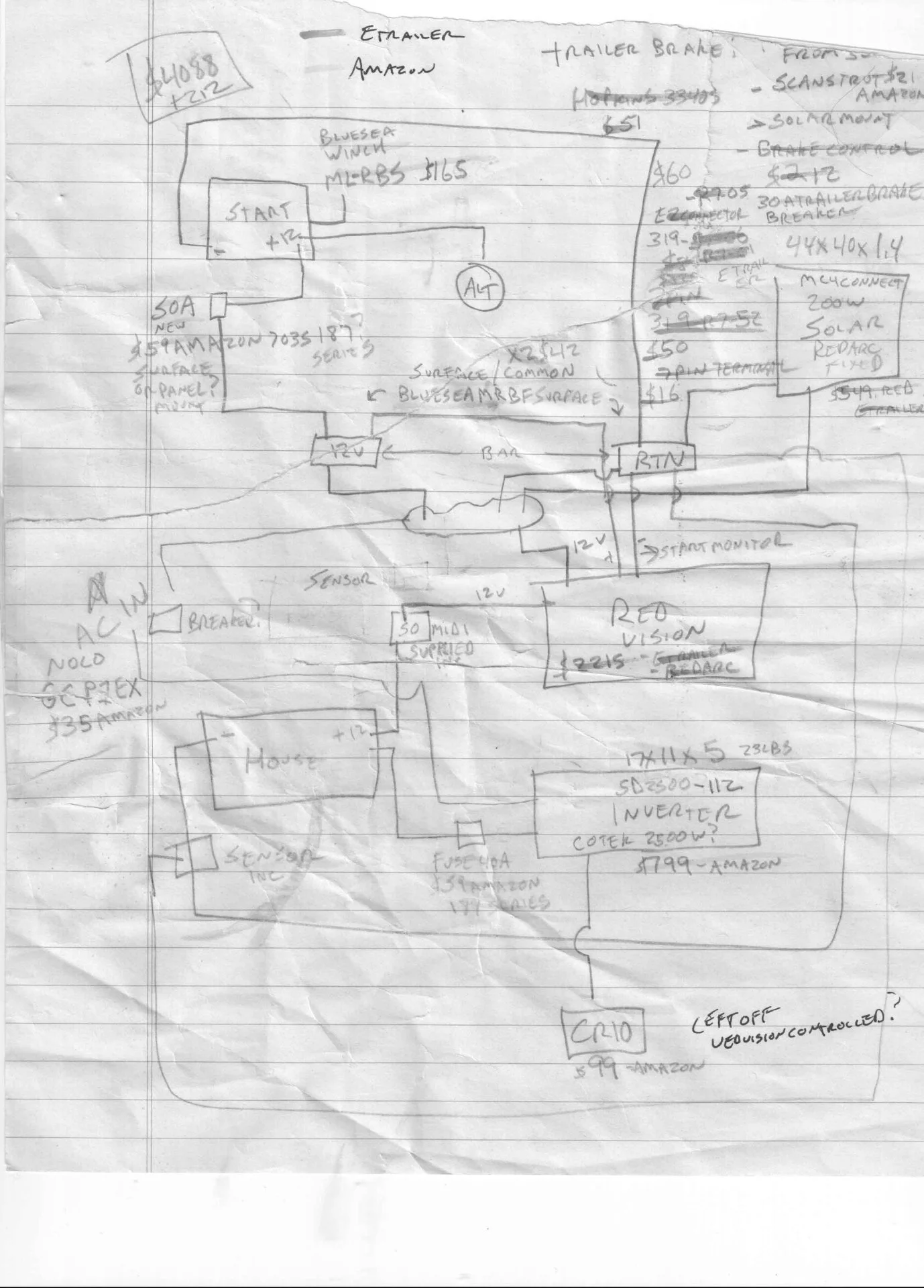

Worked on this last year and figured I better scan it before it gets destroyed and lost.
Extrusion in . The GG seat delete is solid but not braced well for what I'm planning. So many parts and time to plan this out and put it together. Any panel can be removed now and it will hold together giving many options to dig in and troubleshoot and add circuits.

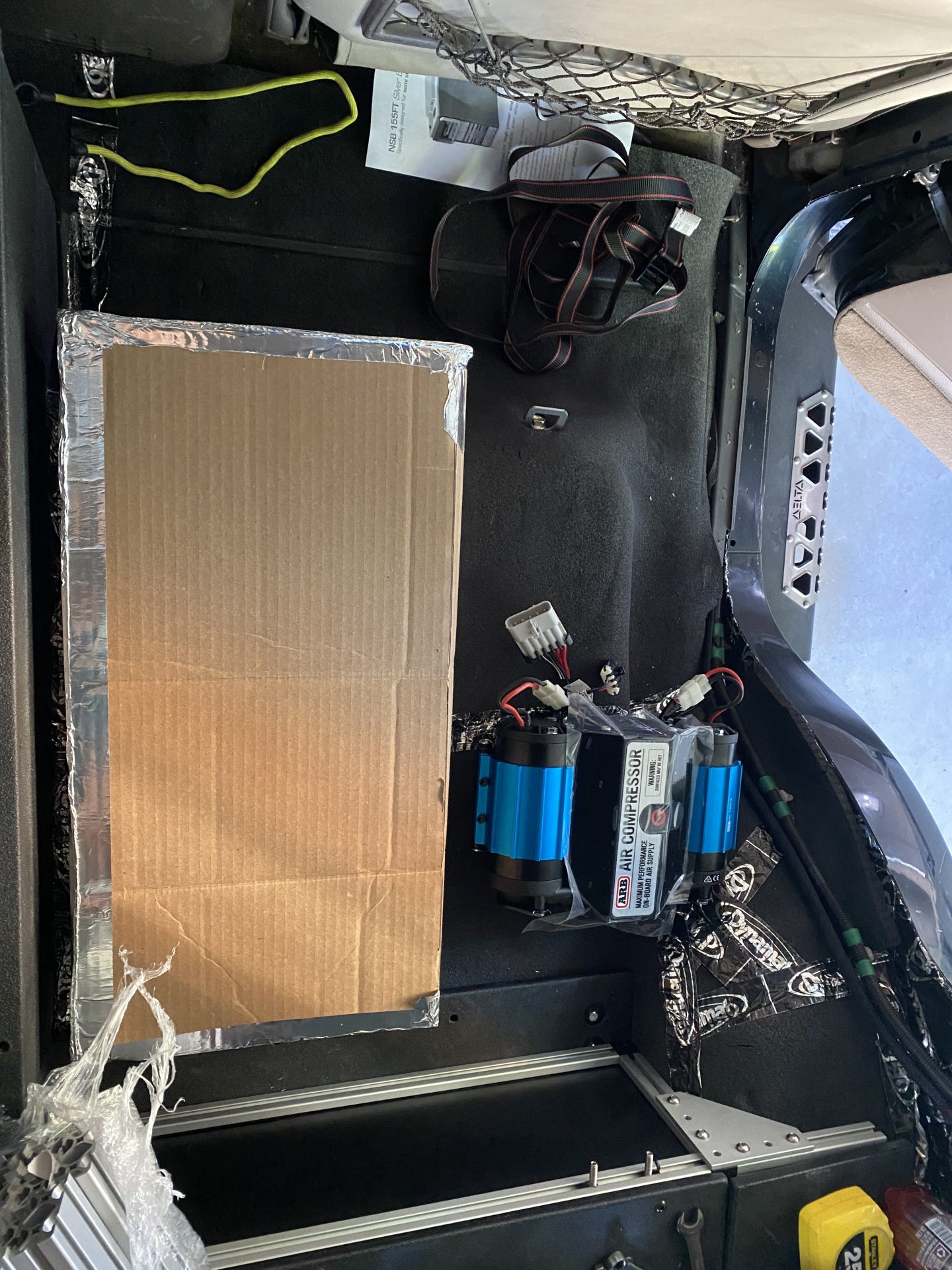

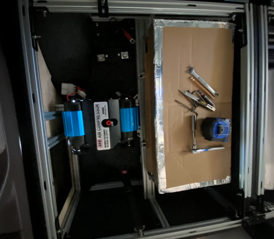

Passenger side, twin compressor with filter to be mounted, and battery(cardboard box testing fitment), little concerned still about running it on its side but manufacture was confident it would be fine. 155 AH and 110 lbs. So much overkill... The Battleborn 270 AH(80 lbs) beast will also fit. Saw one at the MW expo and @ $2400, I passed.... I will stick with free and the extra weight.

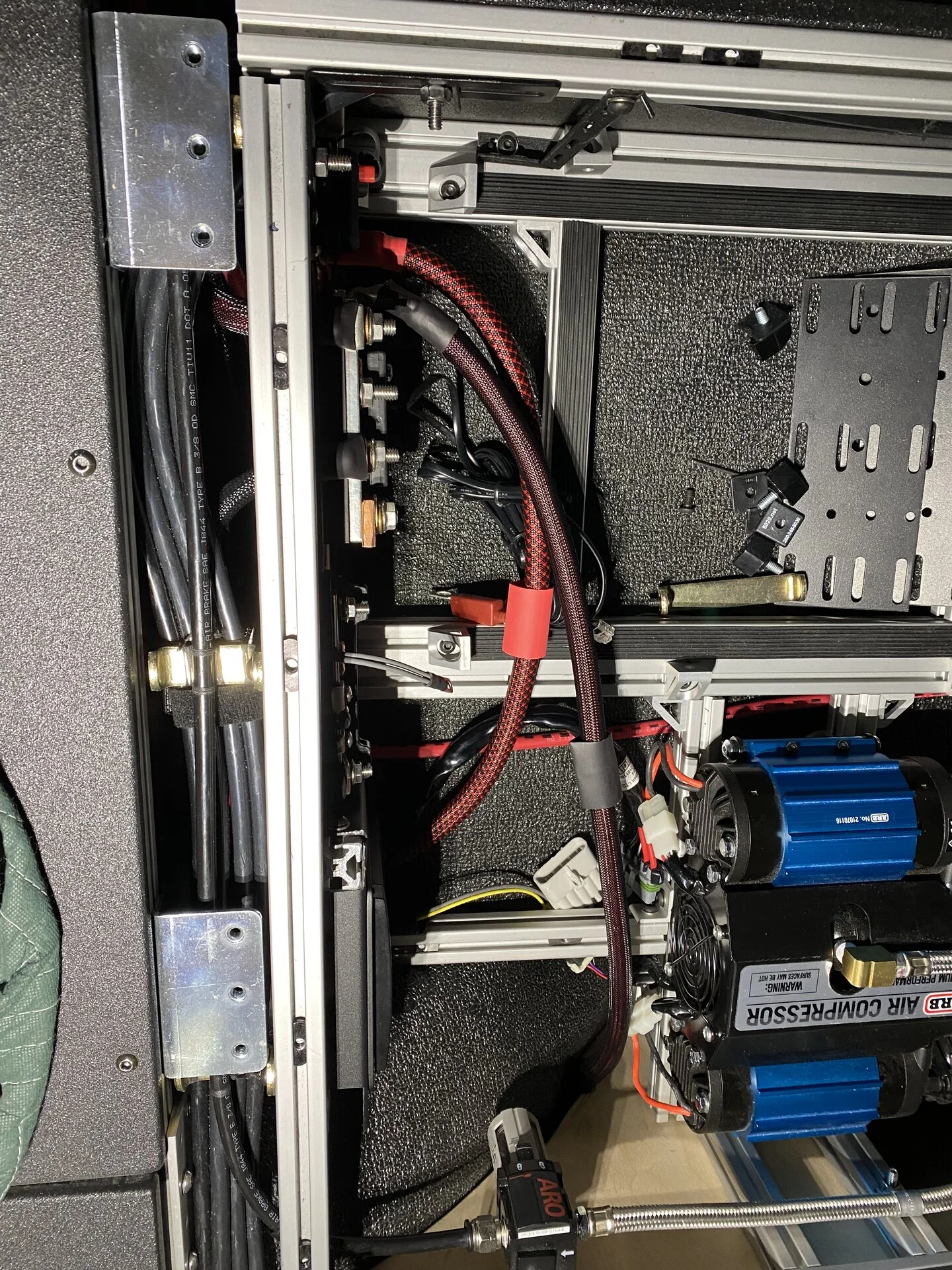

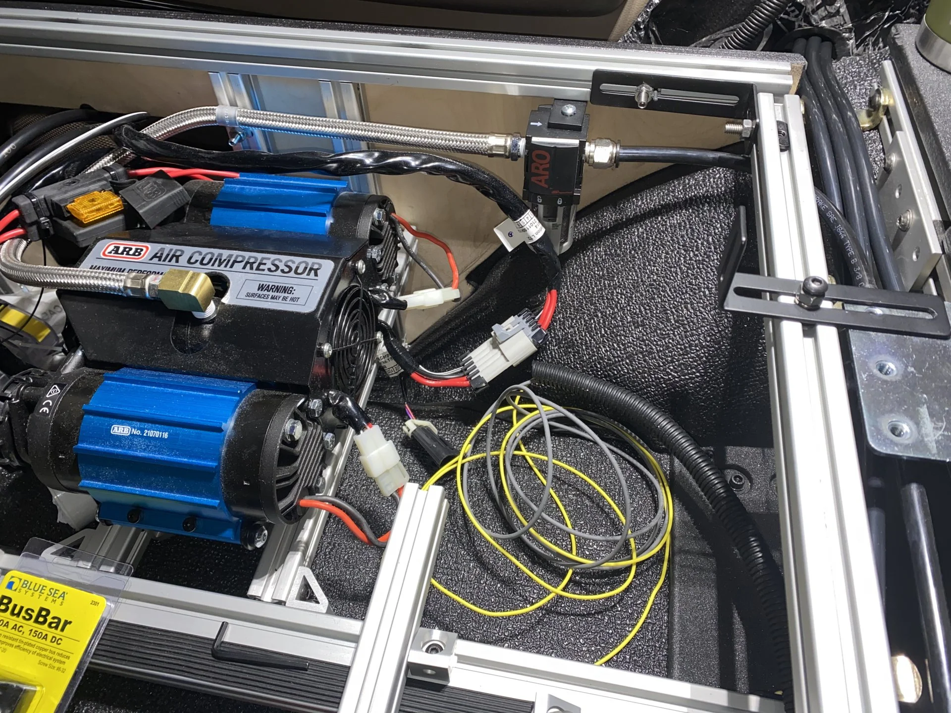

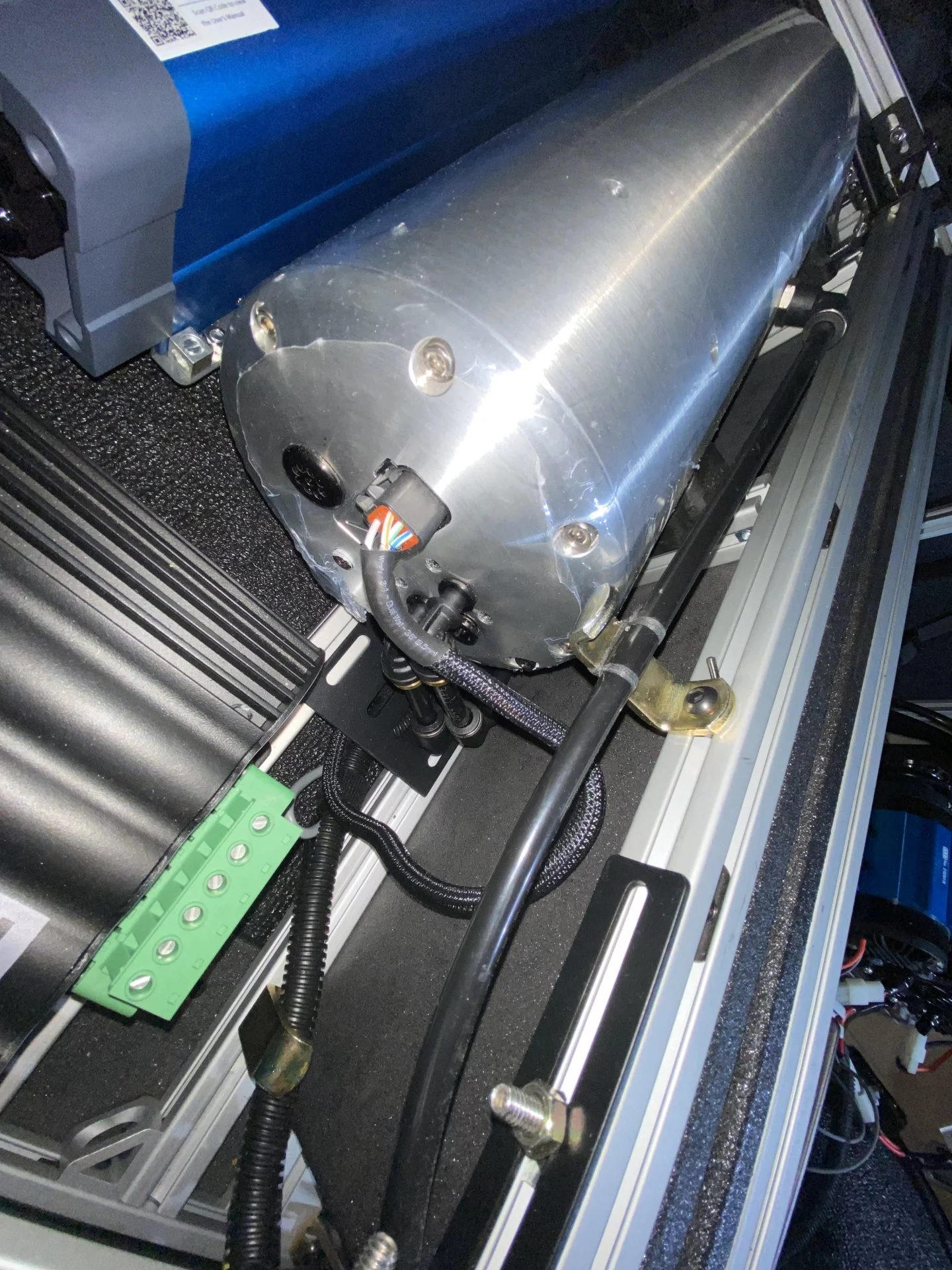

Twin ARB mounted passenger side, left the compressor supplied mounted intake filters on for now. If it helps keep temps down, I'll try pulling cooler air in.

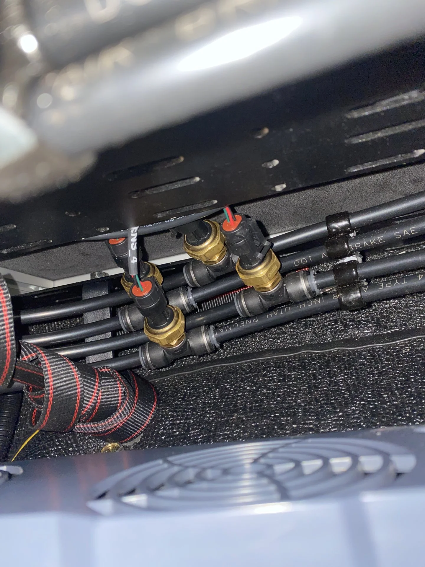

Going with braided line for heat and added in a water filter trap to help keep the tank dry.

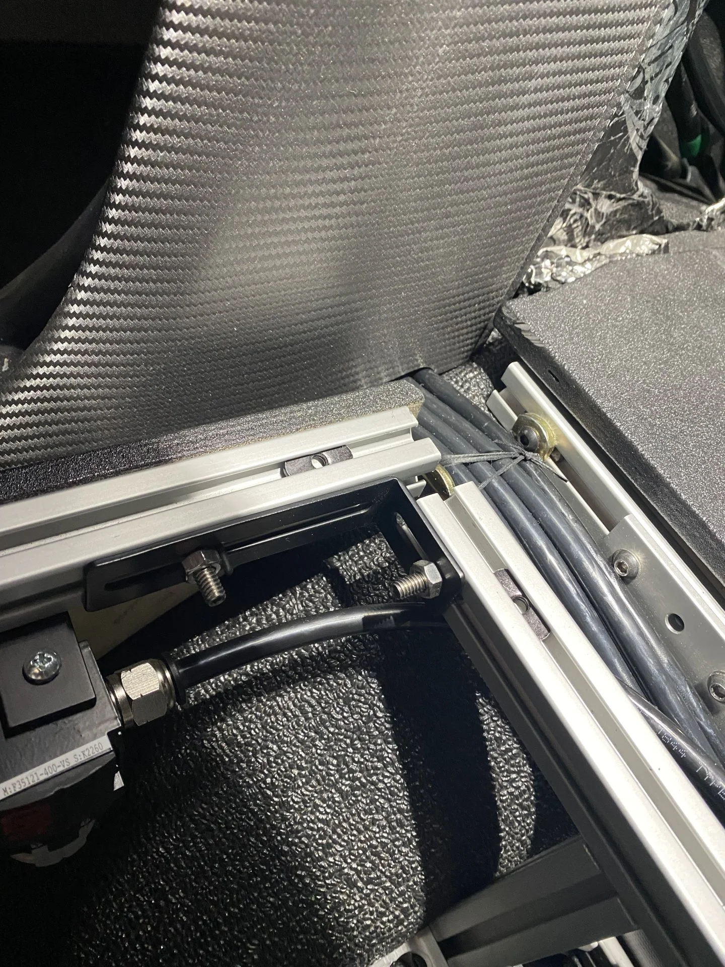

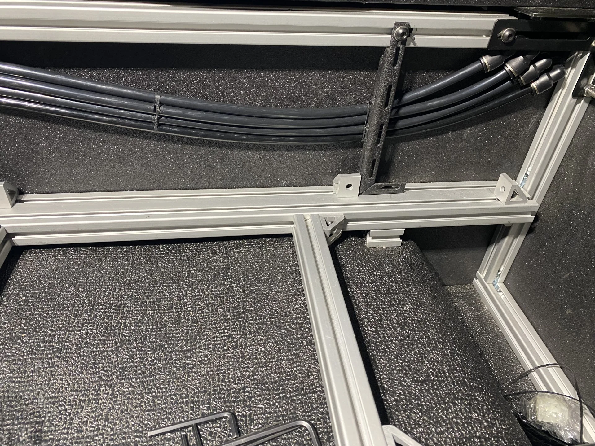

3/8" line to tank on the passenger side. Line passes through the rear gap in the Goose system.
3 of the 4, 3/8" runs that will feed out in this same area through the passenger rear that will pass through under the body near the frame later. I drilled a hole to pass them through into the passage way just above the wheel wells, very tight fit but just enough for the 4 feeds.

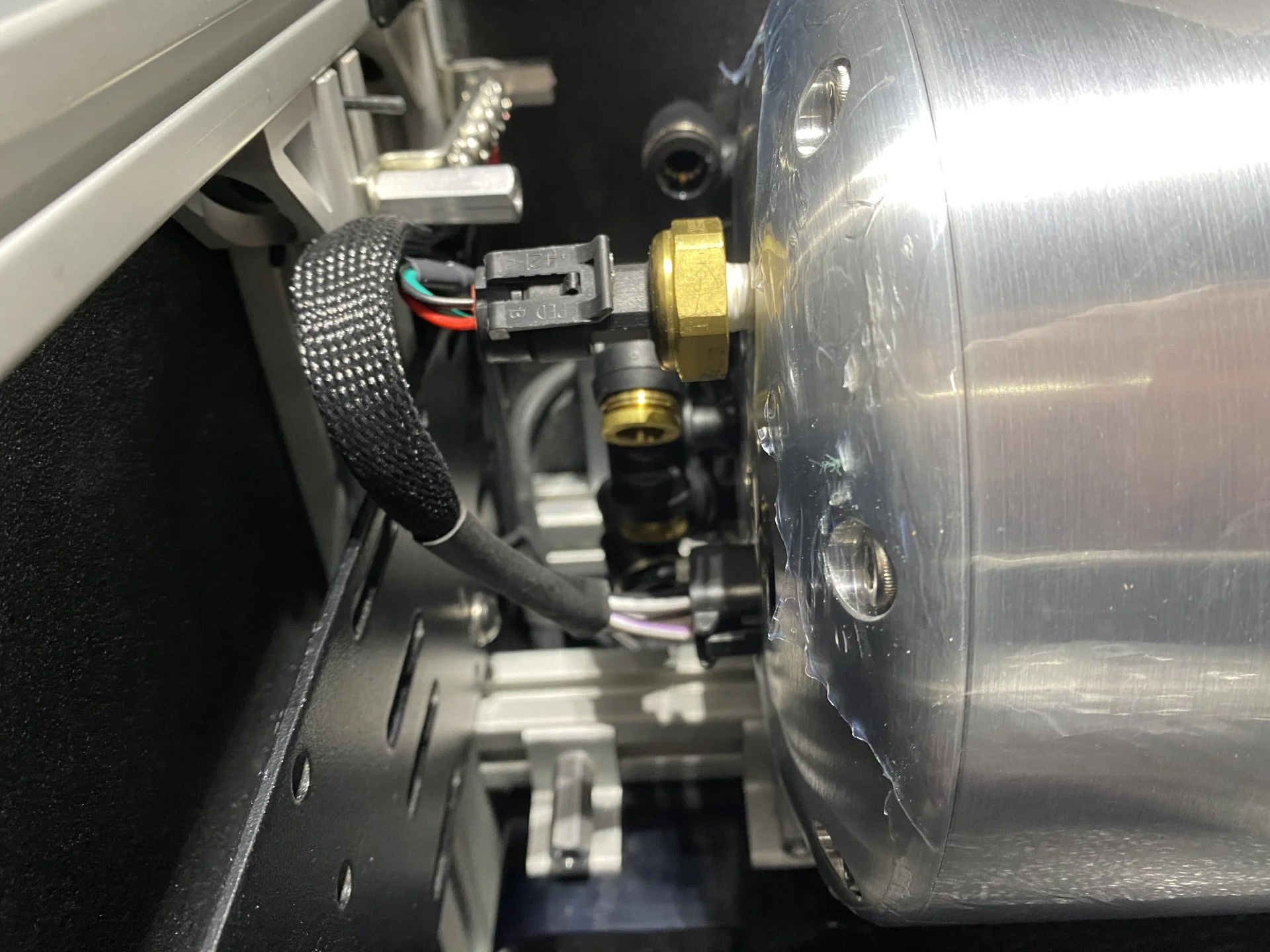

The Twins "SHOULD" trigger from an adjustable pressure switch on the tank, I should be able to set it at 150PSI once I get it up and running, 150 series made by Delphi, went with Amazon since a little quicker. Yellow wire from the AccuAir to the center purple wire on the pump. Not sure if the ground is required but will pass it through as well. 3rd pin not used. I believe the twins have an internal check valve? Couldn't find this detail anywhere so pilled the one that came on the steel line out, it seemed like it was restricting air way too much.

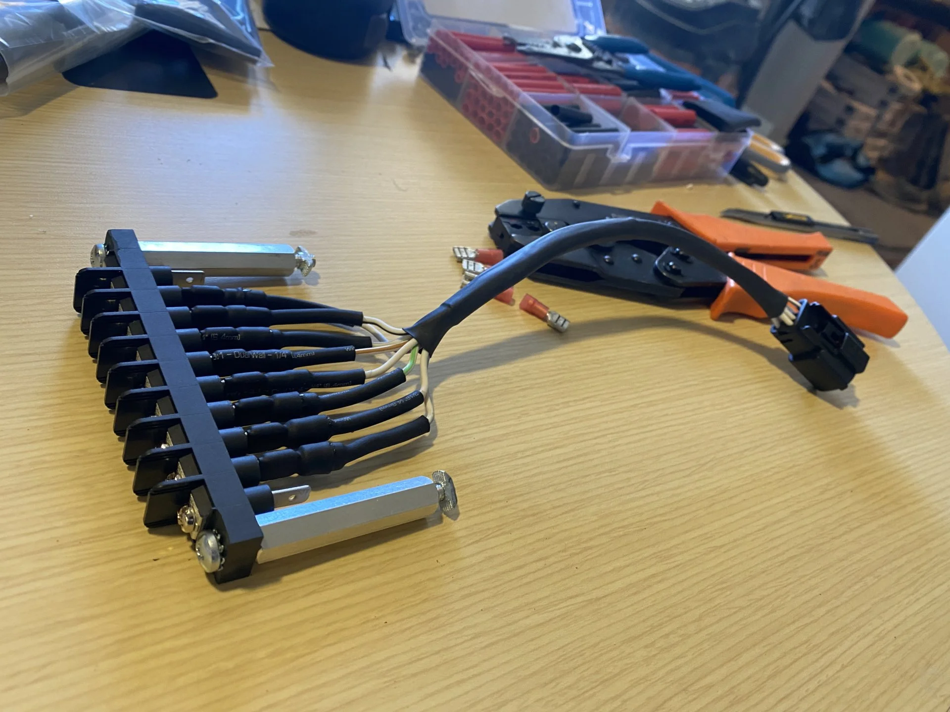

(2) 40 amp feeds will be too big for the Redarc redvision(max 30 fuse) so unfortunately I had to rethink this and went with a Blue Sea 360 4 position panel I'll touch on soon. Originally wanted to go Blue Sea 187 series breakers but started running out of room and didn't like to mounting options.
These will feed up under 2 mounting plates I added for wire management and whatever else I end up adding in the area. Framed in the area behind these plates, just enough room for a 4 breaker panel and cigarette lighter/ USB feed that can expand into additional breakers if ever needed,

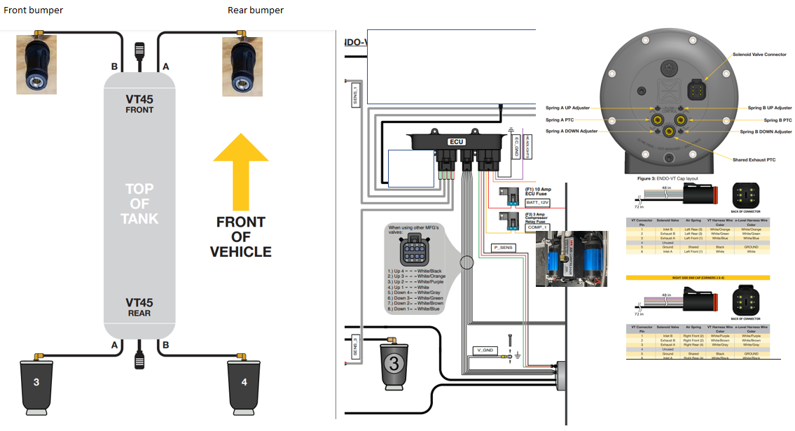

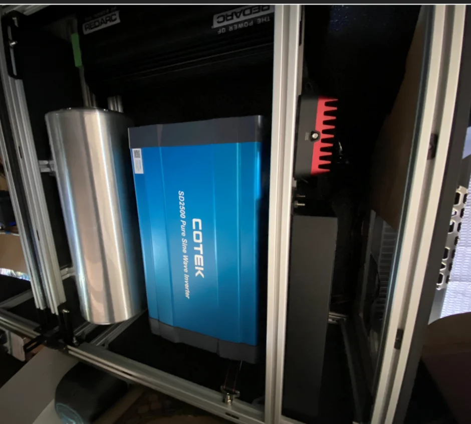

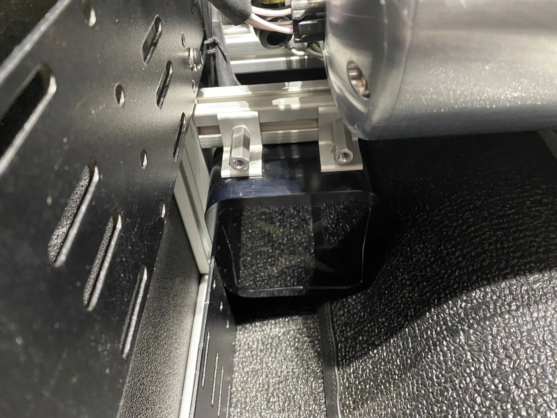

Endo VT 3 gallon tank just fit in the drivers side area. Filling up gaps pretty quick! Slick tank quick disconnect mounts added to the extrusion bracing. These are the internal valves(4 total), 2 each end, with 8 wire connectors from each with 2 each PTC 3/8" feeds. Wires and air lines feed in a cable chase I added to reach the far side near the brains and terminal strip.

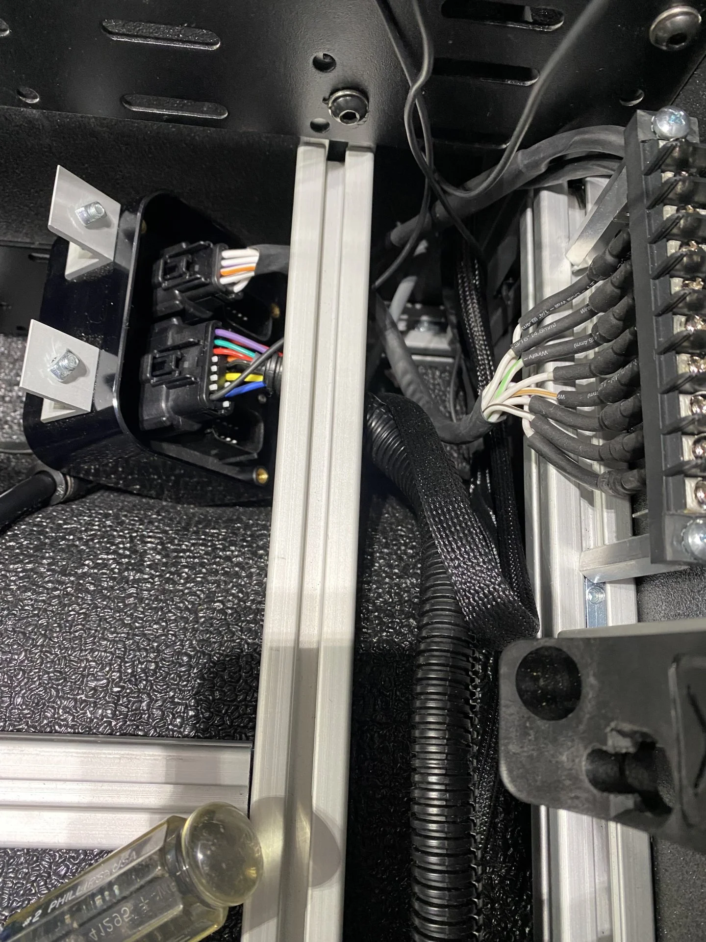

The brains are tucked away front driver side of the tank. Easy to pull out and manage wiring. I called AccuAir to get the connector type and wire all valve feeds direct but apparently got an engineer that didn't want to do his job or just didn't want to help identify the part number on the plug to order from Mouser. I later found the plug but decided to do a passthrough so if I need to swap feeds, I could do it easy.
4 feeds collect near the brain up front and T into pressure sensors, loop back and through the Goose at the front, tight fit so added (4) 90's to feed to the rear in a few retainers I made up and as shown earlier, out into the body above the rear wheel well to the frame area.

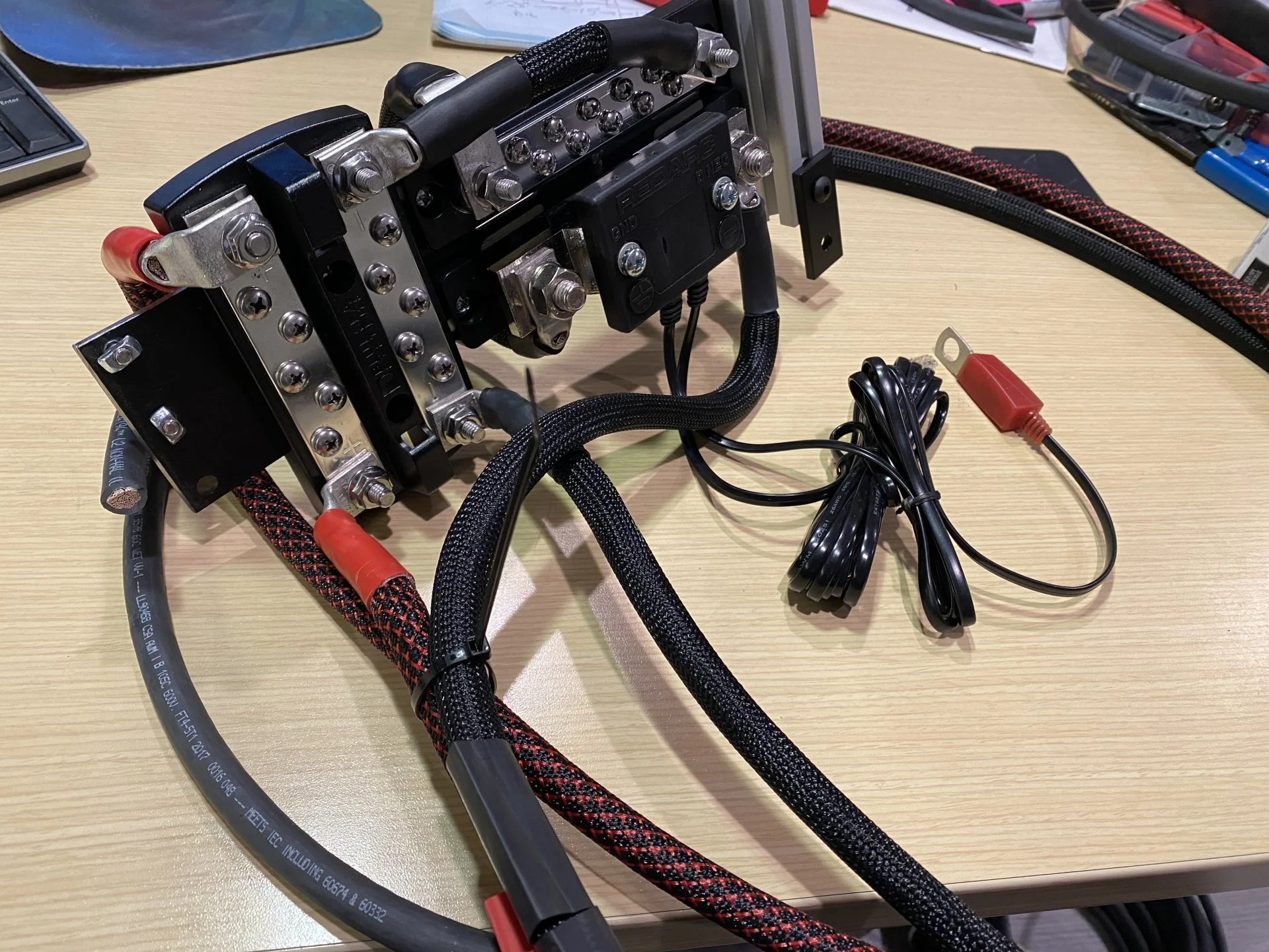

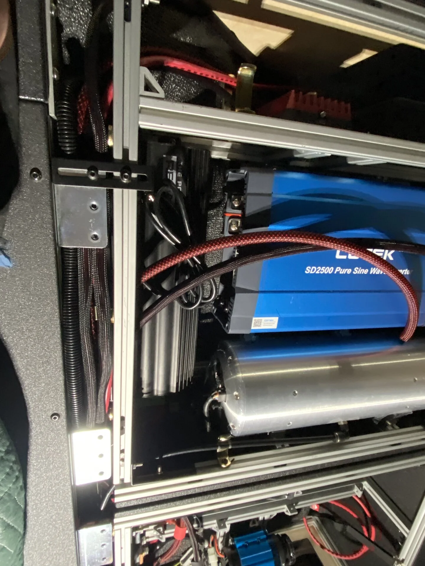

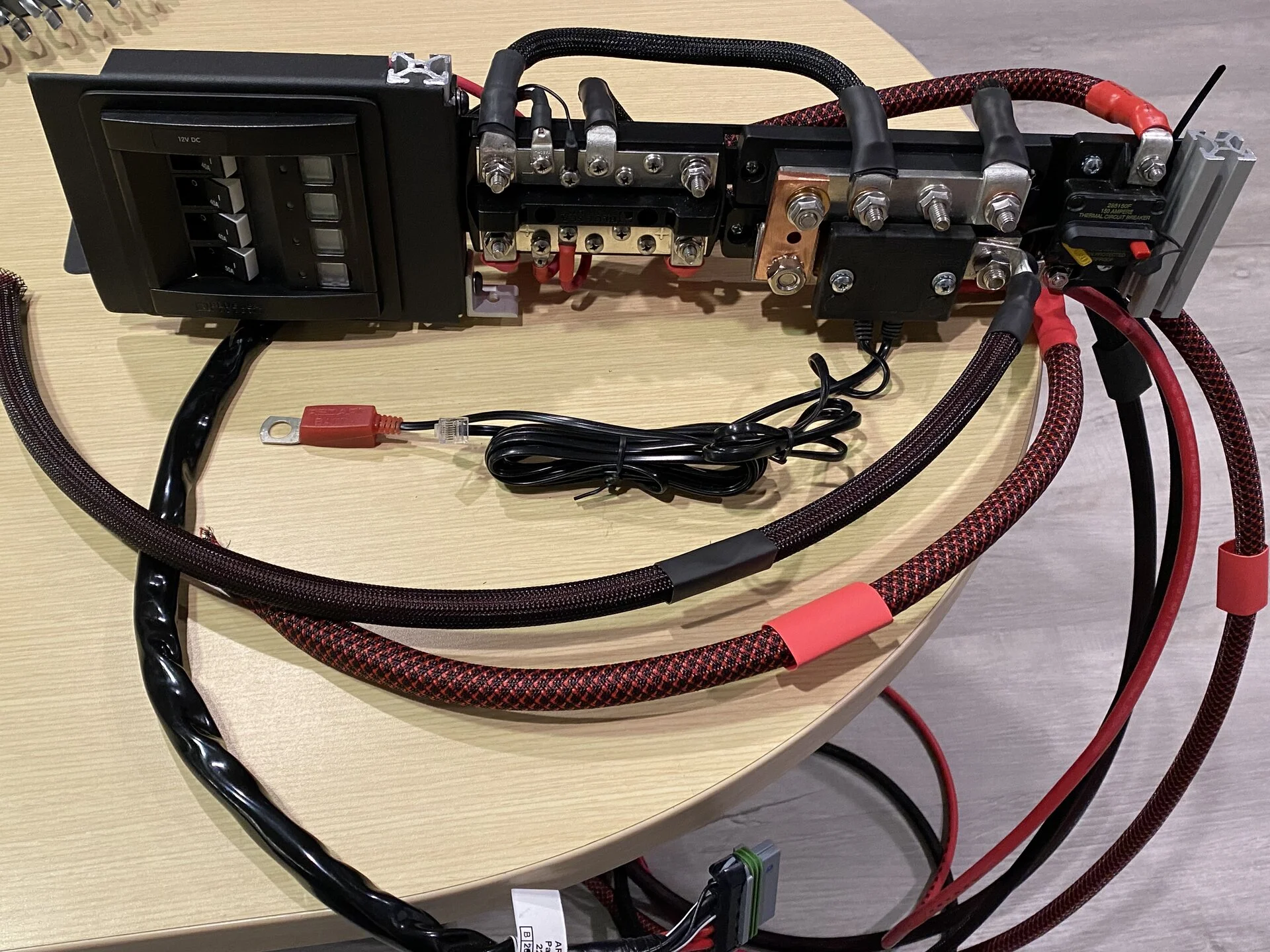

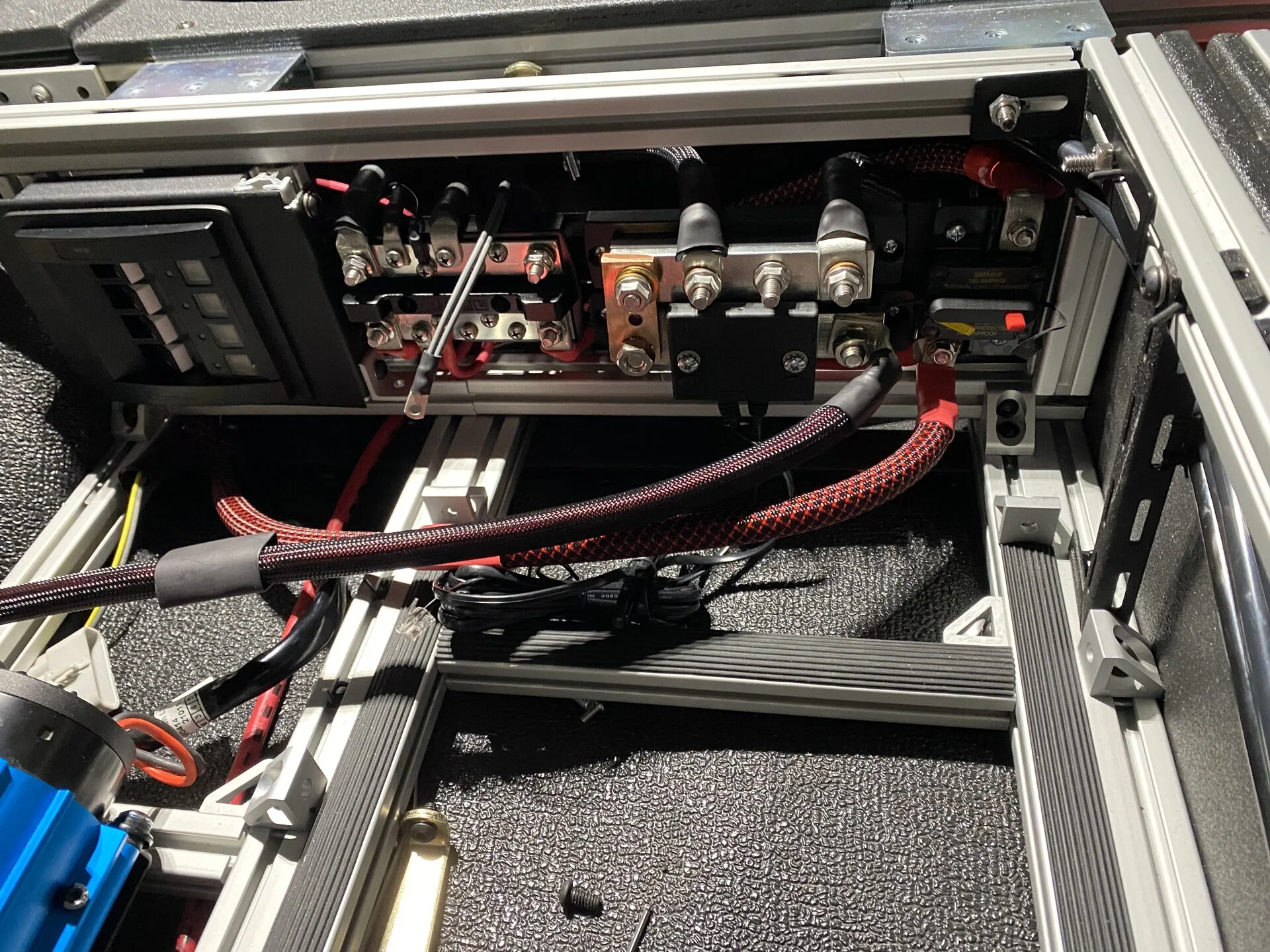

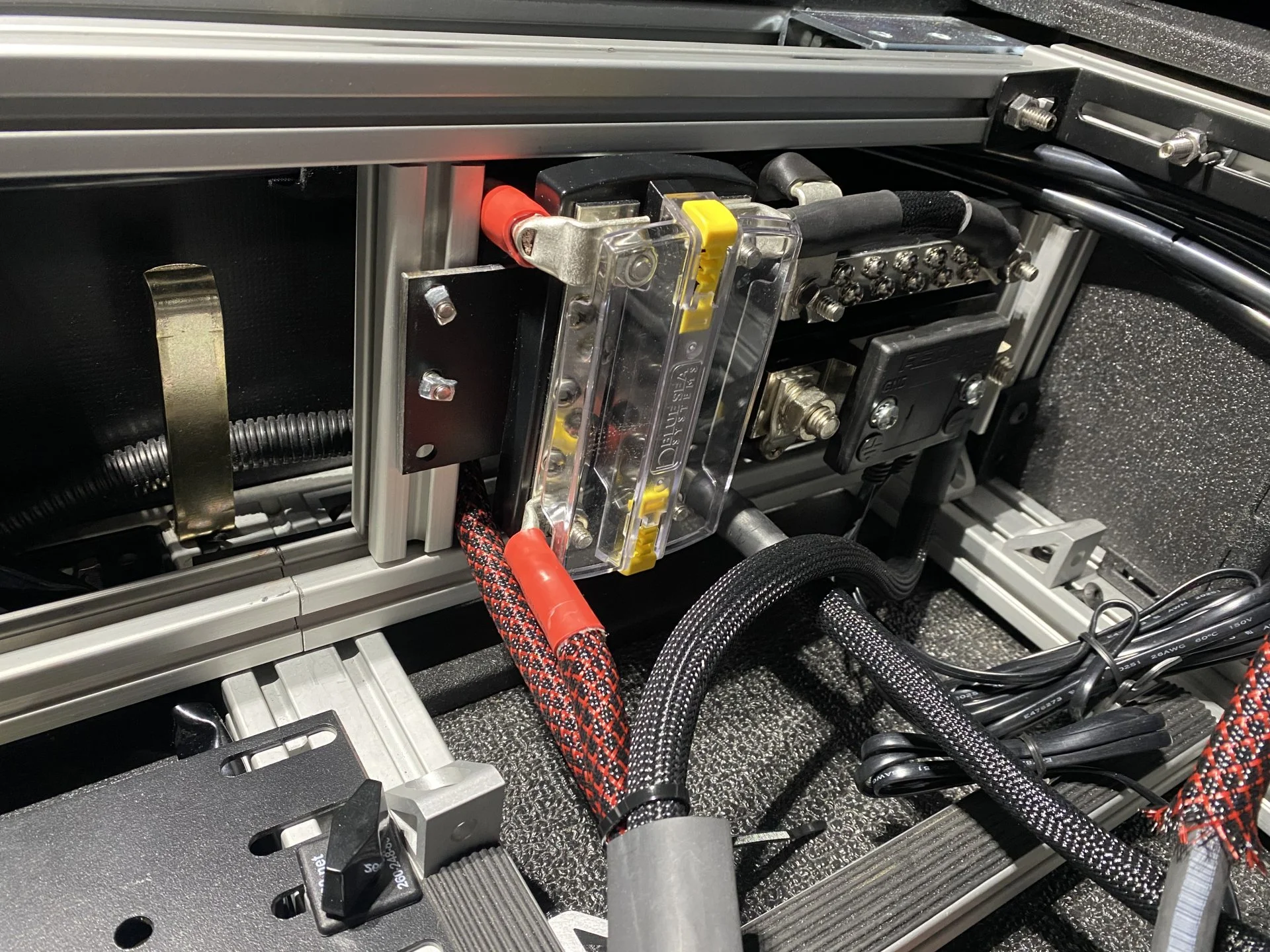

Mix /matching some Blue sea terminal blocks and the redvision battery monitor back on the passenger side. Added a second ground bar since I seem to be needing quite a bit of ground feeds. Just enough space, I think...
All 2 AWG feeds from the house battery back planned. The actual front alternator feed will likely be 1/0 but the Redvision only feeds a 30 amp charge through the manager 30 system. Battery through the terminal strips then feed out to the other electronics and the breakers I will add for the twins (40amp) with I think 8AWG or #6 if I can fit it, ARB provides what seems to be very small #12... a 50 amp feed to the redvision/ Manager 30 and a 40 for the inverter.
Test fit while I wait for a few parts and try to dig up some #8 and lugs. This panel will sit back about 1" and just clear the battery if I can get it all squeezed in,
Also added some rubber stripping from 8020, love this stuff, to cushion the battery(120lbs)...

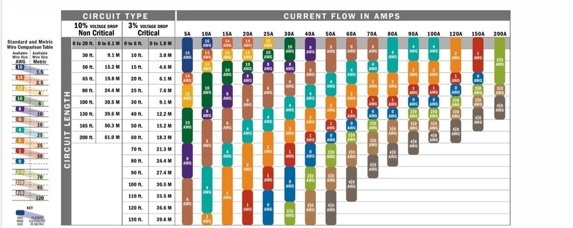

Adding a pretty common reference for wire sizing.

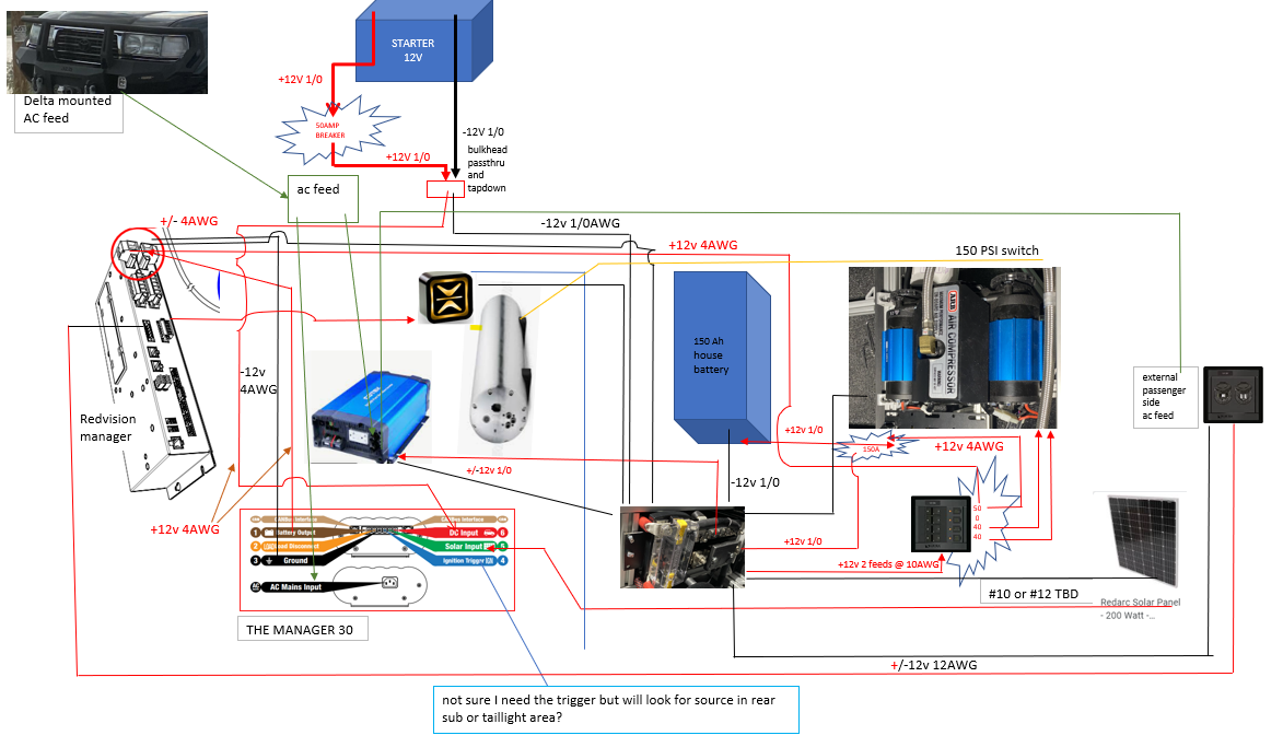

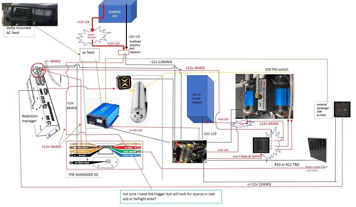

Had a few minutes on the work computer today to lay out the base wiring I'm looking at. A little :hillbilly: but it works for me.
*EDIT-
V1, changed breaker size to Inverter to 150 and upped cable feed to 1/0. still undersized for the 2500 WATT but I don't see maxing it out or want the larger cable size or battery string to support it.
V2, removed the accessory feed.
A lot of things coming and going in this area. #2 mockup and test fit.
Soooo, I overlooked the 40amp feed for the inverter(white sheet listed 40x9 amps whatever in the hell that means). I believe for a 2500W inverter, your looking at fusing @ 250amps, and a bank of batteries.... Zero need for this and went too big on the inverter and zero interest in running 4/0 cable, just to burn up the battery, so will start with a 150 breaker to match the 1/0 I have and more than I ever see needing.
With that said, shuffle the terminal strips, ditch the USB/ CIG accessory feeds and prep for a lot of 1/0 in and out in a small space.
Cables attached for the most part:
She is tight, making a couple adjustments and hope to be good!
