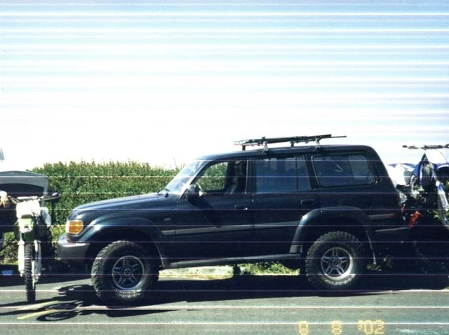

Since these are useless without pics, here are a few over the years, to date, just lifted, many 35's gone through and really just used and enjoyed.

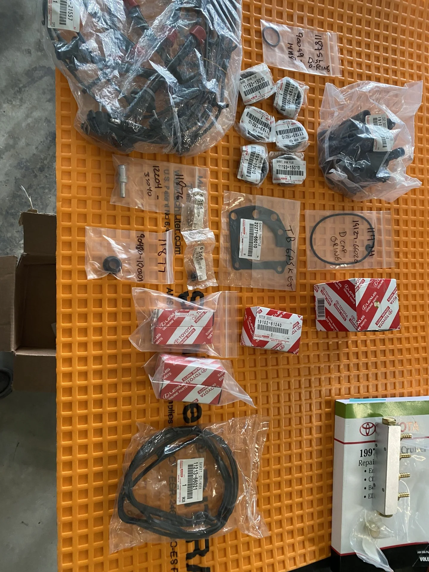

OEM tune up kit. May 21

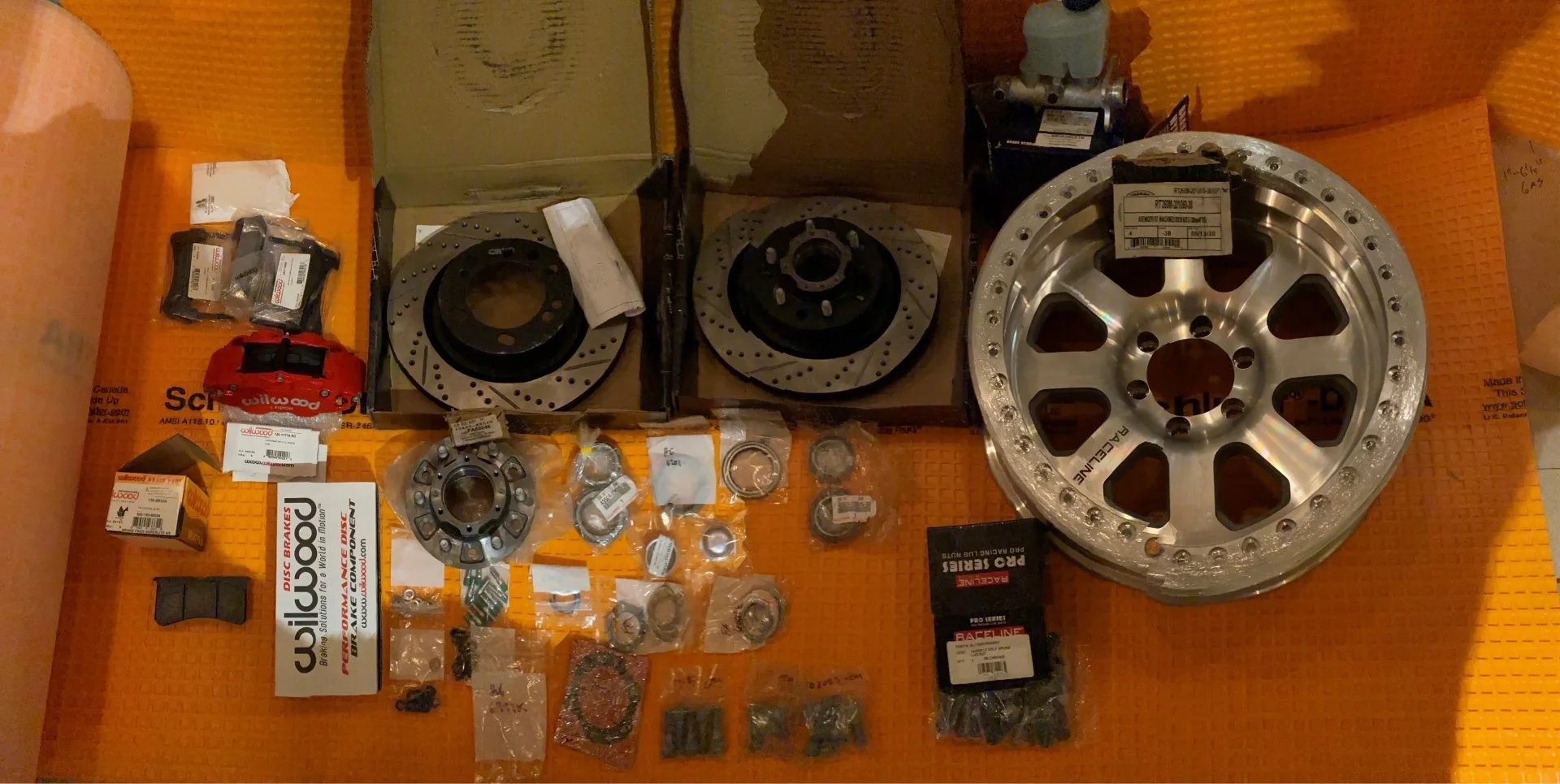

Stumbled across this thread here one day and I think its a great idea so dove in. I know everyone has their opinion on the 80 brakes but sorry they suck OEM... They sucked in the 90's they sucked more with 35's and they REALLY suck with 149lb 37's and 20 years of use. The next suck to remove will be the LSPV and ultimately the ABS suck too, keep fighting this but will eventually give.
Great effort for Koala for the idea and Ilean for the fab work and feedback (perfect fit being near cruiser outfitters). Sorry if I stepped in and killed the thread but felt it took it to the next level and continued off what they came up with. Again, I take it to the not for everyone concept... I just added Tundra 14" rotors and 2 pistons to the calipers, they really aren't all that big and thinking close to size of the 4runner OEM.
Note: 18's will be the smallest confirmed wheel to work, 17's might. Of course if going 4runner OEM calipers 17's are fine and a super budget friendly option if you need to PM these items anyway.
LOTS OF PARTS! Not all necessary. MC yet to be used and will not be necessary. Thinking I may go hydraulic even. hub parts unnecessary but a while in there thing to me so :meh:
Most info is in the link so wont ramble on here. Lining things up and fitting it all together. Came together with surprisingly easy effort. Cost was another thing but worth every penny IMO.
Crappy pic but brakes final here and moving on to suspension. Note the surface contact area. Calipers are spec'd for 14's which the tundra are but note the inner ring on the face of the rotor not making contact. Pads were also small to me but overall I think its in the piston count.
Note the rotor placement outside the hub and the ability to 100% service the brakes with no hub removal! It's likely you need to service the hubs when you do the brakes anyway but oh well lol. No more pulling the hub, dealing with the grease, all the motions to pull the rotor, fish scale if that's your thing, loose bearing after the fact and so on. Pads are also one nut now. Calipers still two bolts.

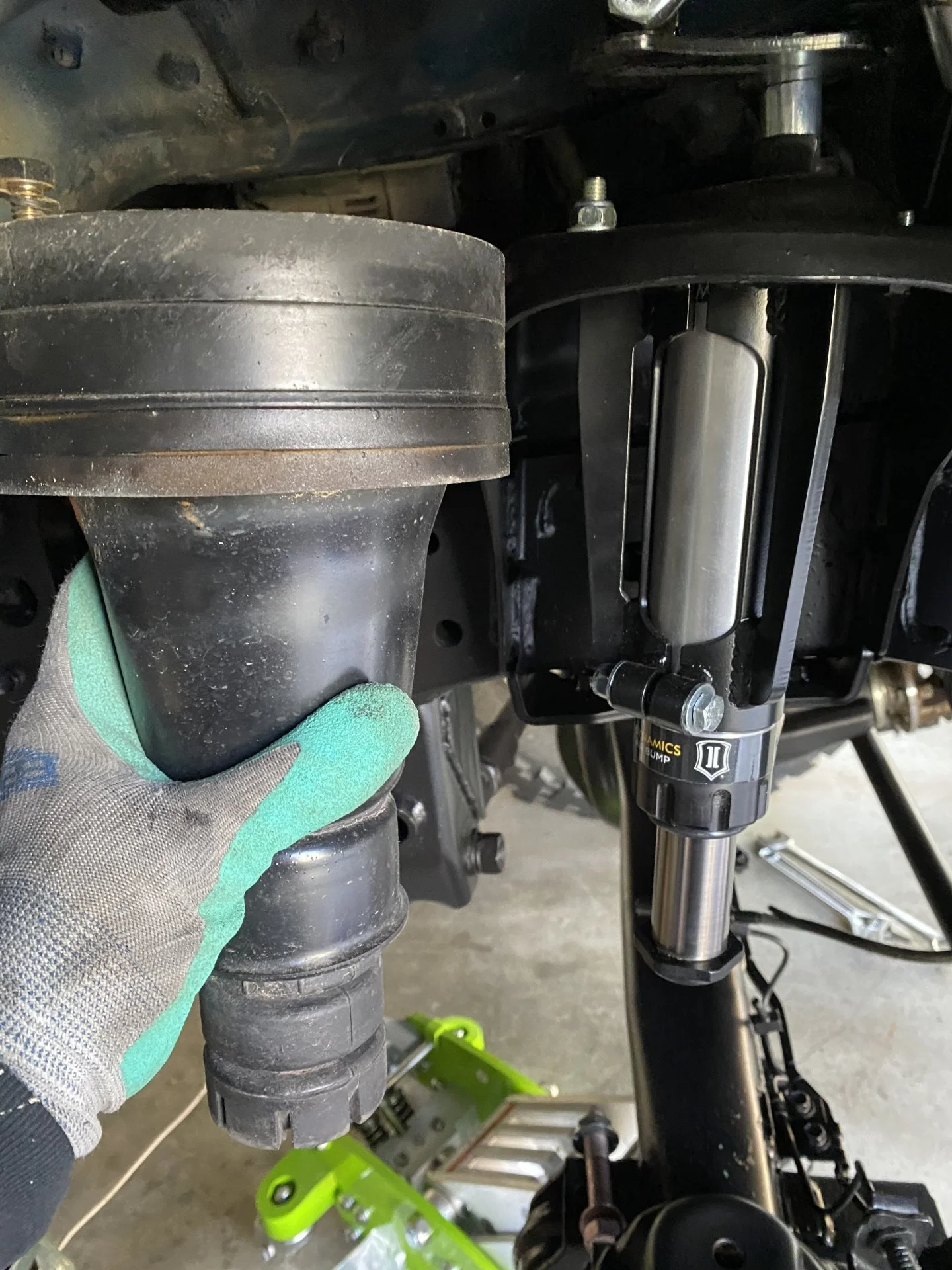

Continuing the prep for the springs, we next have the Delta 4” arms and Dobinson 6” MRR front shocks.
Arms, straight forward and no surprises here. Opted for new bolts just because. Initial comparison, they are not too much off from my old SLEE. I was hoping for a little additional length on these for the 37 clearance but not seeing it. With that said I expect some continued fender rubbing. May hold out and hope for some extended 4” arms from Delta. We will see, for now I wait and make that call after springs in.
I didn’t get good clear OME compression/ extension specs so will check the right side and edit comparison. These old were on a 3.5” lift I had. MAN, these Dobinson’s are some stiff SOB’s!! OME I can easily move in/ out, I must need my Wheaties or something!! I couldn’t budge these things. Figured this up front and thankfully lined and prepped for this.
Measurements:
Dobinson shock/ spring perch:
Static (3.5” lift est.)-26”(pre settle)/19”
Compressed-21”/ 12 ¾”
Extended-30 ½”/ 23”
Compressed spring, I see bump stop just touching, IF 2.5” travel I assume I need to add spacers to the BS and adjust out 2.5”?

Couple takeaways on this:
  • I realize these shocks are for multi vehicles but man the instructions suck. I would say it seems like a lot of confusion of washer and busing order when released and they cleared this up but, nothing on the reservoir mounting at all…
  • After checking several pictures I realized the reservoir mounting must have changed many times, started on the left side and because of the steering shaft cover it’s not a flat surface. Lots of parts for mounting but none just worked and a couple odd holes to each mount but not L/R clearly marked. Opted to pull back as flush as possible to the fender for tire clearance. Took the long bolt, lined up with OEM and cut to factor in the spacer provided and cut it for the outside bolt for the cover to the steering link(inside hit fender and clearly not intended to go here). Assuming this long bolt is for the OEM spring perch and why so long as it would work ok on it?
  • Same shock(I hope) L/R different reservoir mounts as mentioned but they did not flip the reservoir sticker…. Small things, but it’s upside down. Another pause to check which I installed, both the same. All pictures installed were the left , not the right. Maybe to avoid being called out for mounting upside down? LOL.
  • Cut the spring retainer with bolt cutters and it worked pretty damn good, Had bushing and washers lined up and she popped right in the bottom hole. Shew, dust cover got stuck in the bushing but I wanted to cut them off anyway, so did…
  • No torque specs or any info on the mounting nuts. Tightened until it stopped and the bushing looked right

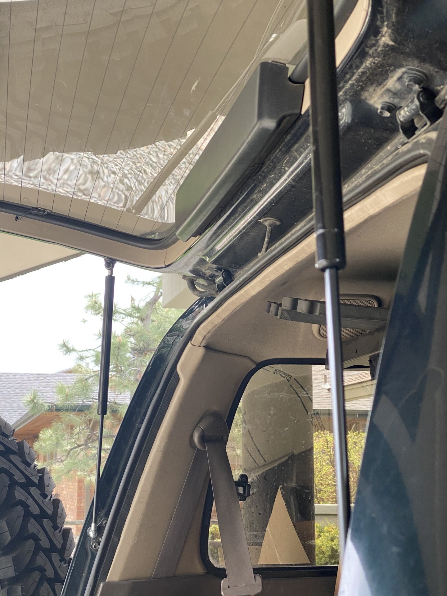

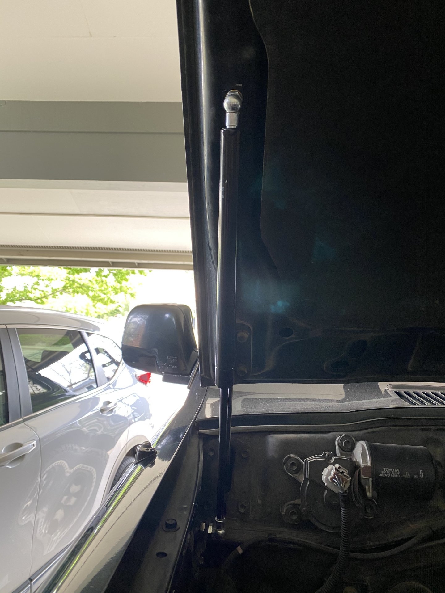

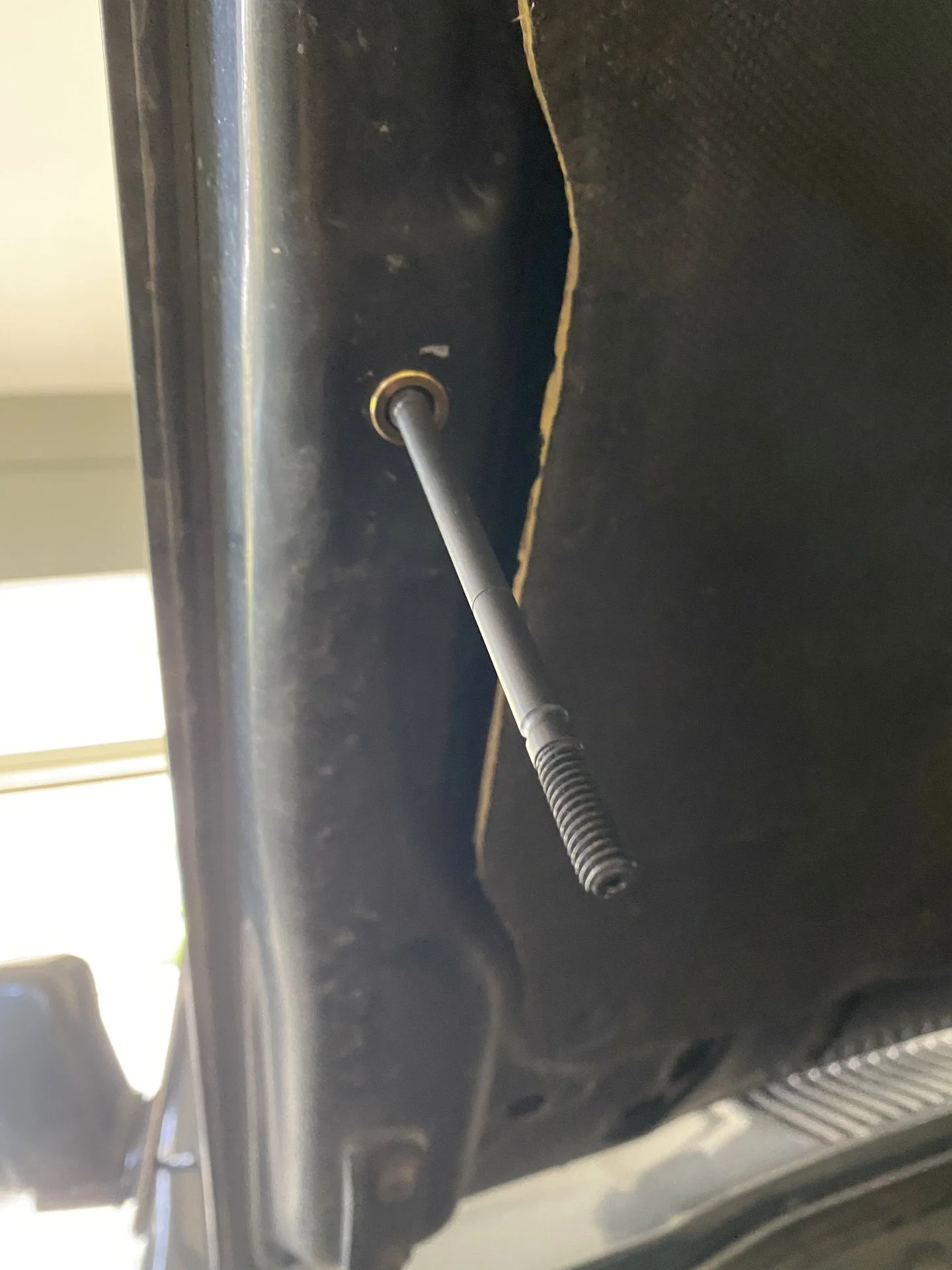

Finally got in my rivnut crimper attachment for the larger nutsert to finish the hood. Was able to ditch the 2x4. Had these struts for a while off a post here purchased from McMaster Carr. Come to find out there is a direct fit now but had them so, on they go.
Suckers really push the hatch and hood up there. May need to bolt on a limiter strap or strap to pull down once the lift is complete...

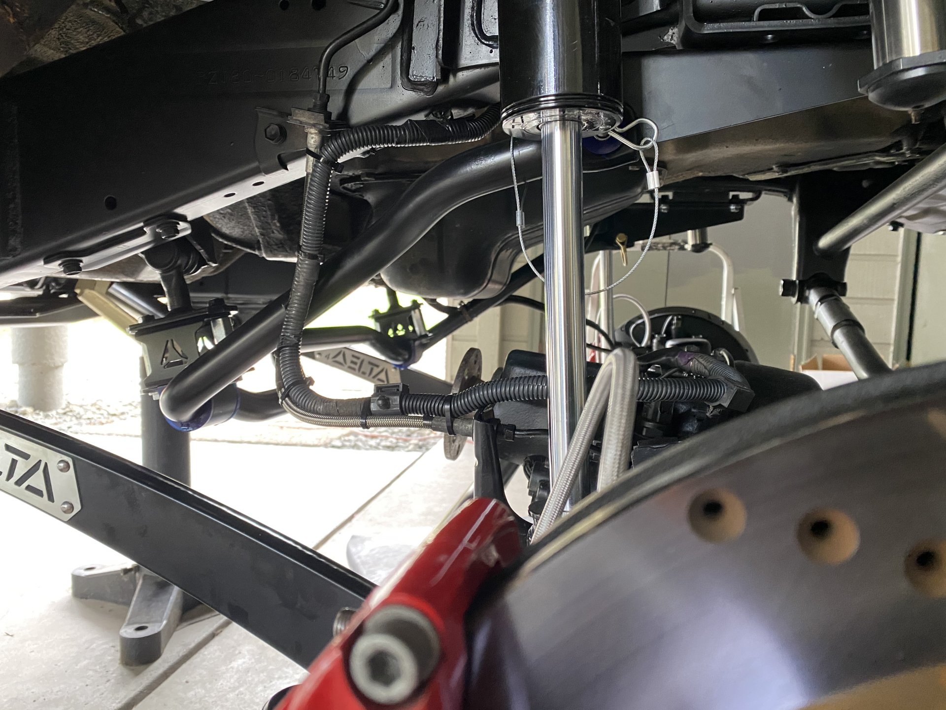

Front 30mm super pro sway bar on, accessories include LCP front disconnects and delta drop brackets. Both work well but you can tell when installing, neither designed for this 30mm sway bar and mounts. SB will remain disconnected and mounted up until land tank mounts welded in.
Rinse and repeat... passenger side buttoned up on the spring perch, bump stop, Wilwood caliper spacers, and Dobinson shocks.
Went back to the driver side after noticing some anti spin bushings and washers left out on the top side, also removed the spacer I modified and set below the steering shaft guard. Neither in instructions or drawings but made sense after letting it soak in, I’m slow.. Pretty easy after realizing I could drop the front end way down to unseat the shocks. Still some beefy SOB’s. Set both R/H/L shock settings to clicks recommended by the manufacture to medium heavy.

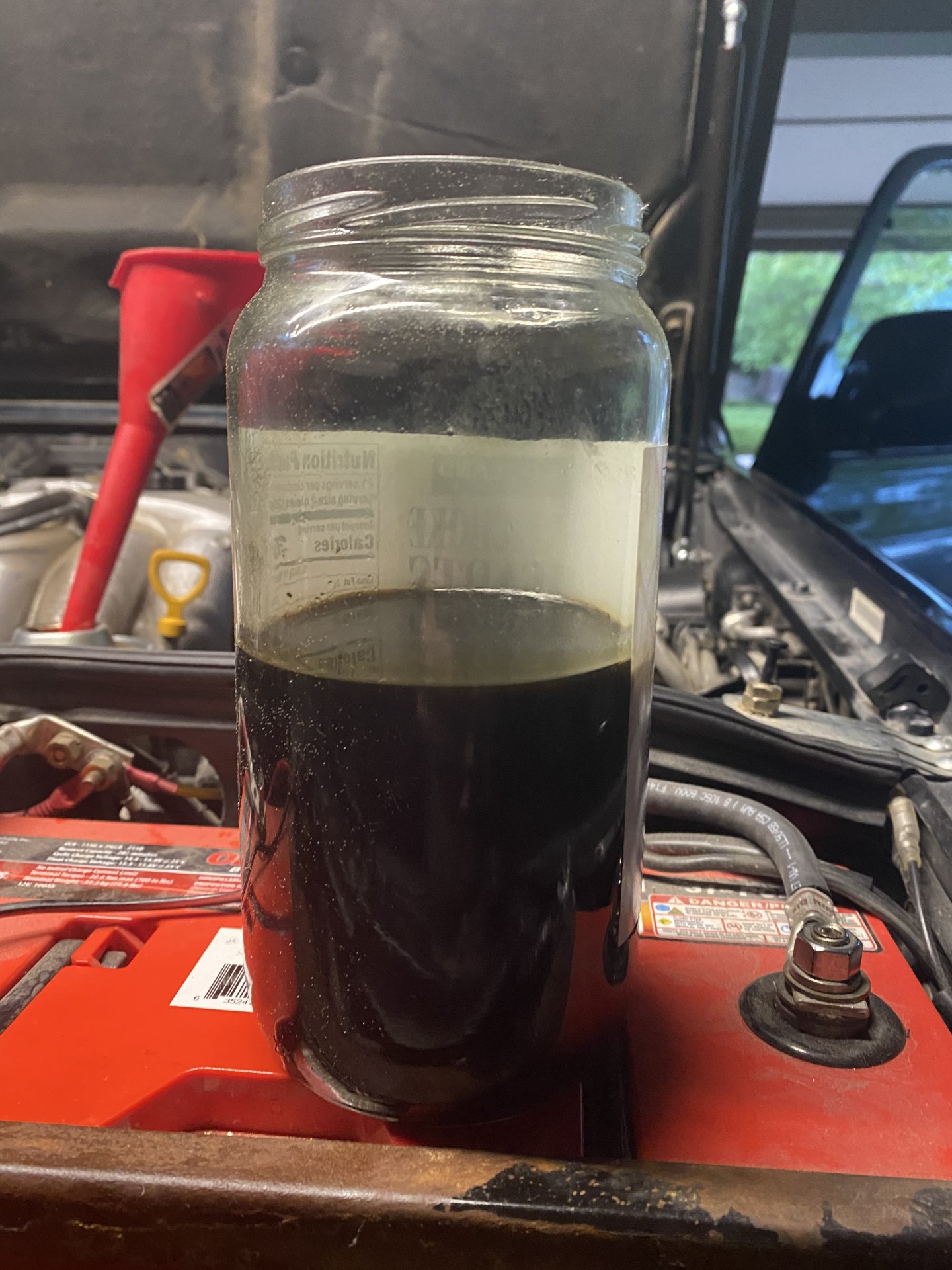

Sounds like my neglect to service and change the PS fluid resulted in bad steering box bearings. Apparently a rare thing. Had to order from UAE. With that said, decided to strap gallon freezer bags on the hoses where the SB attaches and start her up to flush the pump. Didn’t want the old fluid going thru the new rebuild 105 box. Good news is it started right up an idled better than I have heard in a long time. Success on the top end tune and gasket refresh.
Old
If you haven’t flushed yours, you should, ATF is cheap and with or without the steering box a super easy task.

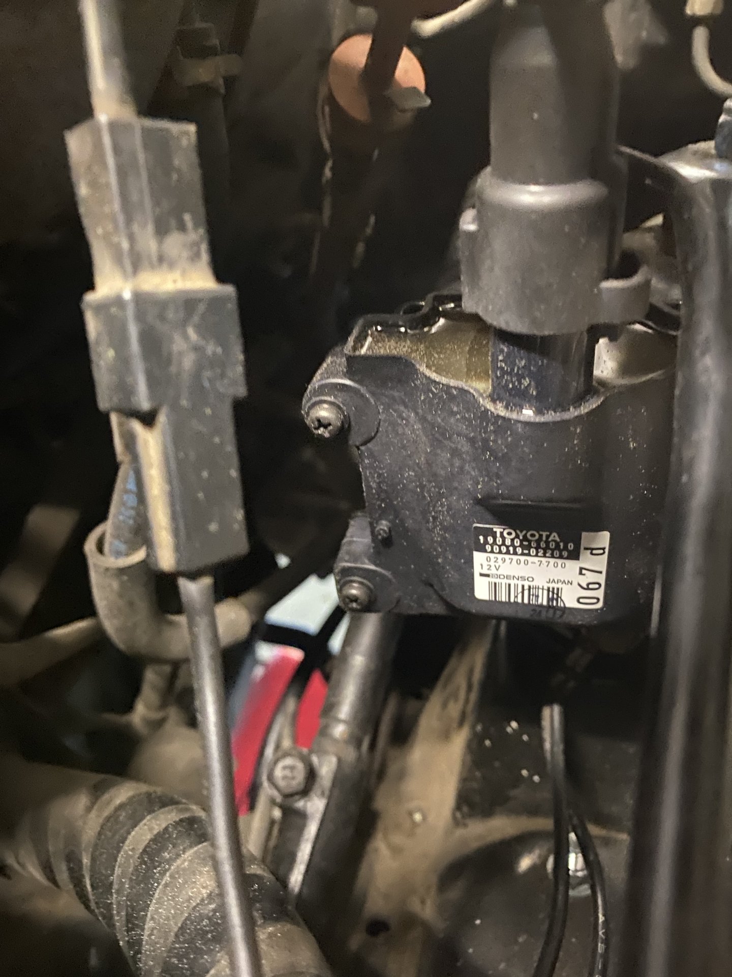

Somehow installing or pulling the old jacobs electronics ignition after it cooked some wires I broke one of the coil retainer tabs. For the cheap cost I chose to replace it for piece of mind.

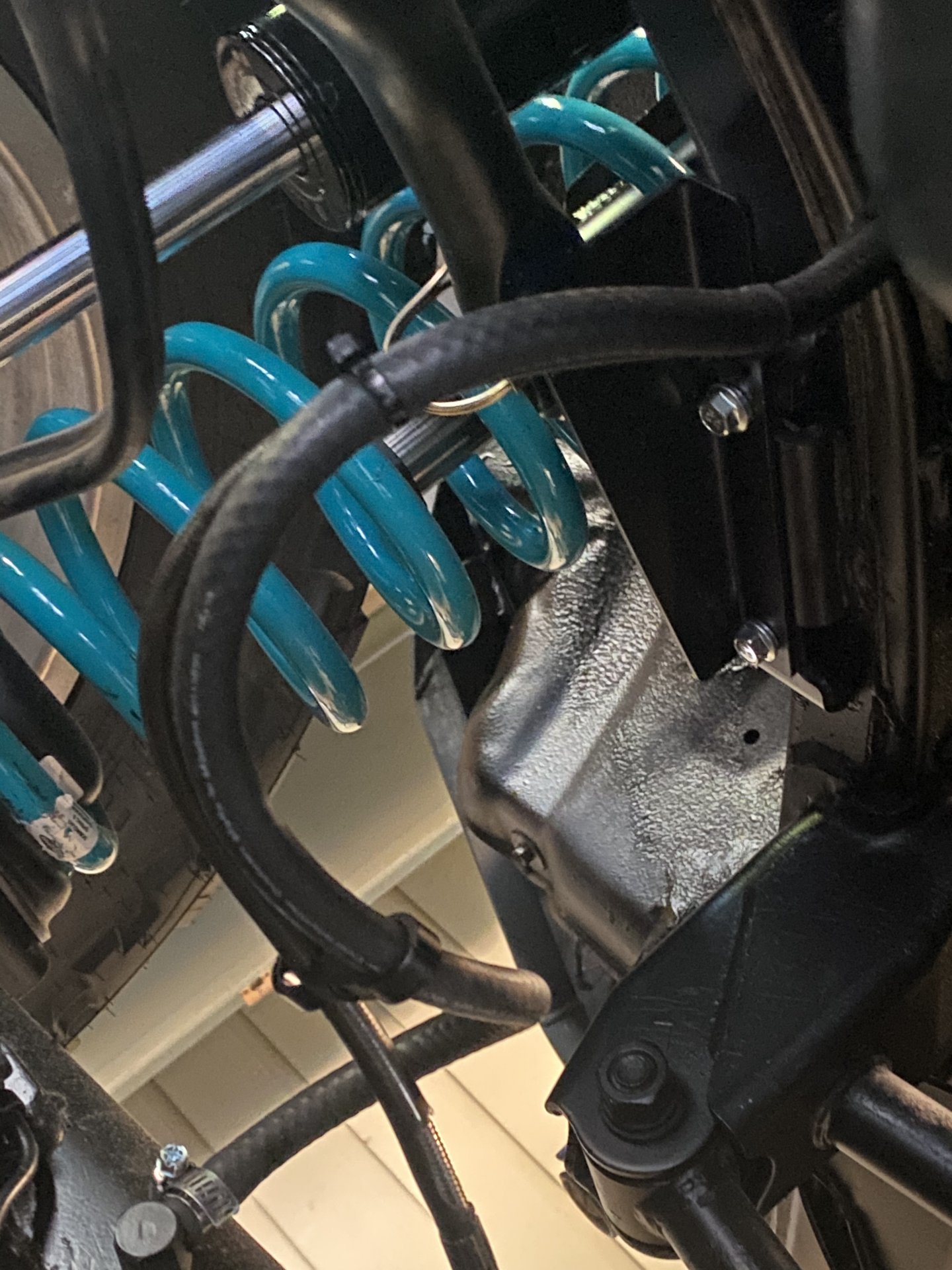

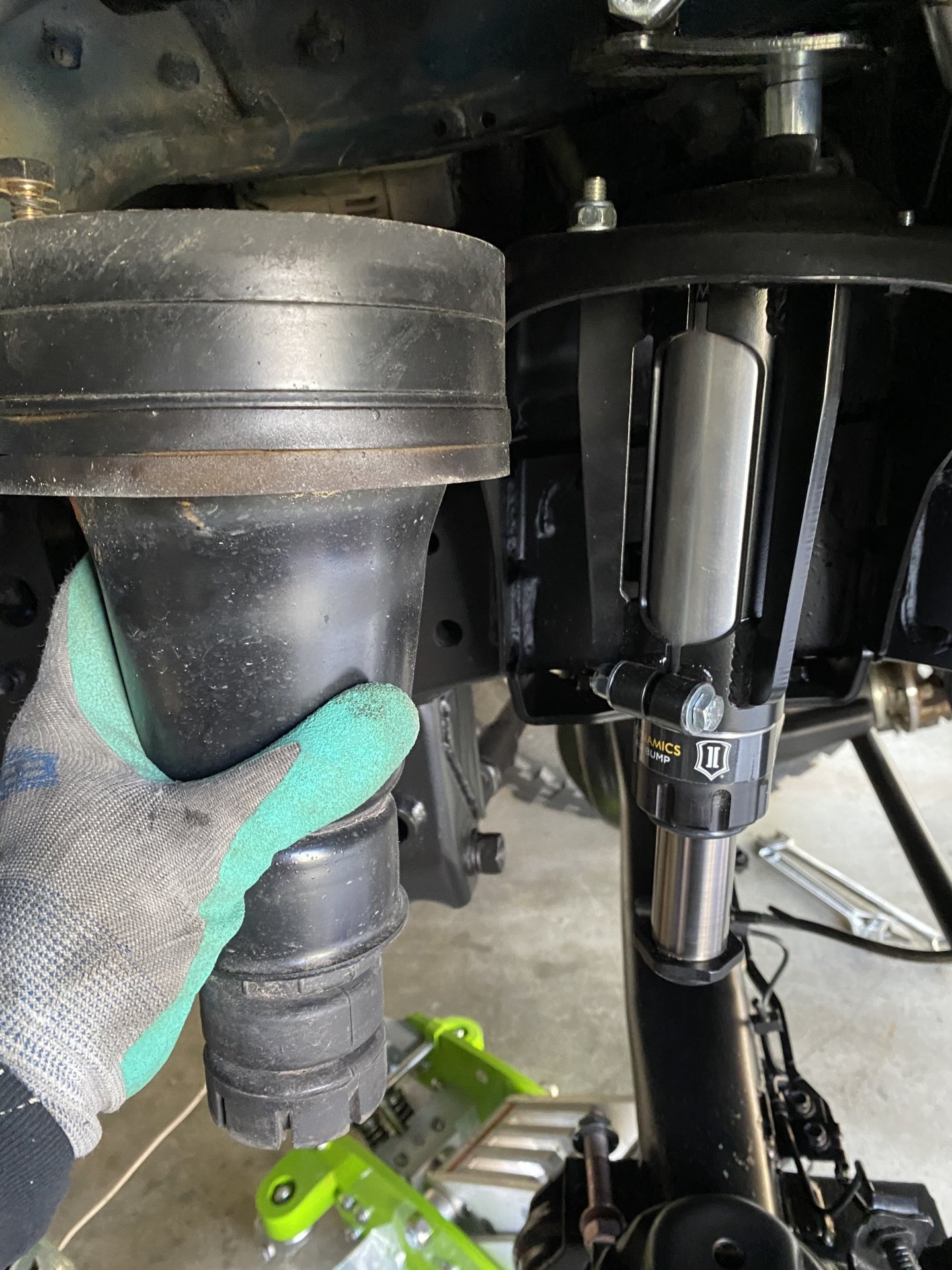

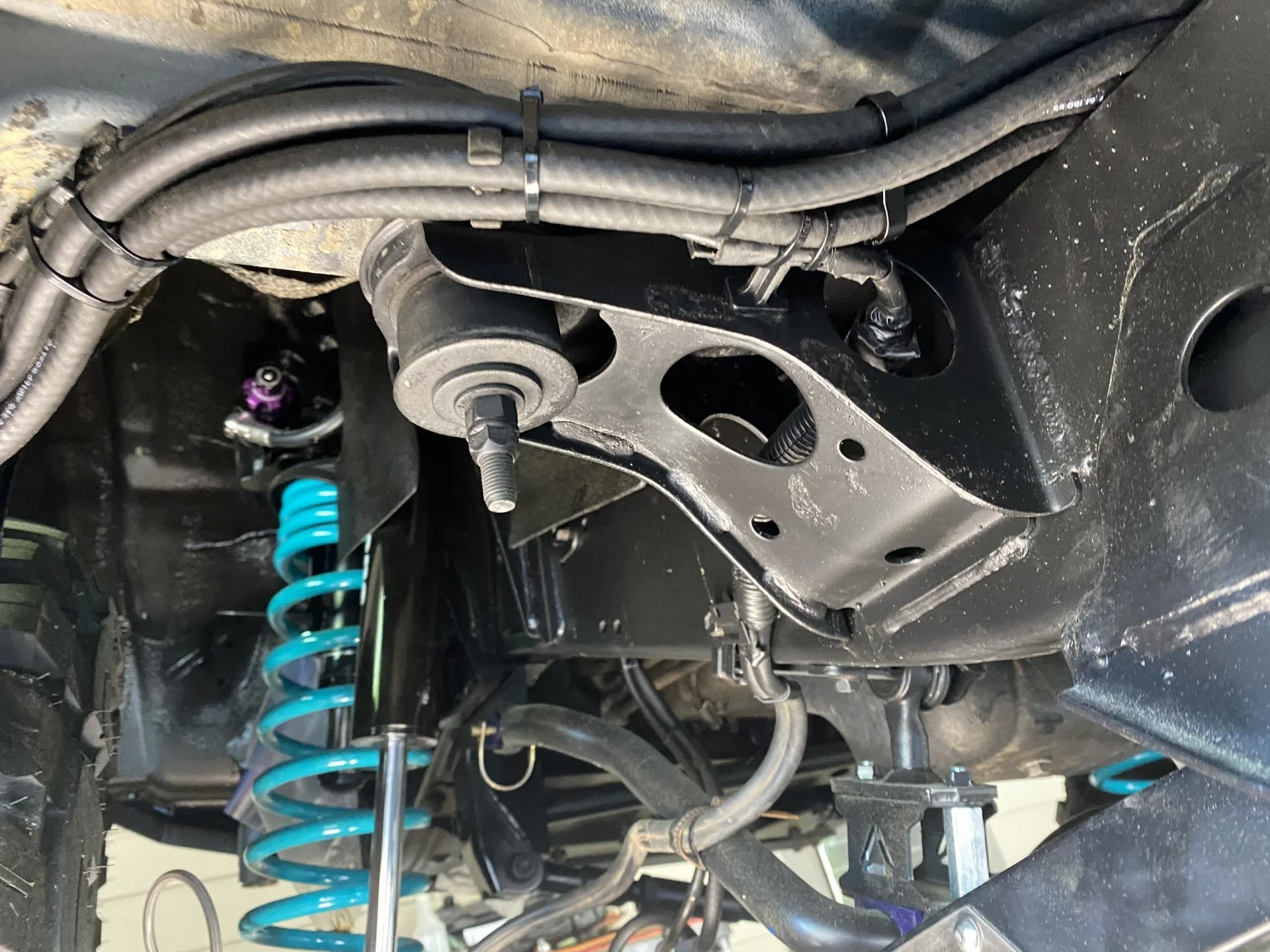

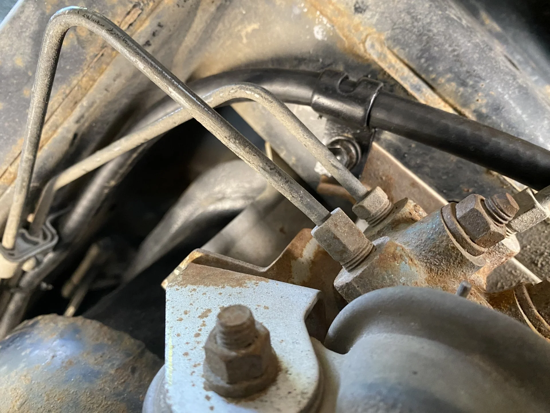

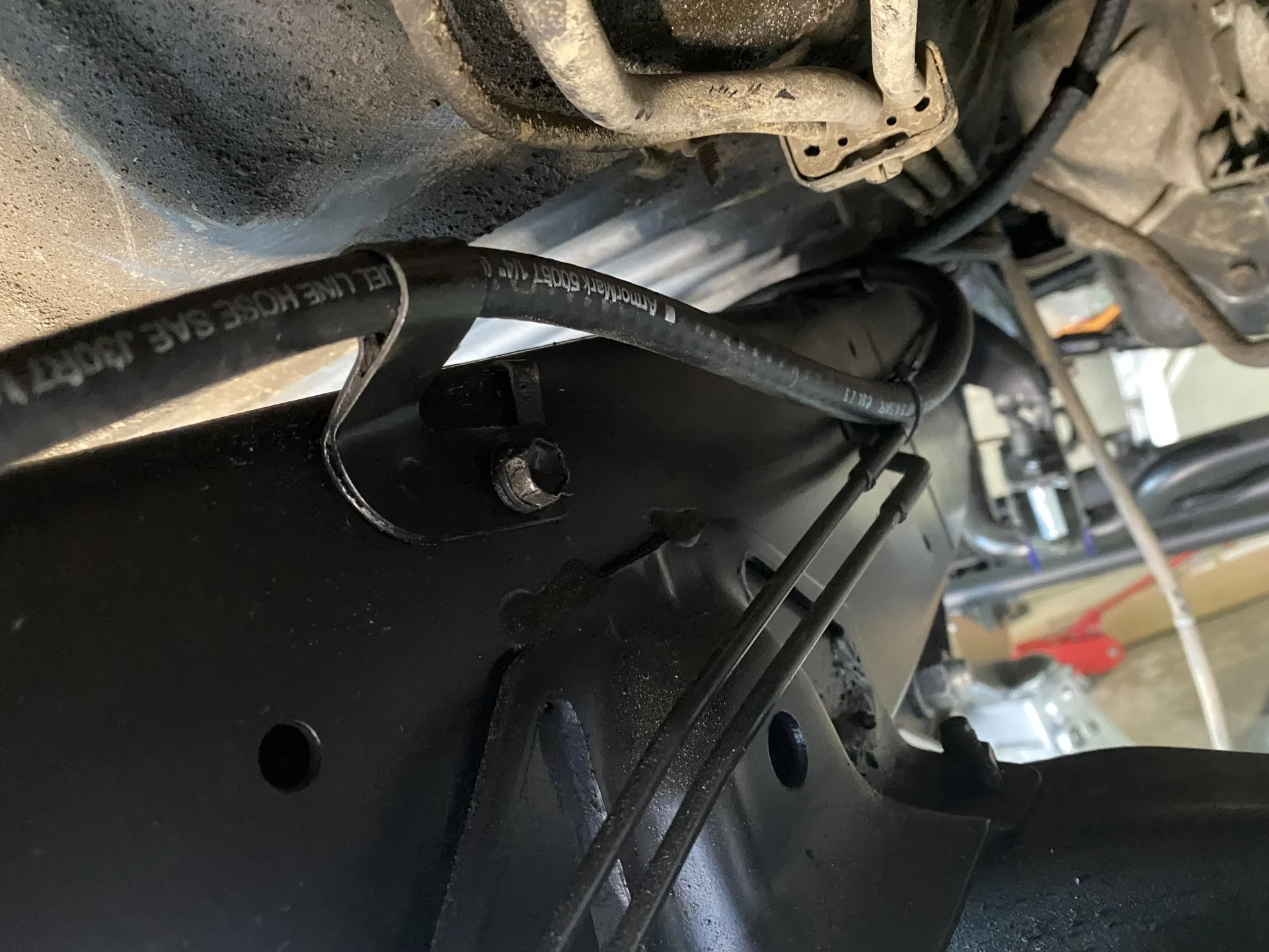

Moved on to breather hoses. Was looking at the ABR but isn’t like how you need to order the hose kits with the breathers and wanted 4 separate lines. One 4 port manifold later and some 1/2” breathers for the ends I went with mounting under where I have a Delta switch pro termination mount going. Went on the cheap and went the 1/4” fuel line.
One down and 3 to go. Decided to route up through the fender and into the engine compartment from the side to try to clean things up.
Need to figure some good clamps for the lines coming from the axle but seriously considering a ABS delete and re-routing the brake lines, Tried an amazon clamp to see how it does.

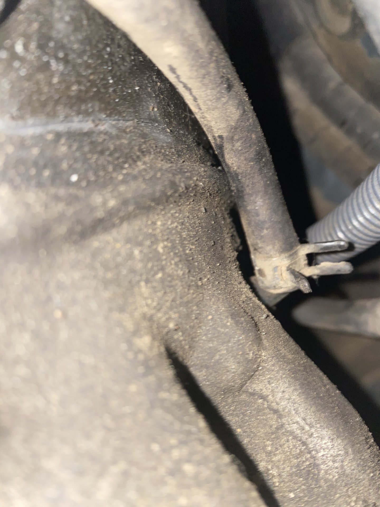

If you haven’t checked your transfer case breather and do river crossings, you should. One of the few hoses I know of that was pretty far gone. Next the tranny line, once I figure how to get to in, Transfer and ultimately the rear diff I hope by next weekend along wit the entire back underside of the 80.
All 4 breather hoses removed, re-routed to the 4 port manifold in the engine bay. both sides of the transfer case smaller T break off hose rotted and hanging off. Outside that all were in ok condition minus not breathing well. Diff's were easy but the tranny and T case sucked. close second to the PHH.... Probably should have combined to 2 before bring up to the bay but all good. Fricken pollen is dumping off the trees lol. All this cleanup and everything is dusted green...
happy with the route but need to maybe get it in some split loom.
reused some of the old brackets for the rear tubing. If I ever get to a pull and pay I would remove a bunch of these mounts. Super useful, especially the older 80's with odd mounting.

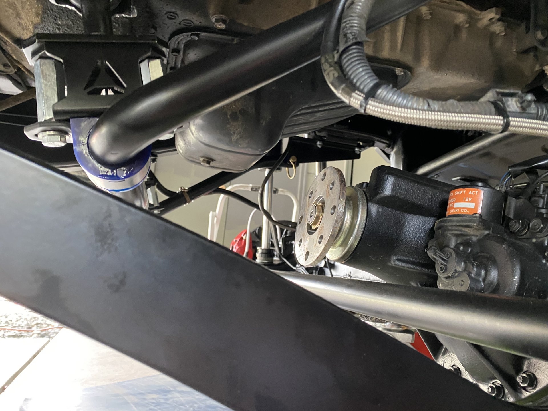

Pretty happy with results up front so far. Gone through just about everything up front but the motor(minus leaks and long overdue PM). Trying to avoid it and get by for a rebuild or most likely a gen 5 LT and 8 speed. This will be the goal.
- installed front SLEE DC shaft.
- Had the front DS wheel off and for some reason decided to do the wit's end PHH kit, sucked but done. Cut the middle mount off and pulled the bolt after. It's staying off.... broke the heater valve while removing the upper hose. ordered a new one. Was pretty crispy and brittle.

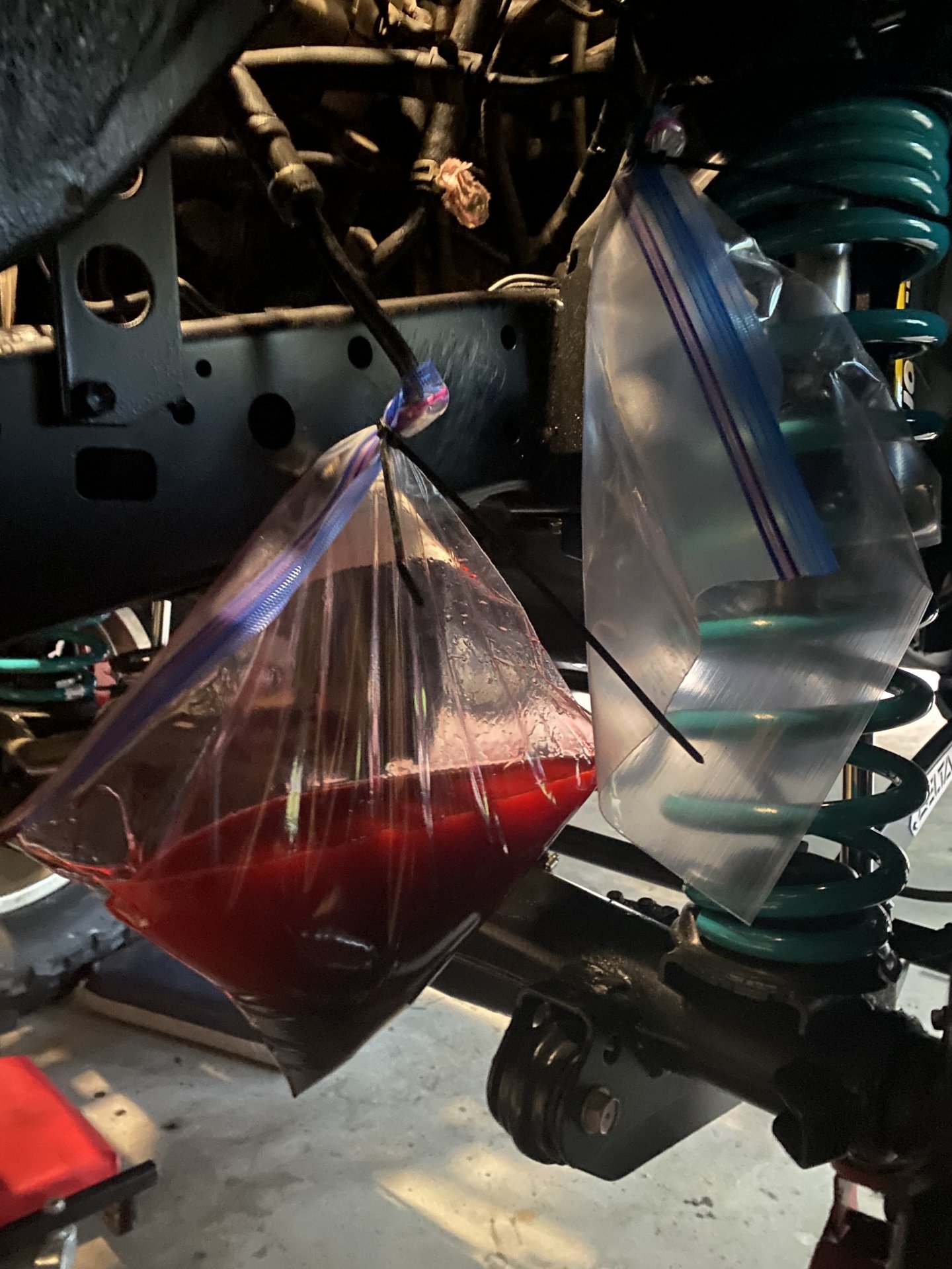

- flushed the coolant. Overall ok but will flush a few more times once I get oil back in the motor.
- drained the engine oil. Still waiting for the Rotella to show...

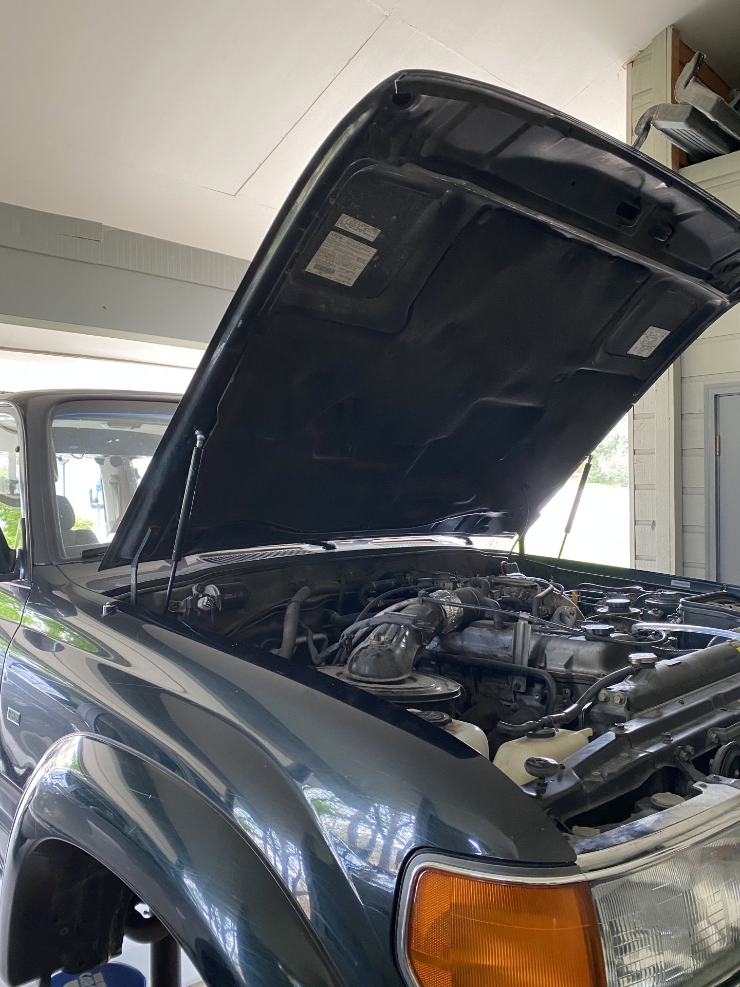

So much potential for additional engine bay air flow in here... All blocked with an ugly ass orange marker.
