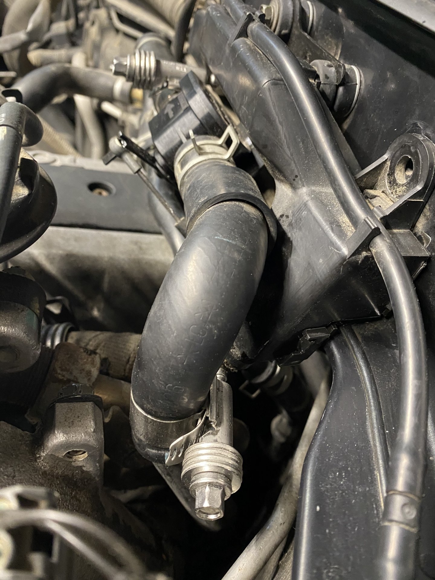

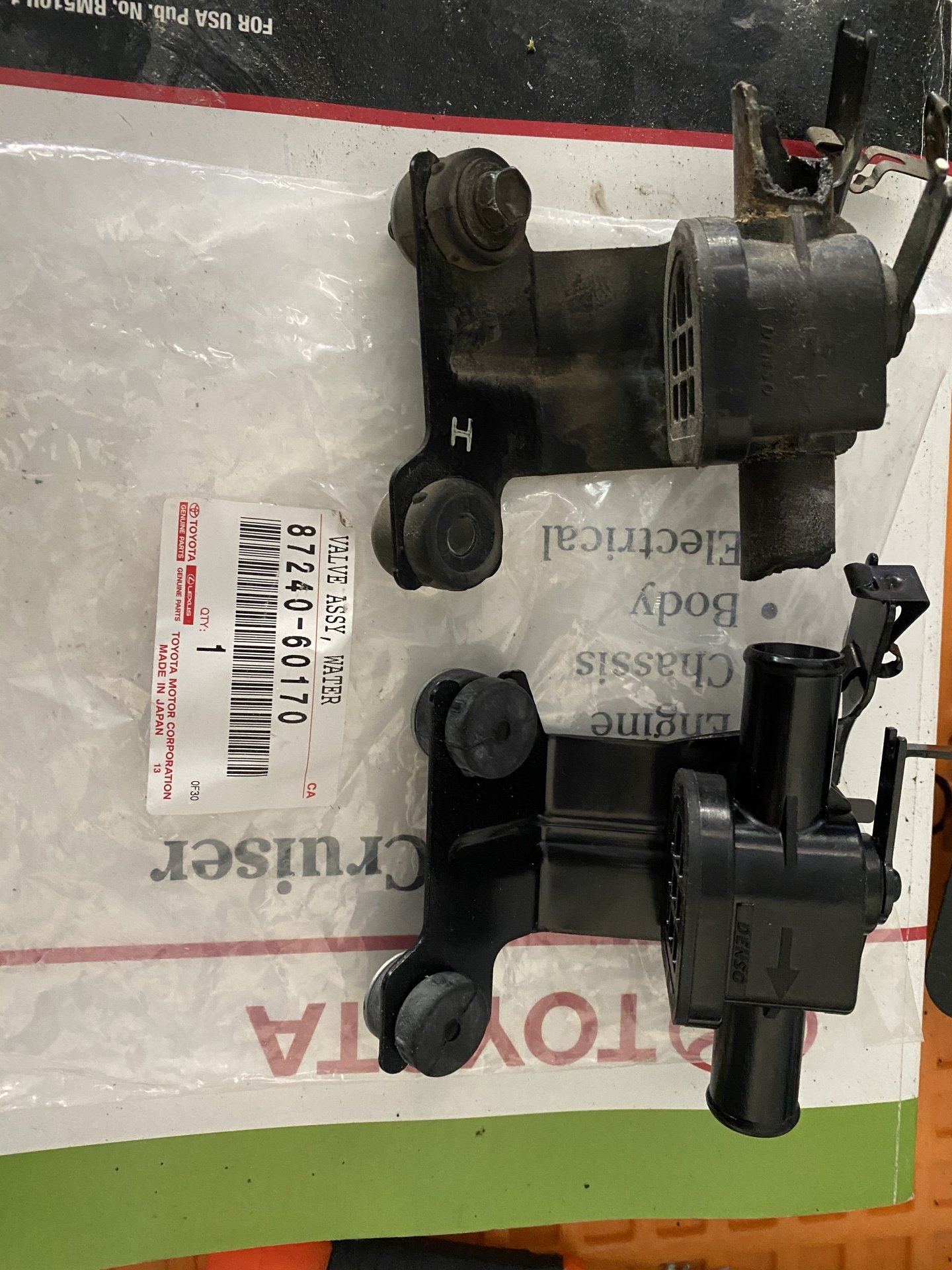

- another part came super fast from UAE. Heater valve swapped out.

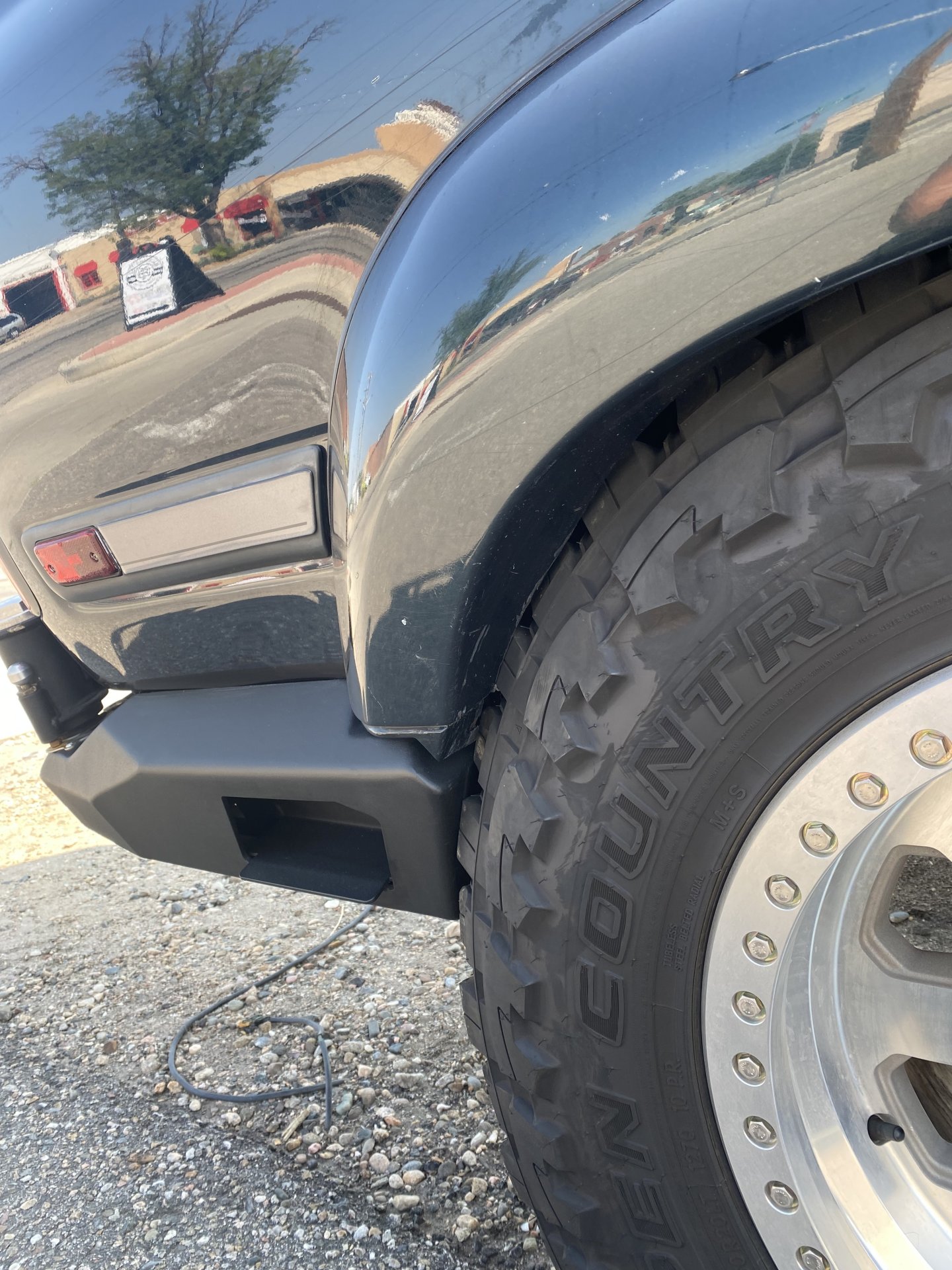

Always hated the orange marker lights. Tried EBAY knockoff’s years ago and they turned yellow and looked worse. Saw a member here post, I think Europe spec white marker OEM markers so going in for round two. Always heard they were discontinued here. Expecting these to be temp as I have different lights in mind but it’s likely years out and a lot of fab work.

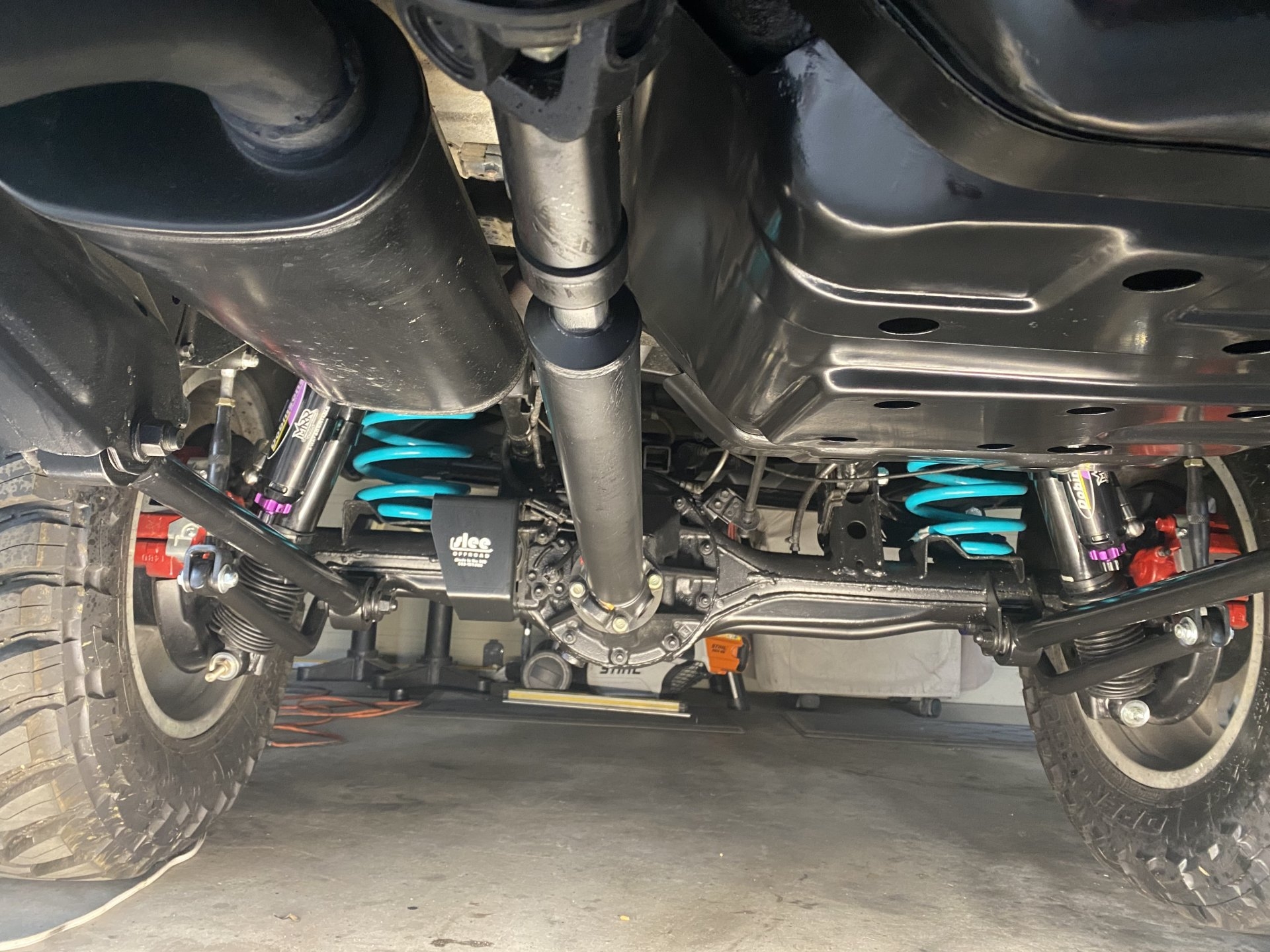

cleaned up the rear and added the Dobinson VT springs, Delta panhard relocate, adjusted the parking brake so it slows a bit but hardly what I would like to see, added new OEM calipers and painted red for now, to match the fronts until I can find a Wilwood rear solution. The rear adjustable panhard was a mofo to adjust, had to break out the pipe wrenched and torch, thinking I might have never painter the DIY bars when I put them back on. Landtank lower arms finally on. rear end far from as clean as the front but may yank the rearend and clean it up a bit better if/ when I do the calipers or LSVP. For now cleaned it up as well as possible and gave it a fresh coat of paint.

The rear cleaned up and all together. Just need to keep playing with the shock adjustments and check bump stop numbers and work on that. Front is adjusting the hydros down likely. Rear is TBD once I get some good numbers.

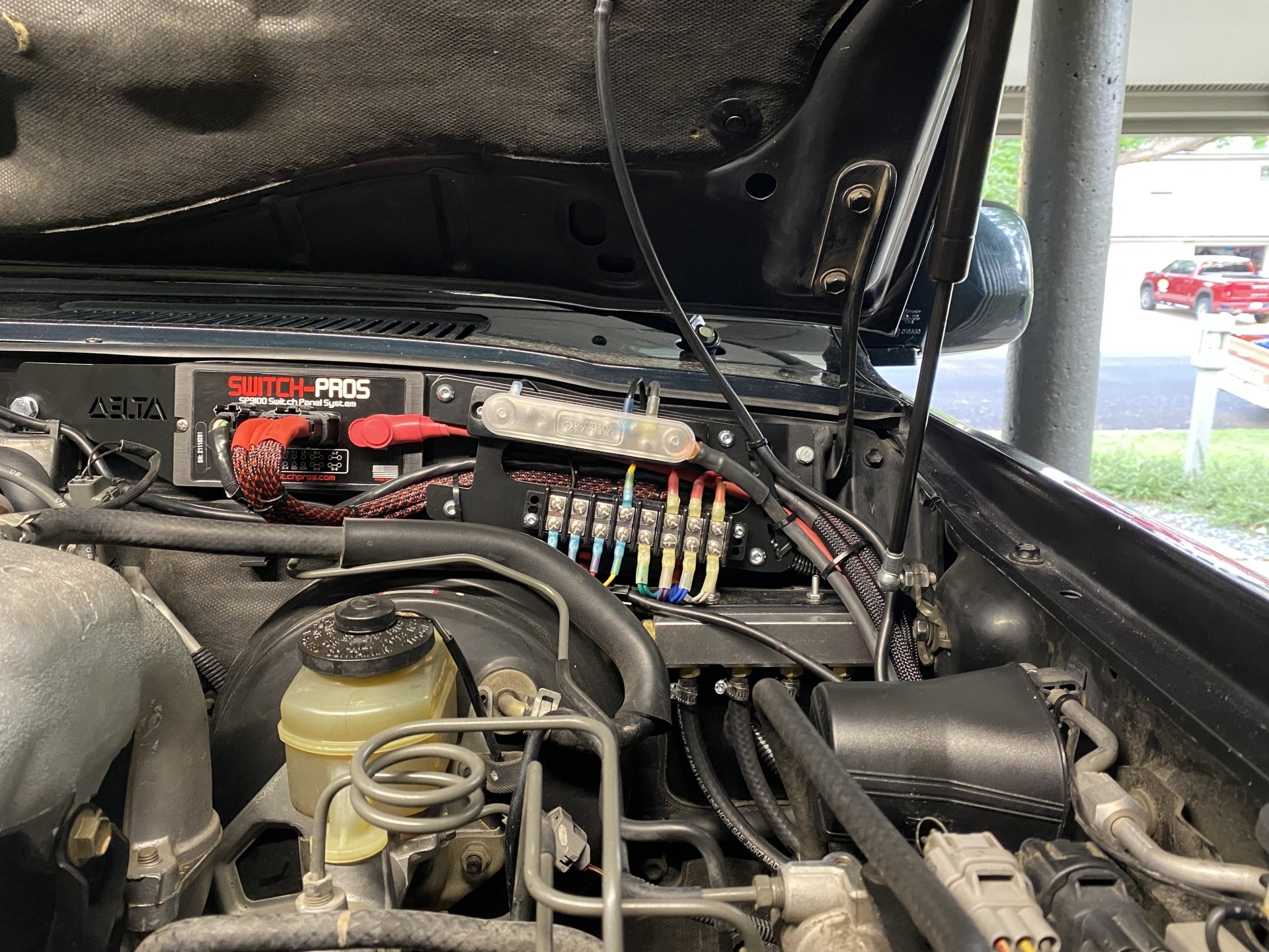

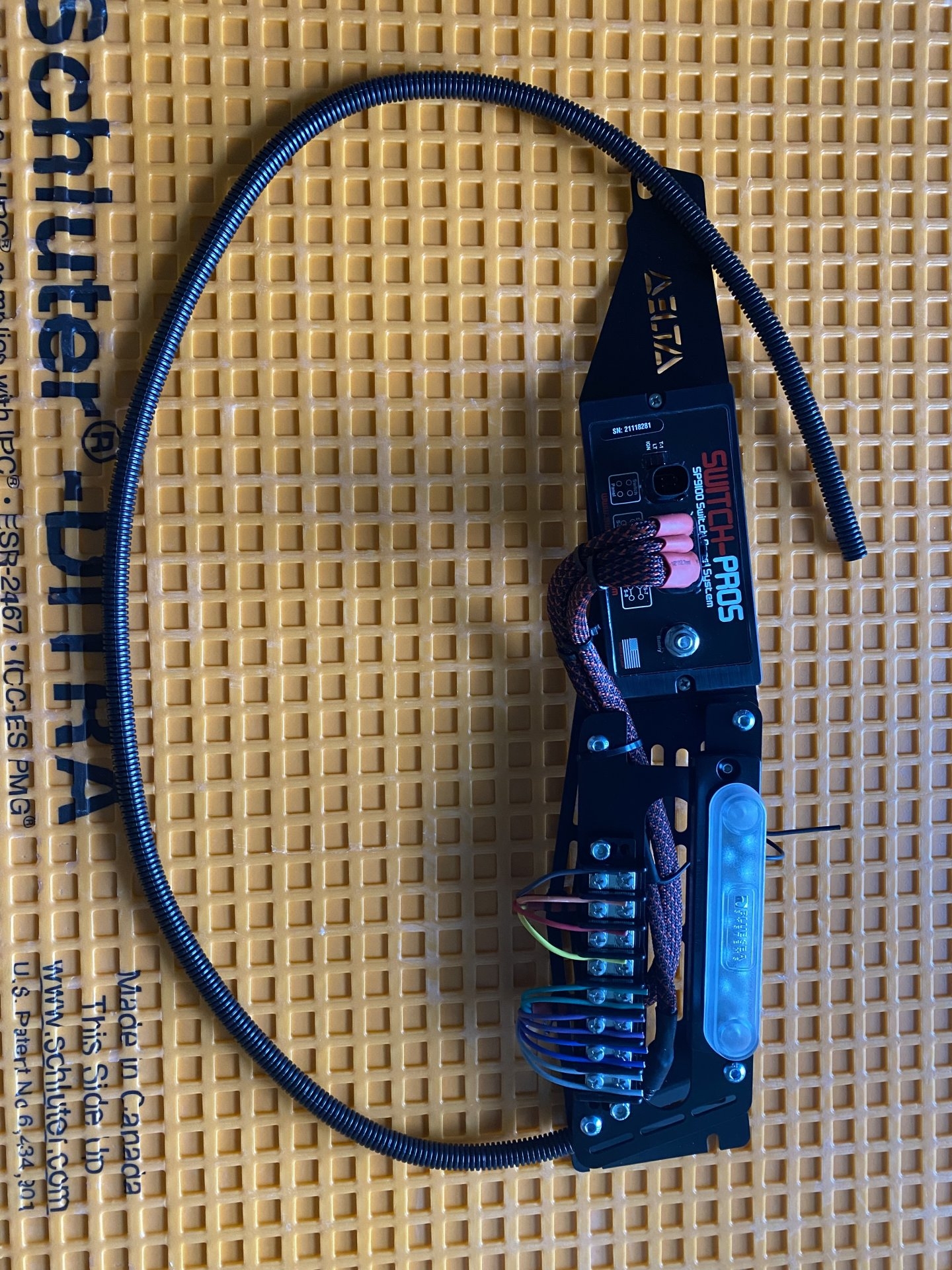

Decided to try the Delta switch pro firewall mount. It is above the engine but off to the cooler side. Spent a few hours prepping the wiring and assembling. For now I will go with the ash tray board mount Wit's end offers until I dive into the interior. A lot more prep going into this mount than I realized. should be a nice clean setup when done though.

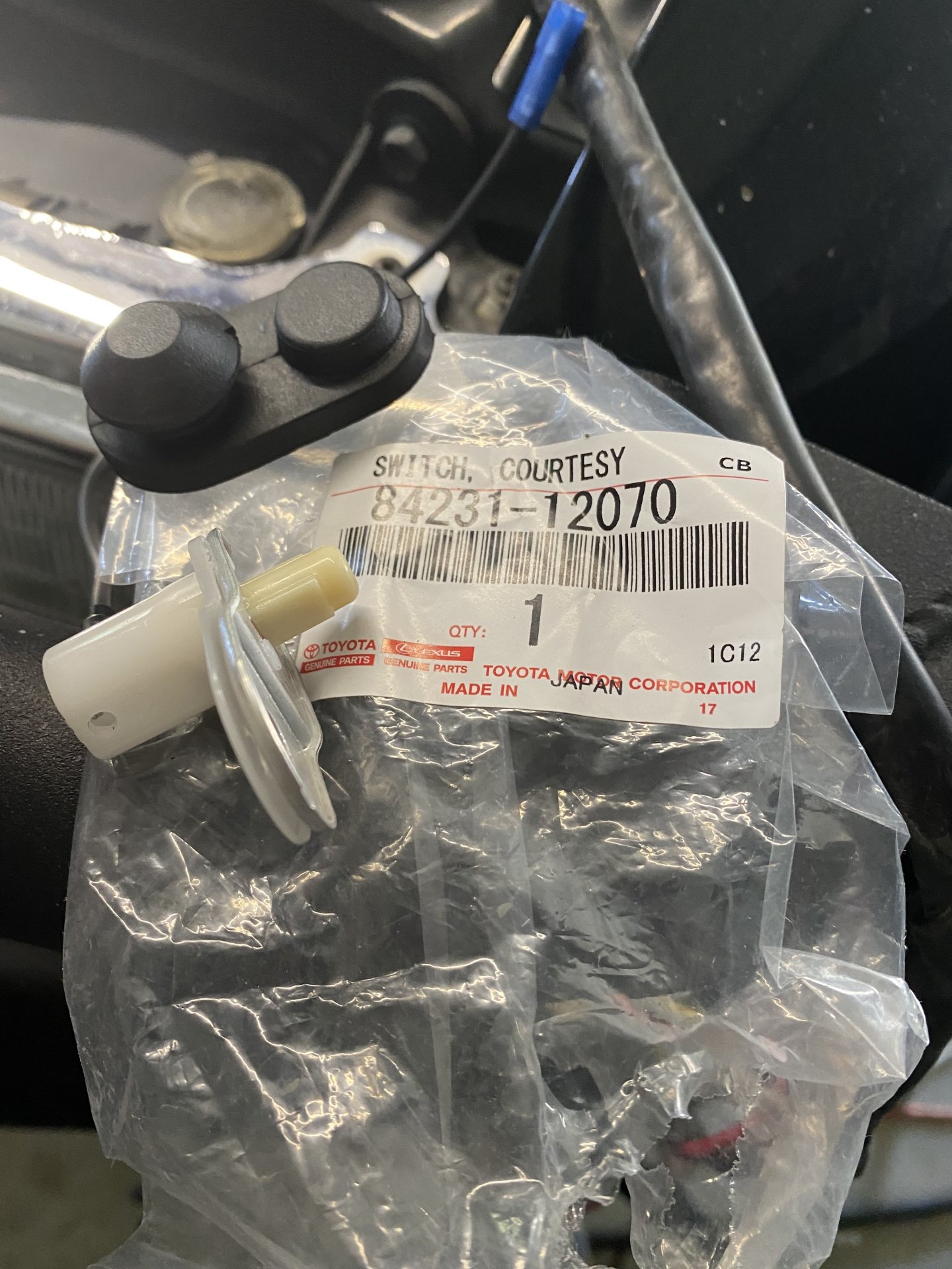

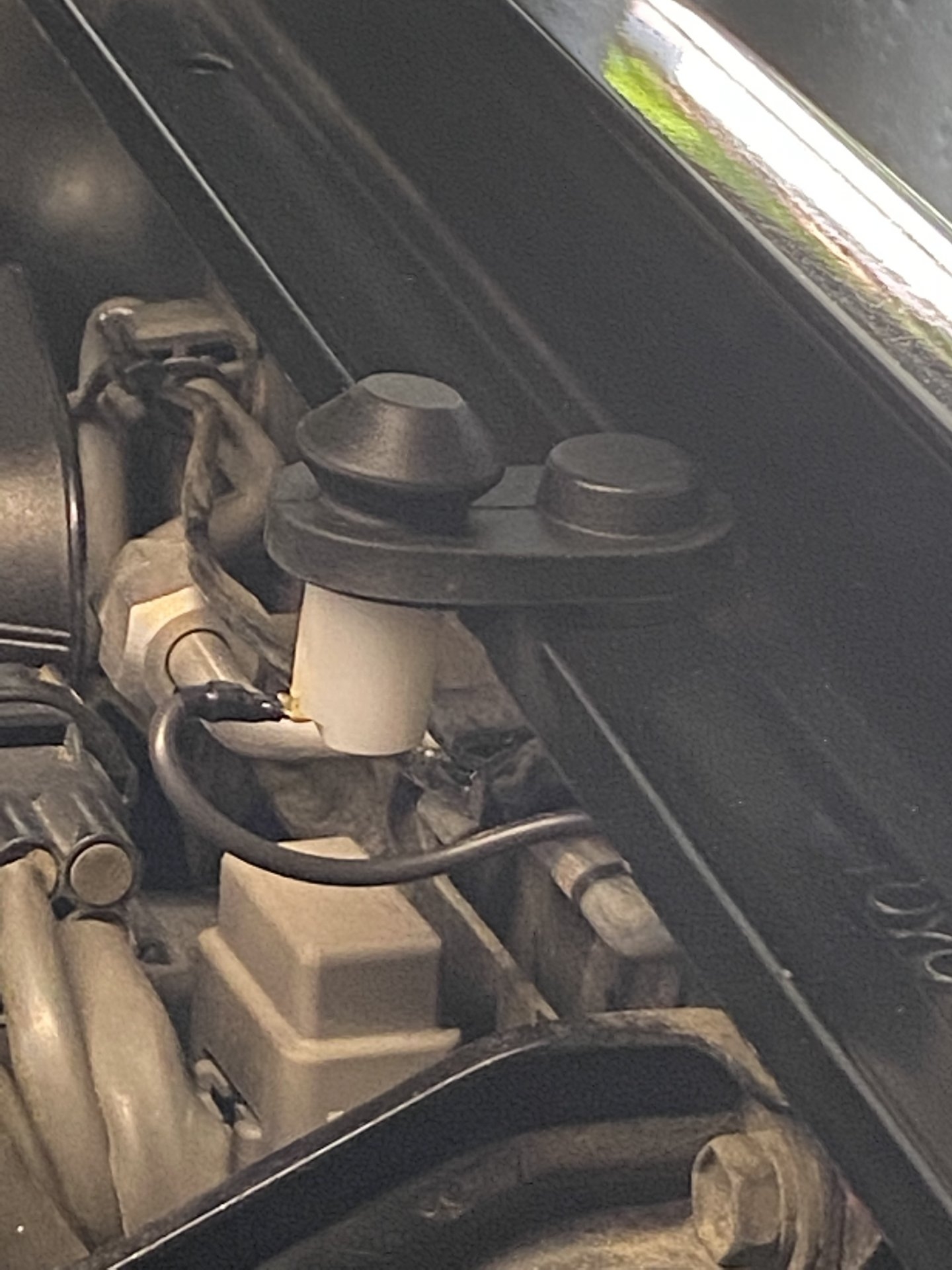

Saw another mud member add a (what I think was) door switch to the aftermarket alarm hood switch. Ordered one up to clean up the crappy switch they used. Used an existing bolt and trimmed and shimmed it up a bit. It's a simple ground disconnect switch. Worked perfect.
Switch pro in and fully wired, Still need to add stickers on the switch and program it but want to make sure I like where everything is laid out. Added the LP9's and squadron lights. The Delta mount works great and was well thought out. Lets hope the heat is a non issue. I believe the app monitors heat on the unit so I will watch it.

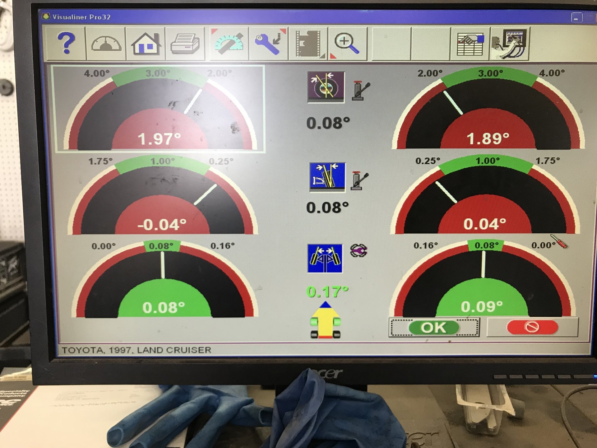

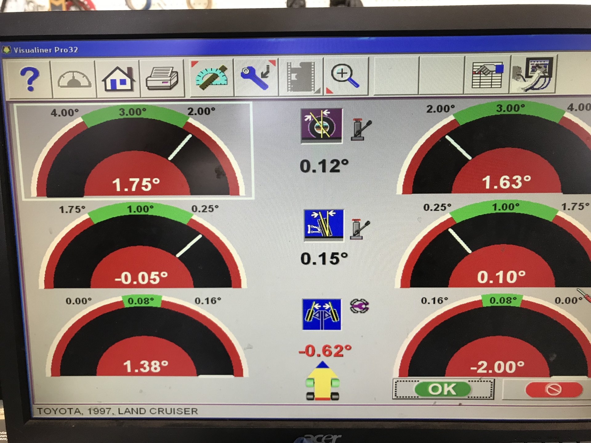

Got the alignment done Friday and unfortunately the Caster is looking out of spec a bit with the 144/145 VT combo. It also shows the right side worse which reflects the slightly higher lift I got somehow on that side I believe. Need to loosen up everything down under and re- torque. Reached out to Dave @Delta VS to see about swapping out the 4" arms to the new 5L arms they now released if it makes sense. Also, still have the inner fender front tire rub going on so this seems like the perfect fit. I have to weigh the 80 front/ rear yet to get final numbers but until something is done with the motor I'm about done upfront weight wise. The rears have a bit to go and I'm a little worried about the weight and the VT's. Suppose there is always SLEE down the road for the rears which seems to be a good solution.
before:
after:

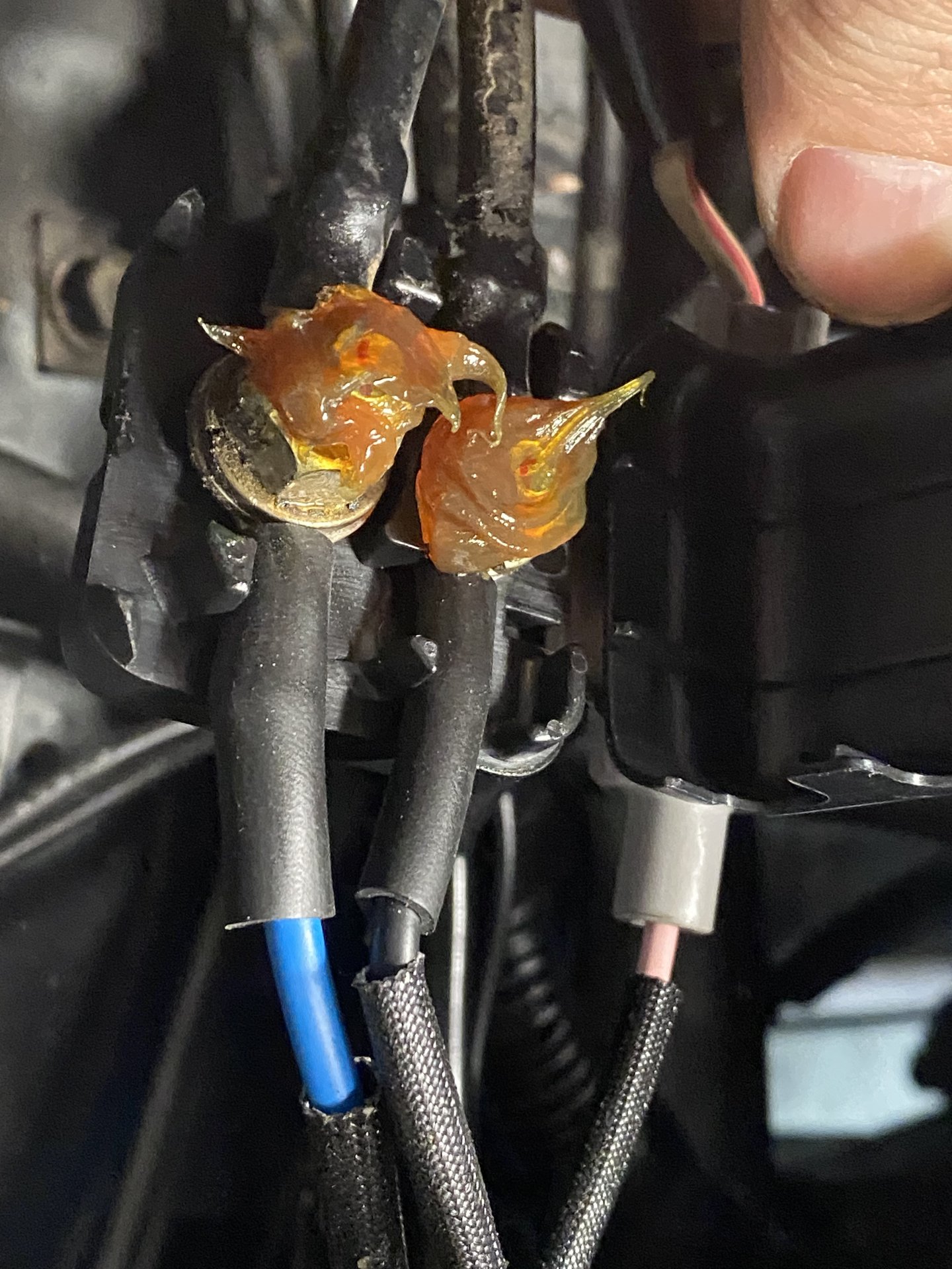

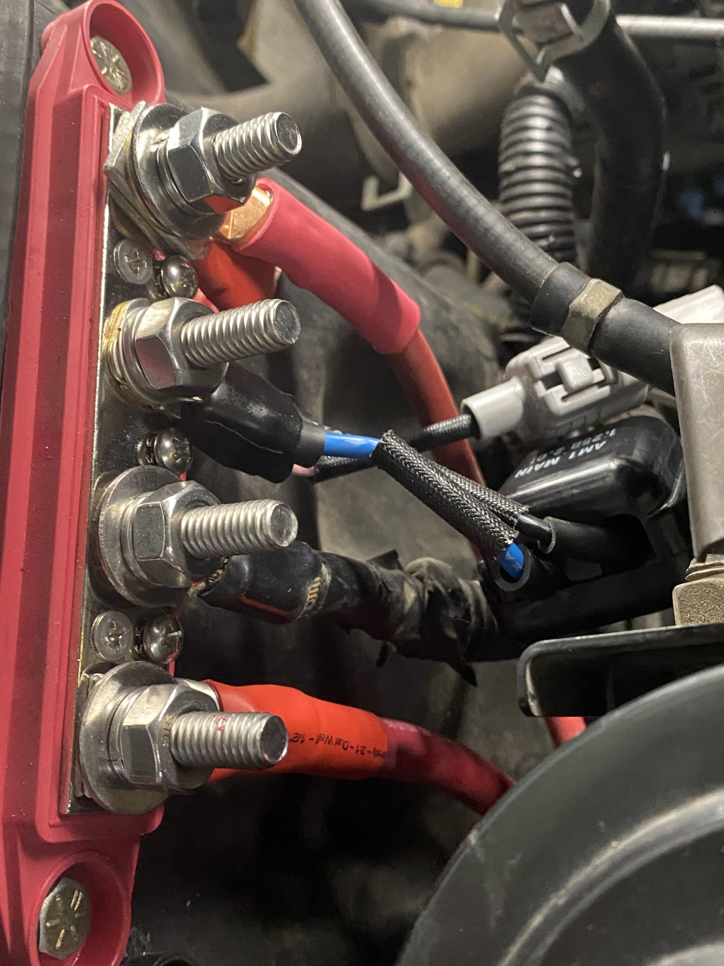

OEM fusible link not looking to bad but now a spare. Replaced with a new link, added no-ox and landed on the external bus I added.
Added one ram mount for the phone to the wit’s end mount, a new hardwired dual usb and iPhone chargers. Mount works ok so will likely order the second. Much cleaner wiring than cigarette lighter charger. Wired to the switch-pros and set to battery to operate manually when I want.

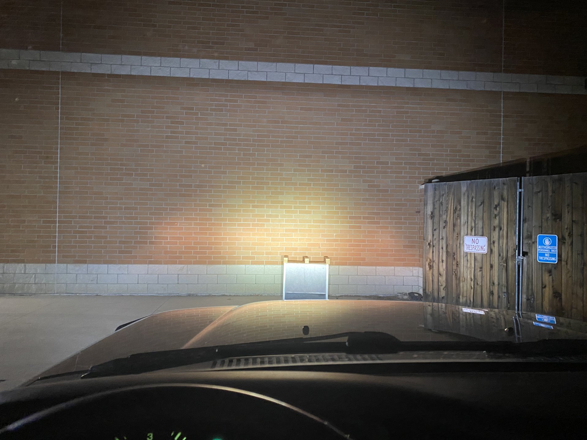

Per Baja Design you can run the high/ low on the LP9’s at the same time. I probably should have done a bit more research on what the lights come with and made my own wiring harness for free and a bit of a step up in quality but oh well live and learn. After reaching out a few times I got a wiring schematic to use the Bosch relay they provided with the kit I got with Delta. I pulled the harness apart and temp wired as suggested. I assumed the lows wouldn’t come on when using the relay but apparently on high both still light up it just cuts the low feed voltage. I realized this after just cutting the relay out and wiring to the SP direct when I saw no change with the light output. Should have done a voltage test. Oh well, it dumped the relay out by the Charcoal canister And this area is still a bit busier than I want. Direct wire it is…

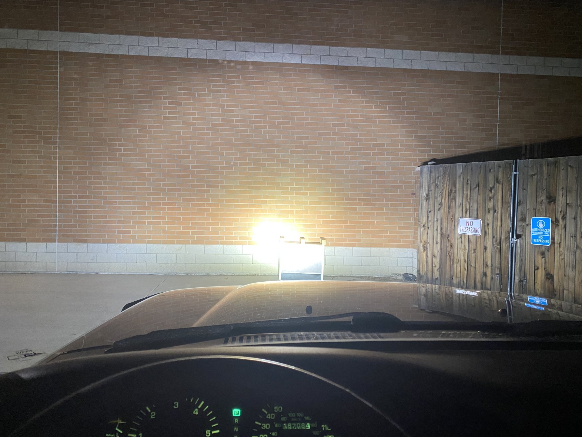

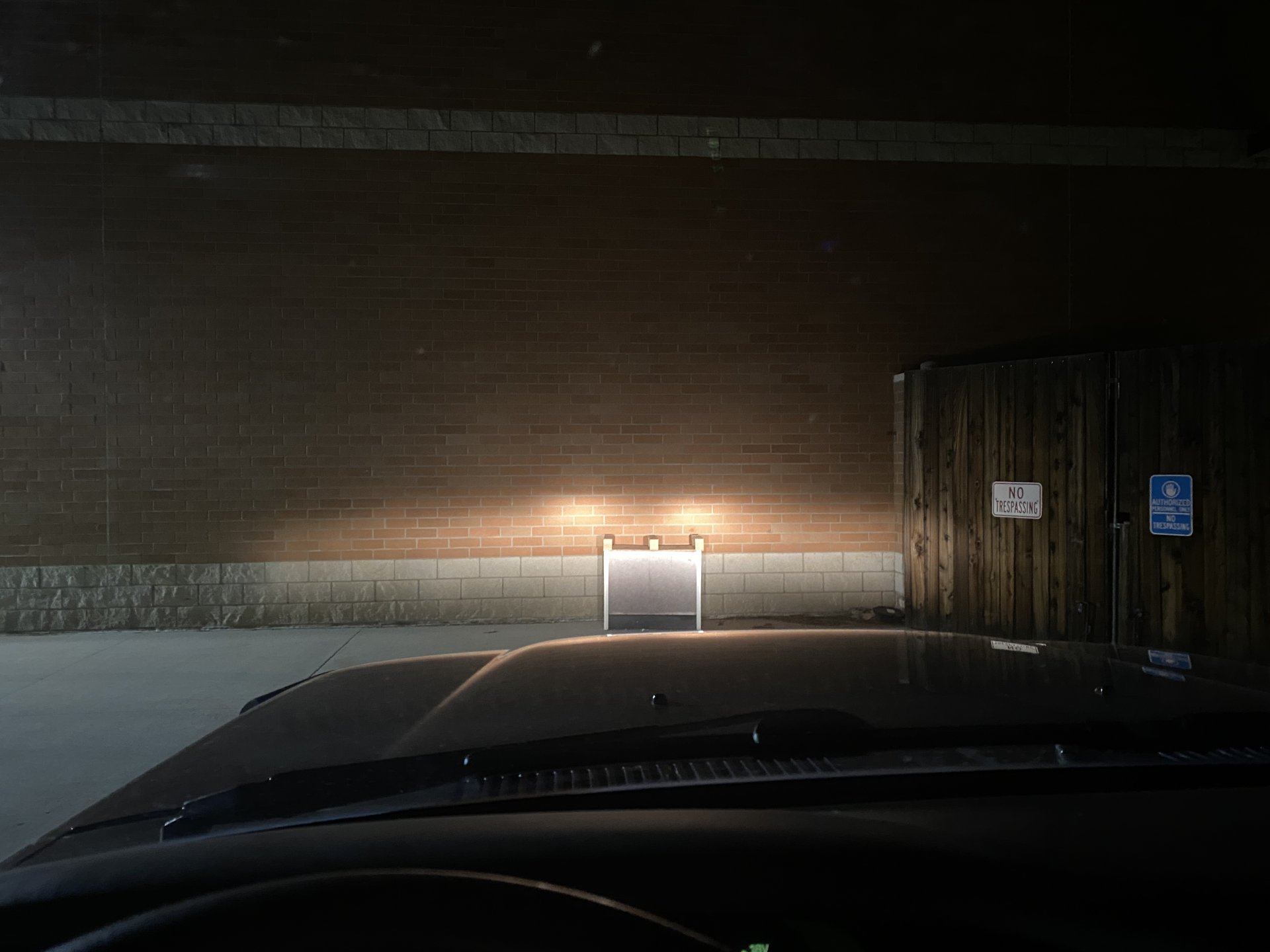

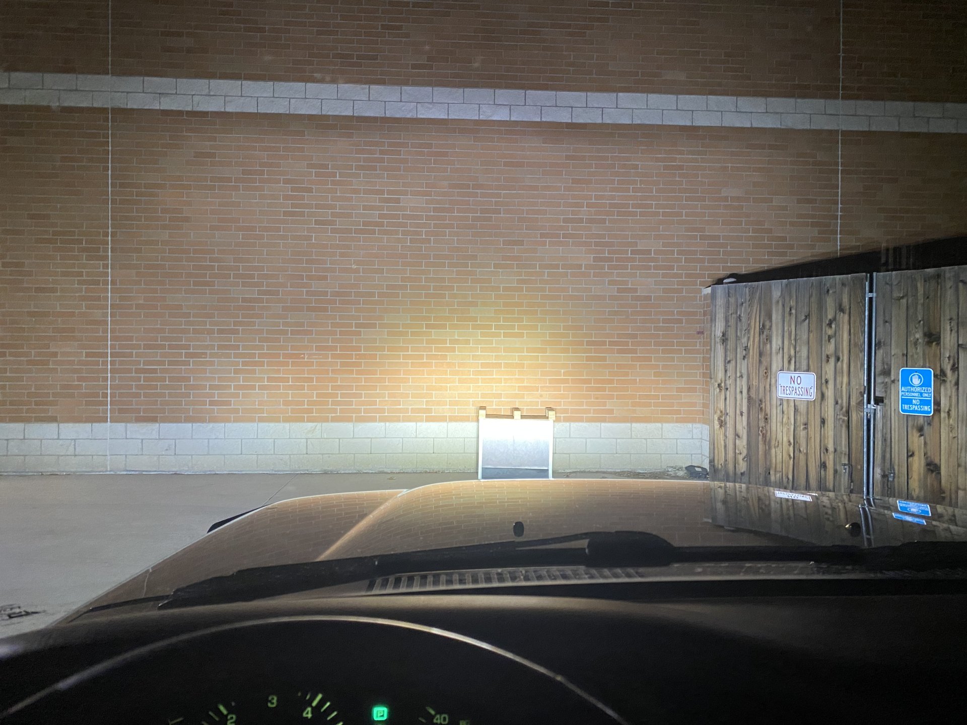

Test on a wall tonight. Not sure this shows well but the highs are crazy bright and as everyone knows the OEM lows absolutely suck… it’s hard to drive with them after lighting it all up.
OEM low-really suck
OEM high- still suck
Squadron lights- much better
LP9 low- Damn nice
LP9 high- KA FAWKING POW. Not sure how often I will use them but damn, they light EVERYTHING UP.

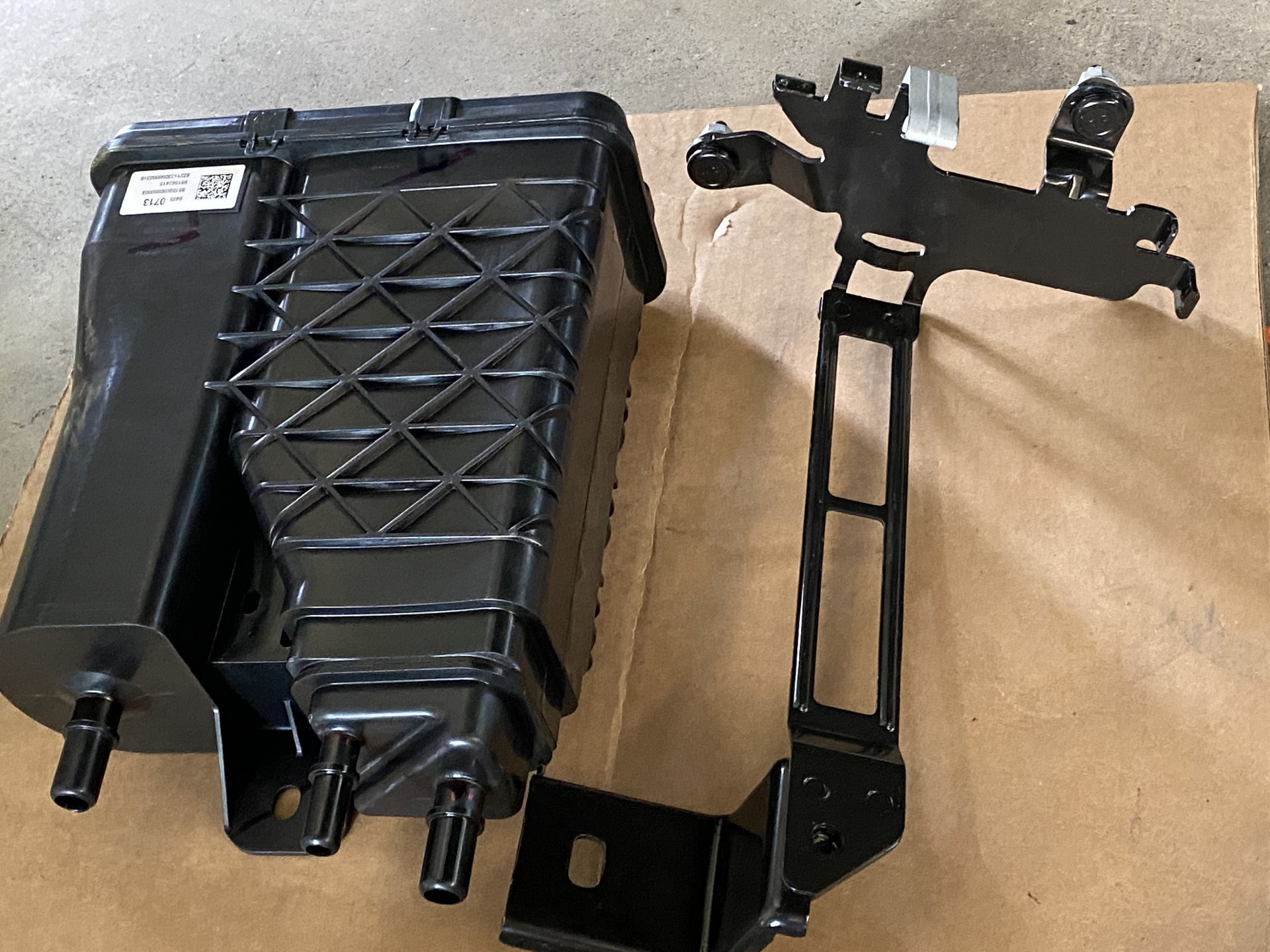

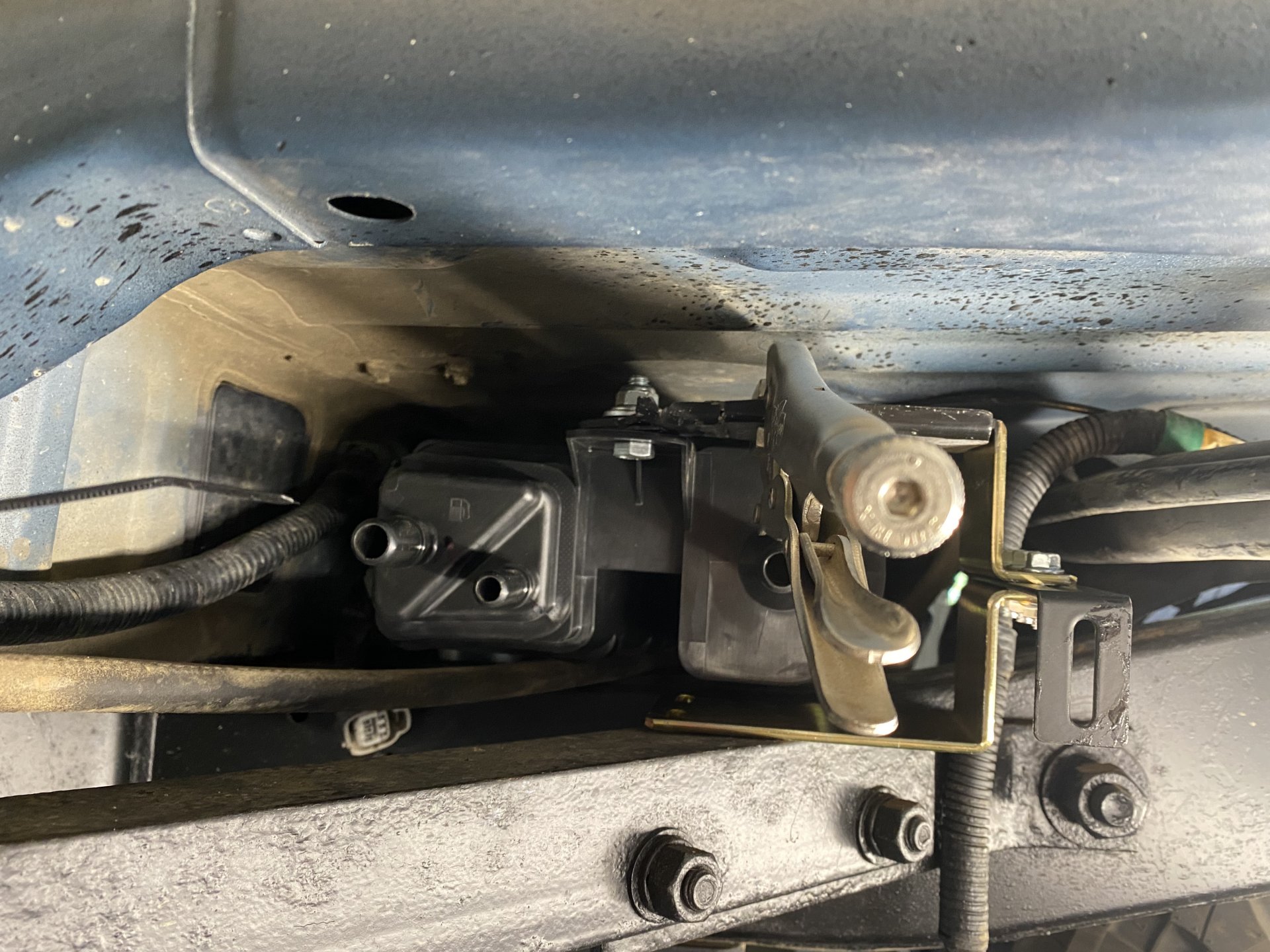

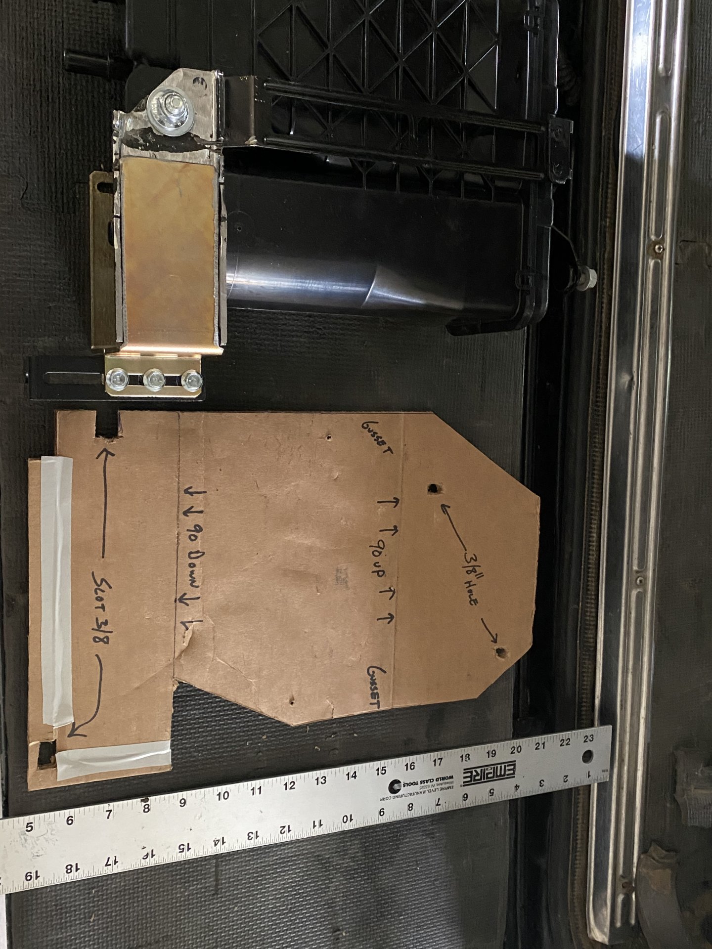

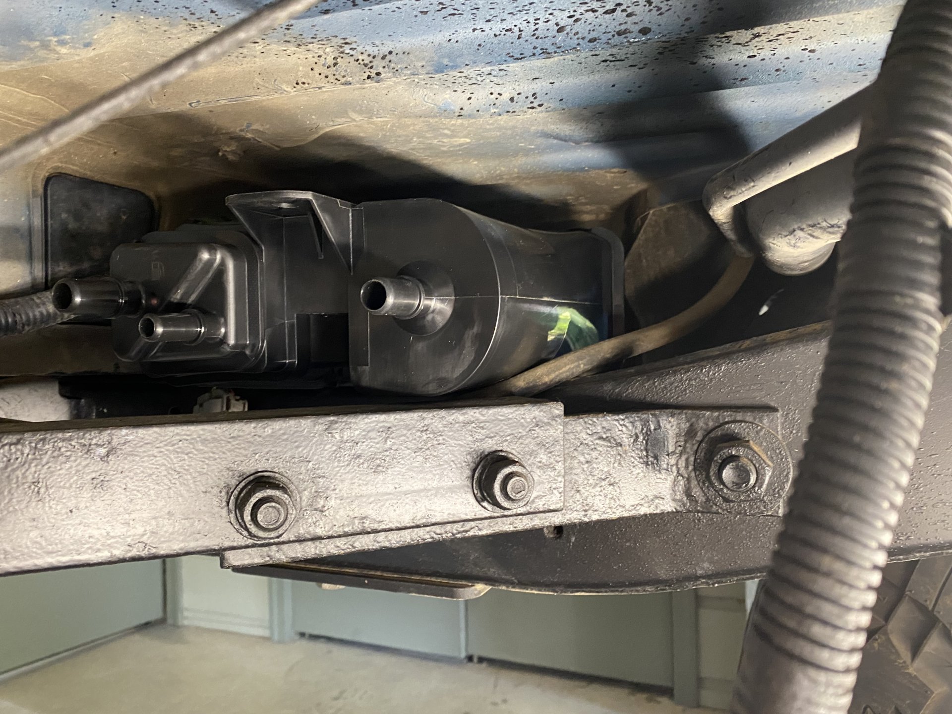

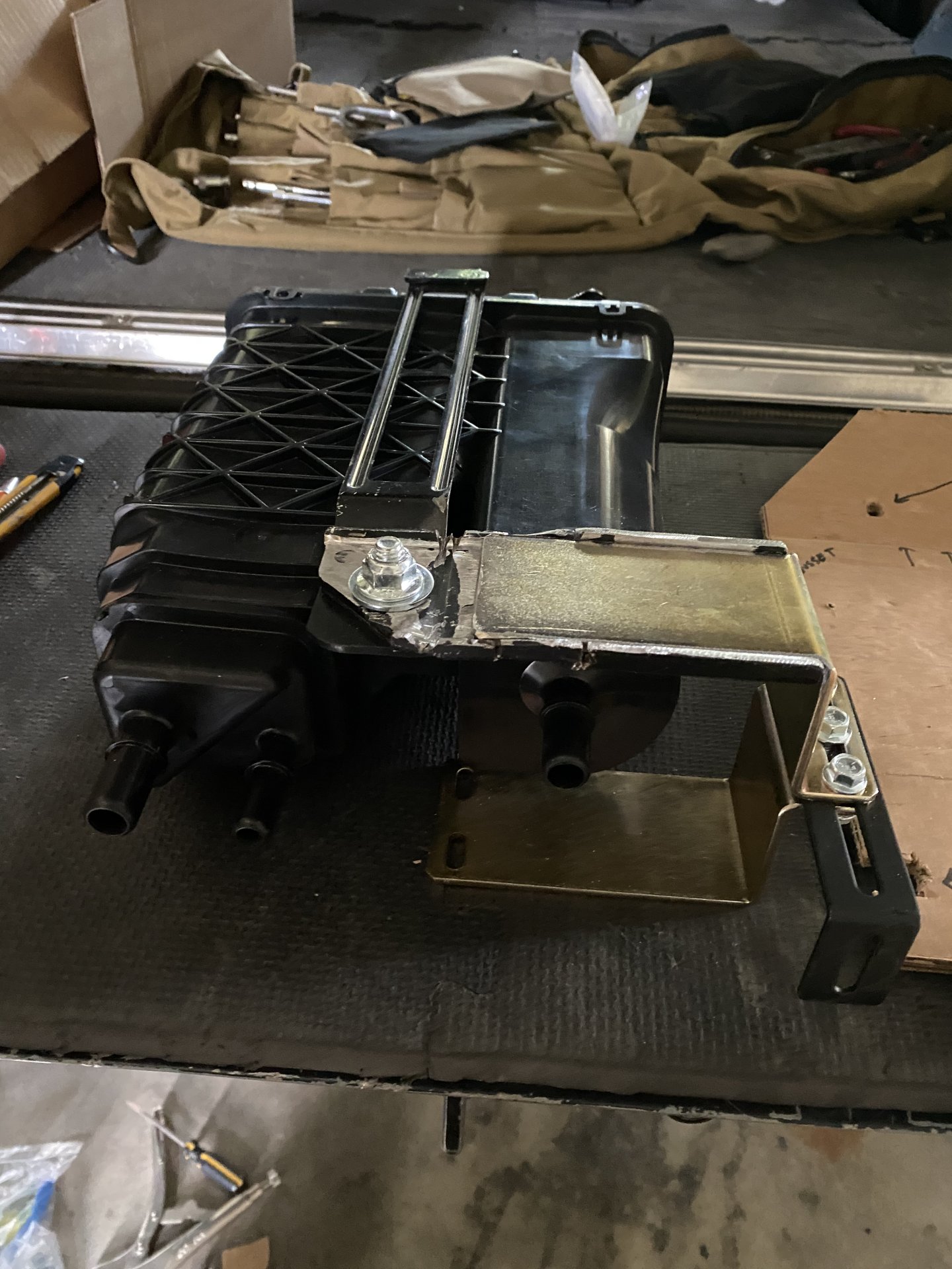

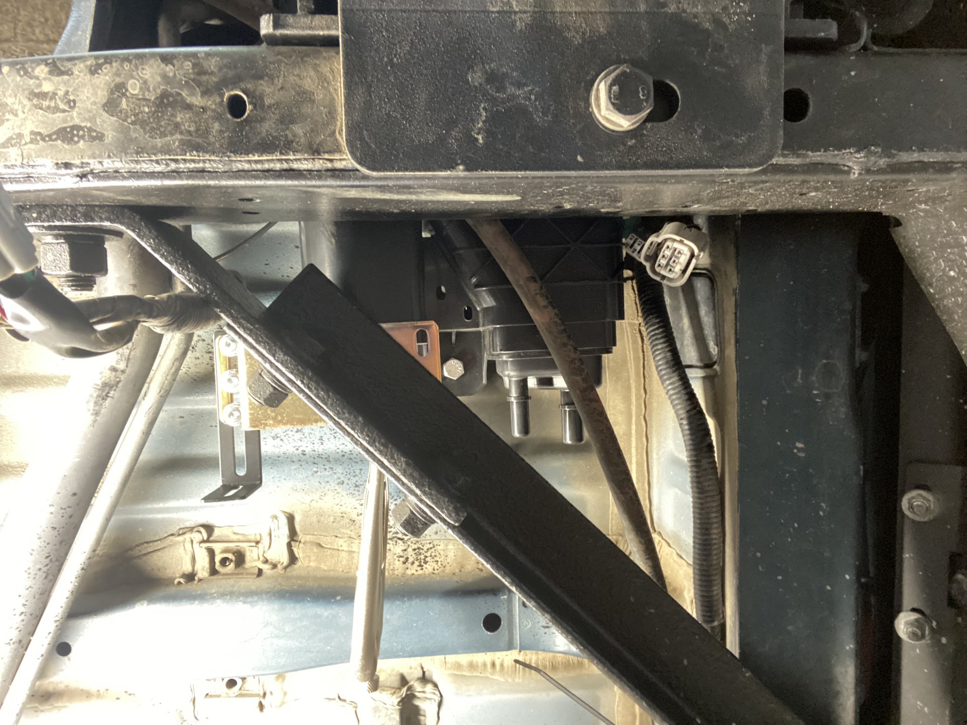

Started to mock up a mount for the under carriage charcoal canister(this thing is huge). Decided on the driver side rear area tucked out of the way. There is a nice spot over the frame and above the Delta rear bumper it going to call home to leave room for possible air tank or water storage in the main area.
I have to figure out what ports are for what on the CC. Looks to be gas tank far left(picture of gas pump), when blowing on the inlet the tube next to it seems to have path of least resistance(labeled”2”)so assume this feeds the engine and far right I’m guessing is vent( no label). May have to hit up @TYM4FUN to see what he came up with. Took a peak at the existing hoses and it seems extremely simple to swap over with no major mods whatsoever. Have a great vent location close by so works perfect.
Parts pulled from most recent GM truck with LT1 6.2 variant, to match up when, not if I get one in.
84113689Vapor Canister Bracket
84050713Vapor Canister

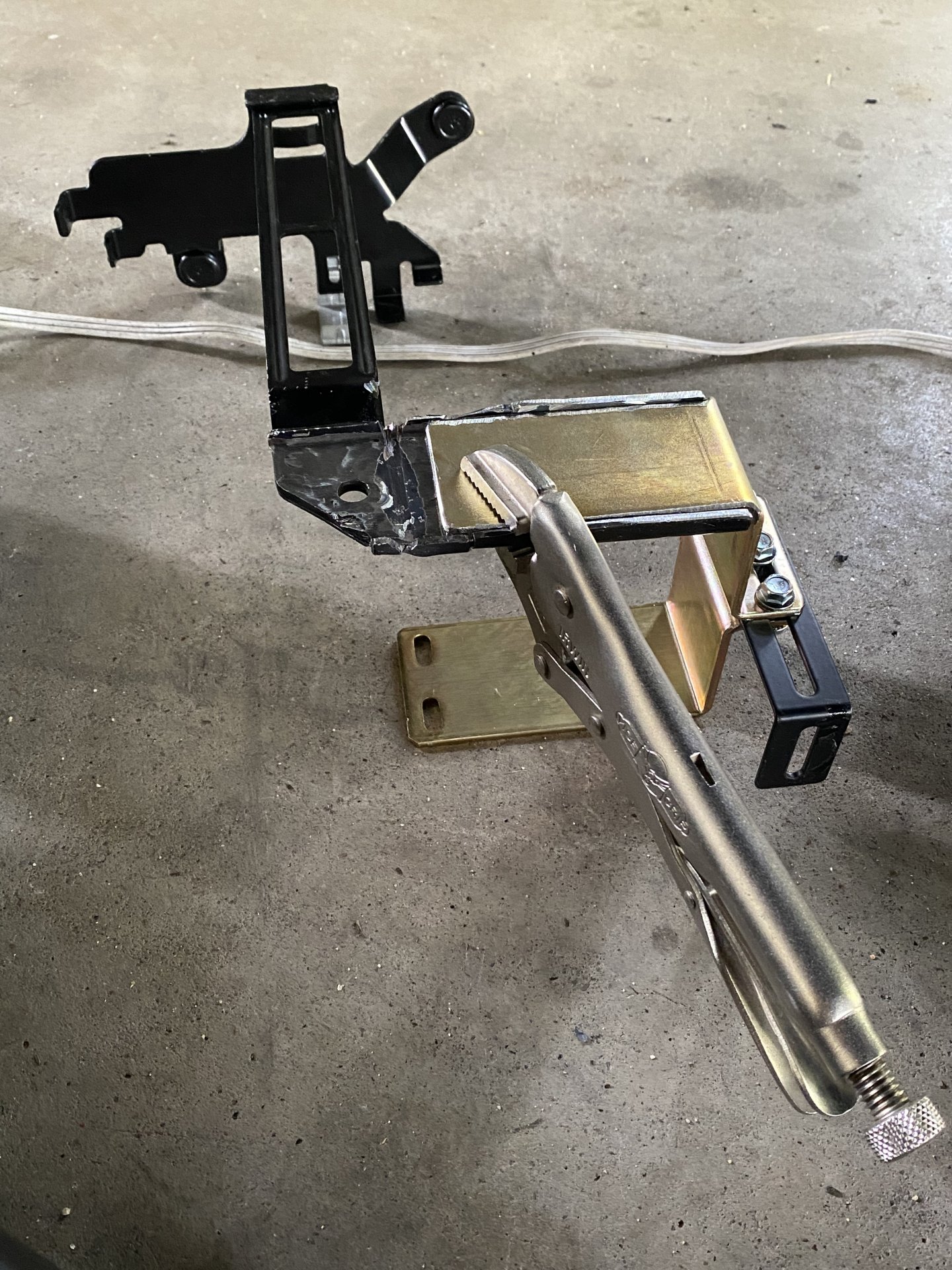

This is out of site so figured WTF, going to try to fab something up on the cheap. Existing hitch bracket will work well and use two existing thread mounts on the frame. Absolutely no changes to the 80 physically.
pre hack:
brackets on hand mocked up:
Pulled out the cardboard to fit the rear mount and I’m pretty happy with the fit:
pre hack:
Nice! I messed with putting it there as well. Still might if it ever impedes anything later where I have mine. For your canister- rear bumper hole goes to tank, middle is purge, and forward by bracket is vent.
View attachment 2759028View attachment 2759029
started to wire some KC round lights to the engine bay but not feeling it and will likely go BD LED dome lights there. Yanked the mid and rear seat belts and the lights mount to the upper location perfect with oem bolt. Mocked it up to see if I like them before I wire them in and counter sing the bolts. Will use a dimmer and looking for a good mount location. Use will be mostly for sleeping in cab.

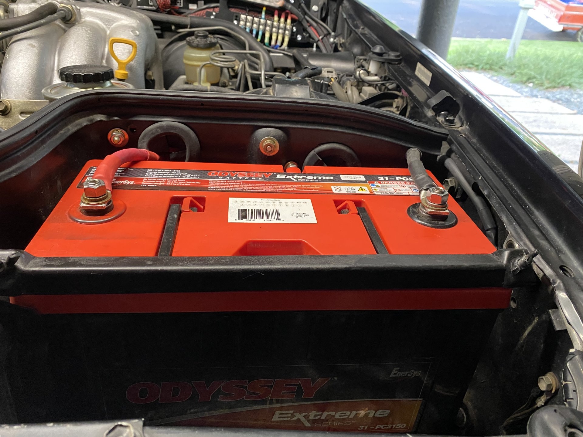

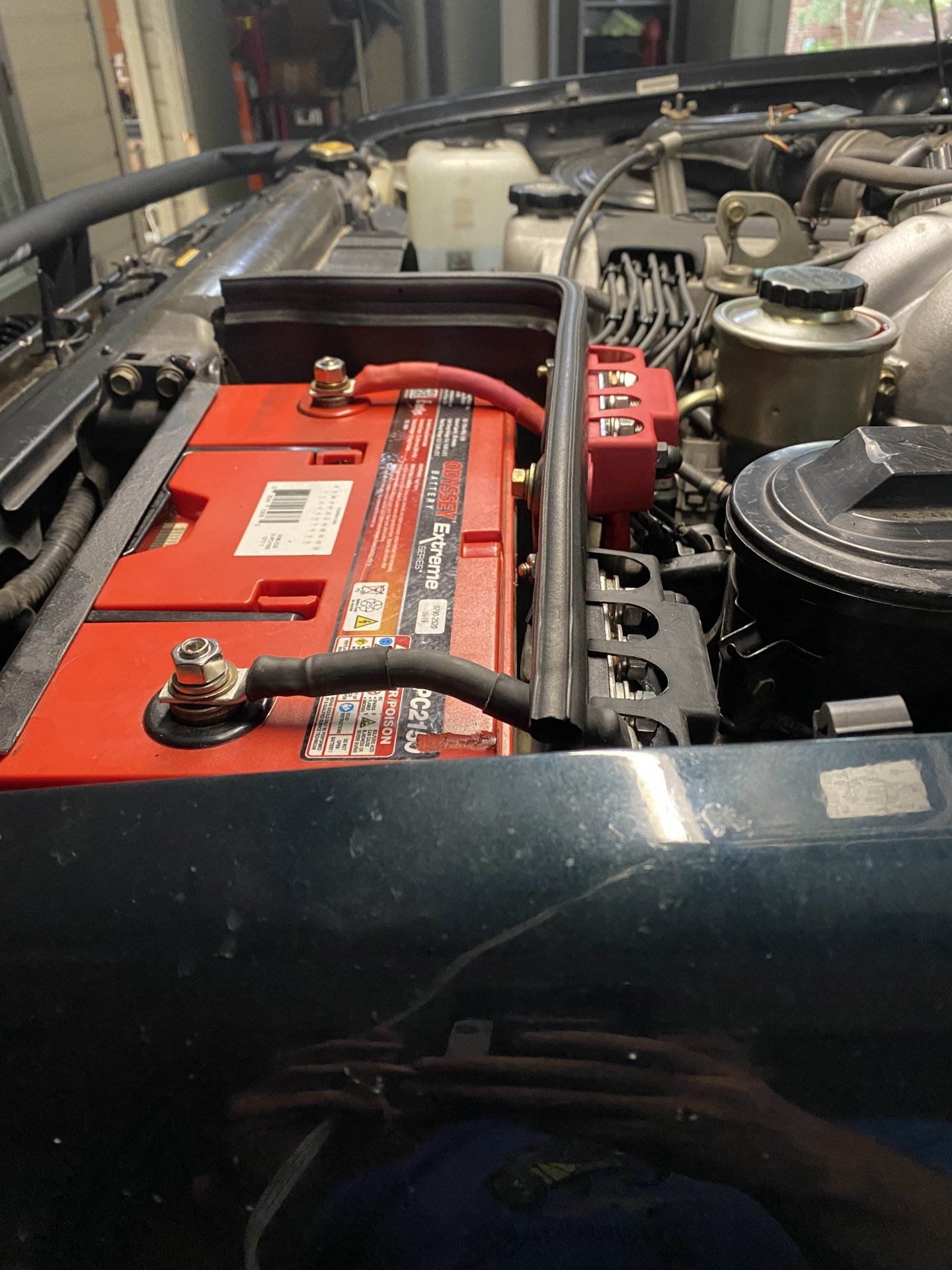

Where did you get your electrical mounts? I have too much stuff on the battery.
Amazon. Mounted to the battery box well. Little cheap for my liking but get the job done and clean up the battery posts well. You can find on marine supply sites also.

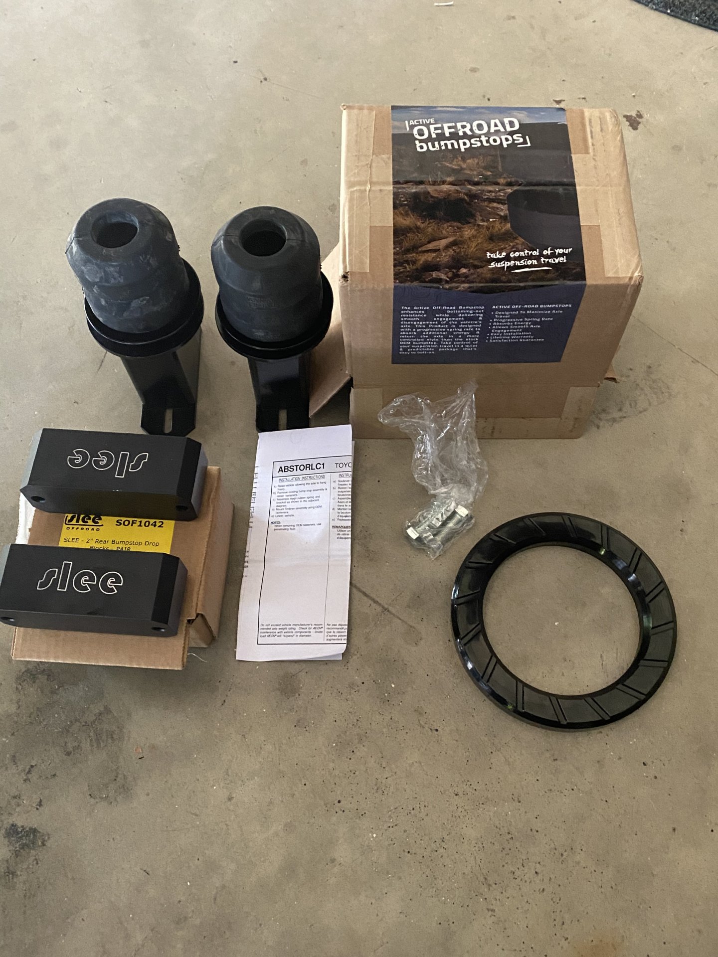

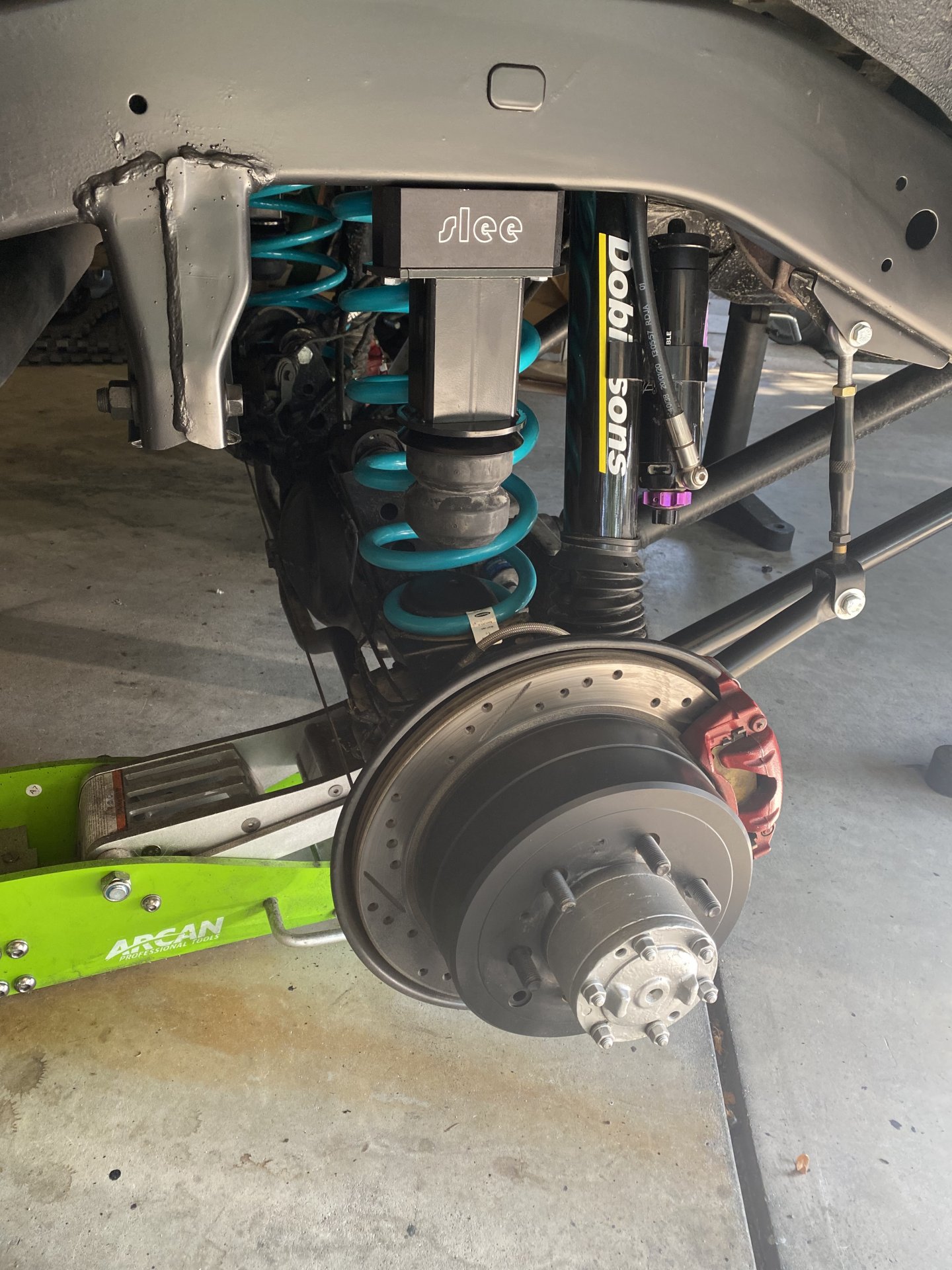

Ordered up the rear Timbren off road bumpstops. I figured I needed ~7" on the rear which seemed like too much, but after checking the rear flex I may need to add their 1" puck. It just tucked up and seemed to slightly rub, which I can trim a bit more flare, but I think the shock just bottomed out when the bumpstop came to full compression.
Debating adding the 1" body lift yet, or even mill it to 1/2" but want to sort a few more things out before I move forward.
Also considering fabing up an upper shock mount 1" rise, I have seen these before but find it odd no one has any available. Unfortunately the 4"-6" rear is too tall for the 3" VT's(4" overall lift). Another 1" spacer on the suspension would also solve this issue but I'm still leaning to the body just from the additional benefits I can get, With these few adjustments I think I can get more stuff, Not sweating it yet as this will be no rock crawler.
Also added the SLEE 2" rear bumpstop to get the 7" I needed.
Full stuff showing the bumpstop. Man these things must be bullet proof with the abuse they can take. Now I see this I need to double check the spring perch mount and make sure they don't hit. I think it cleared but looks close from that angle.
Slight rub on the Delta rear now with the beefy Landtank lower arms. Bummed on this. May have to find an alternate lower arm but can live with the slight rub for now until I go another 1/2" -1" to the 4" I have now. Possibly can adjust the bumper slightly out as well. Big fat 13.5's causing a few issues as expected.
15MM Dobinson spacer added to the left rear to sort the left side sag from the 140lb spare, fuel tank, battery and me....
On a bit of a slope but just about perfect. Measured all 4 corners from the seam on the lower body to ground and within 3/16" all around at ~2'. I want a level stance so easier to measure here than center hub to flare. Likely go air bag helpers at some point so want the level stance.
