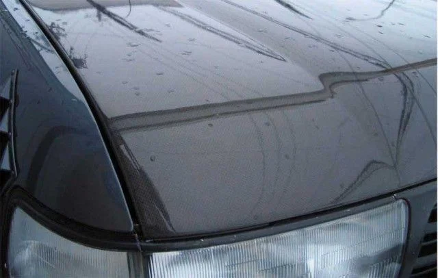

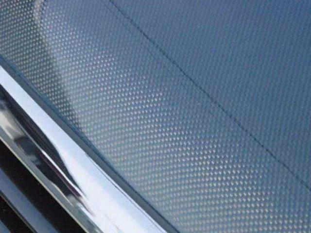

3 words, "Carbon Fiber Hood" Lol...I'm surprised you don't have one yet Harry. It would look cool with the race clips and probably very light, but probably way to pricey. :grinpimp: now you can bash and mock the idea. :princess:
alkaline's mod is a fairly popular one in Japan (Not sure how effective it is though: Not saying that it's not)

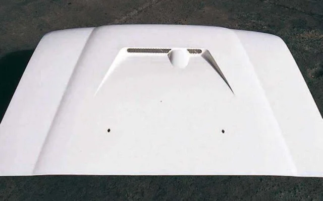

Here are some other options out there(here):
Pic 1 & 2: Did somebody say carbon fiber? :D
Pic 3: This one is available in FRP
