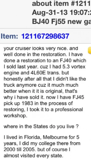

Saw an eBay ad for "40/45/55 Gauge Cluster" show up without a picture, so emailed the seller to get the scoop.
Turns out it's 40/45, but during the inquisition, discovered seller to be in Al Ain and started chatting, him sending a pic of a Japanese sourced fire wagon, explaining that he had recently sold a 5.3L 40, but restoring a 45 and owned an 83 40.
This is just easier....
(Think he's saying the PP80 looks nice, since it was parked next to the rust bucket 72)
I replied, "Oklahoma. Probably a state you never ventured through".
To which he replied
"It was the only state I visited twice, having taken summer courses at OSU and University of Tulsa".
Hahaha.
Small world, eh?

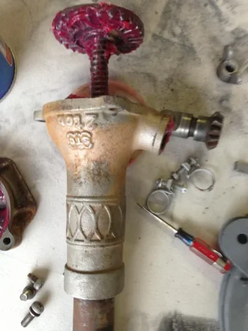

Pulled apart the frozen jack that I'd had glass blasted a while back.
Lesson 1: Don't blast anything before prepared to final coat. I did to weld a few holes up in the shroud and air cleaner assembly, then I primed those, temporarily, who h was counterproductive.
Anyhow, tore apart and wire brushed for what seemed like hours, chiseled chunks of 42 year old solidified grease out, degreased, scrubbed, degreased, wire brushed some more.
Didn't take a lot of pics, because it was a dirty job and boring, anyway, but....
Have no idea how much grease should've gone in, but I liberally applied to all.
So my problem, this now the third can I've had issues with this, first on the air cleaner I have for sale, then the heater housings, now the jack.
Using this....
For whatever reason, it balls up on the surface at varying times in a can.
I'm entirely to excited about this jack, of all things, to half ass it, so will blast again and be prepared to coat in whatever yellow Ige has suggested, but still would like to know if I'm using the wrong product, or what I'm doing wrong with the single stage primer.

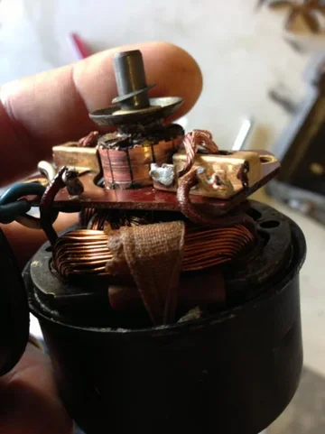

Tore into rear heater motors. Had one working from camotubebender's part out that was cleaned. Everything looked good inside and cleaned up outside.
One from the 71 was froze up and crusty. Cleaned out the best I could, since I see no way to remove from housing, and going to hope for the best.
It does spin, at least, with same resistance as the functioning and can actually see copper.
Clean the armature, where the brushes ride. It gets a glaze on it. Make sure the brushes move freely and make good contact.
I've got to do the same on mine. I test fit the rear heater, under the Corbeau seat bracket, it doesn't fit. Need to modify it.

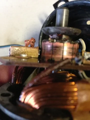

They're not, after inspecting closer with it oriented correctly.
Crappy pic.
First time tearing into one, so not sure what or where to source replacement brushes, or how to determine if commutator or armature is in need of anything beyond cleaning.
Not sure if a Radio Shack item, or more involved.
Might as well tear into all three motors and do at the same time, while I'm in there.

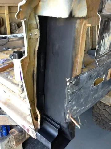

That donor corner looks nice!
Tucker
As does the donor rear quarter, donor roof, donor cargo floor, donor fender lip, donor floor supports.....
Made a grave mistake when I thought it'd be noble to save the 71 coupled with a few major purchasing errors, namely all but the hood from Cruiser Corps and it's borderline sickening.
It'd have been so much easier to have corrected the rockers and floor pans on the 71 shell and swapped, used the 71 tailgate (which is correct) and inner and upper outer fenders, NOS lowers.
Would've wound up with an excellent shell and front clip, all for $500 (paid for parts Pig) and a few hundred to bobm, instead of the insurmountable amount that its grown to.
I actually caught myself trying to rationalize a reason that the 71 wouldn't have served all purposes and couldn't.
