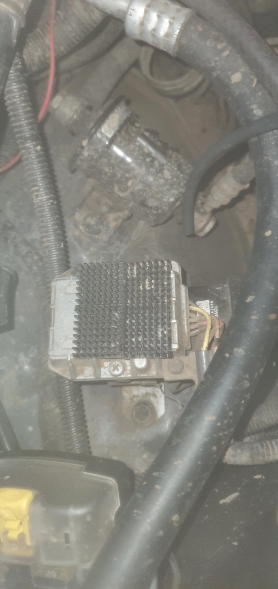

I put some heat sinks on the igniter module that I had laying around to hopefully have it last a little longer. I don't know If it does anything... The coil is so cheap compared to the module.
^^^ that is a good idea. And another is to take it apart and put some silicone paste between the metal heat sink and the transistor.
Keep your transistor in the igniter cool to save it. The igniter is NLA from Toyota. If the igniter goes, you will have no spark from coil to dizzy.
Here is some good reading from the FAQ section on making an igniter from a GM ignition module. Igniter Repair for Cheapskates - https://forum.ih8mud.com/threads/igniter-repair-for-cheapskates.802849/page-3
