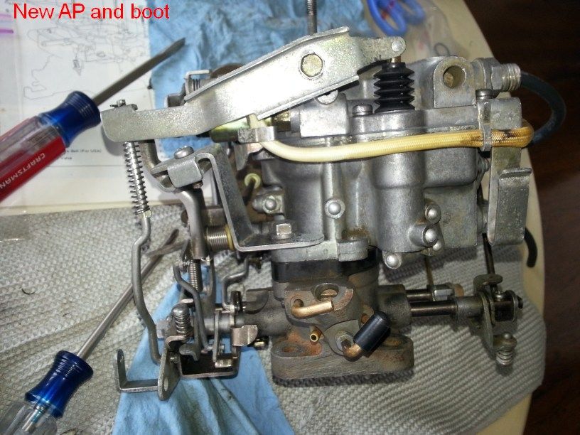

A couple of weeks ago I took the plunge and rebuilt my Aisan carb using the Keyster carb kit from Kurt. I've attached some pics of the process. I watched Pinhead's videos, which were a great help. I even re-assembled in the kitchen, Pinhead style :wrench:
Turns out my secondary wasn't holding vac so I replaced that too using a Napa diaphragm.
Really fun process. The hardest part was getting the main jets out and putting the little retaining clip back down the AP hole on top of the BB, but it helped to have forceps like Pinhead suggests. I soaked my parts over the course of a week since the Berryman's can was too small to fit everything at the same time. I didn't soak my diaphragms though - I would assume they contain rubber/plastic internals... so they aren't shiny.
Engine is running really well now. Was hoping this would solve my off-idle problem but that's still a mystery.

On the carb, the AC idle up is flopped around the wrong side of the throttle shaft. remove the little clip where it attaches to the vac can, then rotate arm around on the throttle shaft so the pull rod is above the throttle shaft and reattach to AC vac can.
2014-03-22-14-09-56-jpg.880924
In exchange for that freebie, please post the current part number for the NAPA secondary diaphragm.
I thought they were totally NLA, but maybe there is a new PN?
