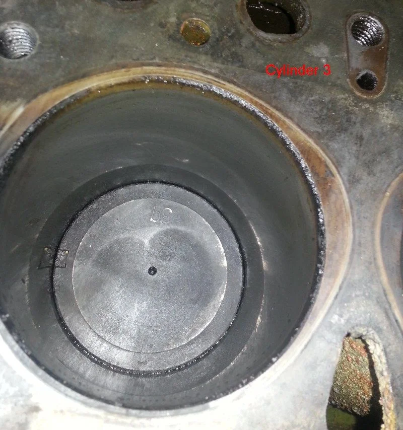

I'm posting some pics of my cylinders and valves too, hoping you guys can help me identify any problems. Cylinder 1-3 are posted here, others to follow in next post.
After I took these pics I cleaned the block up with brake cleaner and a putty knife. I cleaned the junk off the piston rings as well. The cylinders look OK to me, there are some light marks, but nothing deep.

Looks pretty good inside.
Thoroughly clean the block in the failed HG spot, then check with a straightedge to see if there is erosion in that spot. If it is flat, it should seal fine.
