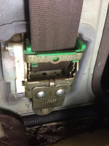

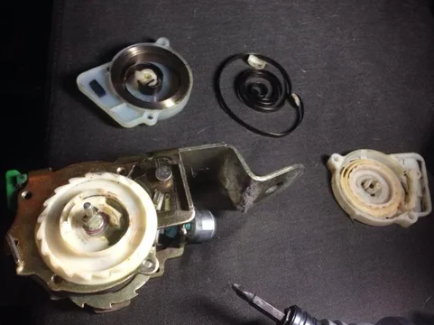

Ok so I wanted to take my seat belt locker thingy apart and see why it would not work right. After taking it apart I discovered that there was 3 or 4 different plastic pieces that broke. Time to order a seat belt from cruiser parts.net
