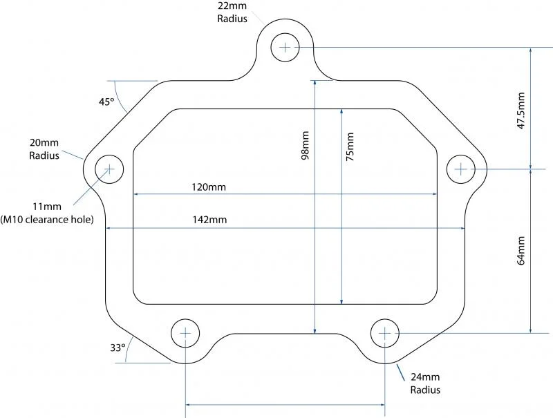

Meanwhile... I've drawn up a spacer for the heat riser replacement. Not all the dimensions are in yet but you get the drift. I plan to remove the butterfly arrangement and use this with the two new gaskets so I can install the manifolds and carb. Anybody need one? If so let me know and I'll make extras.

You are making it rain with that spacer diagram brother! I forgot you were the king of all things drawn mechanically. You may want to explain again to MUDland why you are taking that out - there may be others who will jump on if they like the logic.
Hey Rainey, If this spacer is going to block off the bottom of the intake manifold from exhaust gas, please count me in for one. Years ago the flapper broke off my exhaust diverter on the way home from GSMTR, partially blocking the exhaust gas, causing my 40 to overheat. It took months to figure out what was causing the overheating.
Trying to keep it short:
First, this Cruiser and most Cruisers these days aren't normally used as daily drivers. Second, the gas used today runs hotter than the gas did back when these trucks were new. Third, these manifolds are 30 to 50 years old and if the heat riser mechanism hasn't failed already, it most likely will and there's a 50% chance it will freeze open or closed. That's a 50% chance of ruining parts around it like cracking the intake. So while I've got the manifold off, it just makes sense to eliminate the potential problem now. I'm not making it as a block off plate because open it can still heat the intake but not have exhaust forced upward to over heat the fins. Now all of this is advice from someone who has been building engines and hot rods and most anything else with an engine for 50 years and did this exact thing to the engine in his Hudson. It's straight 6 has the same basic design and he removed it for all the reasons above and it runs perfectly.

Don't make the spacer hollow in the middle (like the gasket). Just make it from a solid sheet of SS metal. There is no need for the exh gas to hit the bottom of the intake manifold all the time. That only makes it too hot. The intake manifold gets plenty of warmth because it's bolted to the top of a FRICKIN HOT exhaust manifold. Conduction provides plenty of heat transfer.

1/16th SS?
Yes, 16 ga, or 11ga. Remember that the spacer sheet doesn't need to be gasketed to the bottom of the intake mani. So the SS plate can equal the thickness of the original spacer plate plus one gasket (11ga.)
The stack order upon reassembly is
- Exh mani
- gasket
- spacer plate
- intake mani

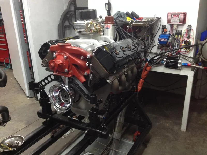

An update on the other project occupying my time... The Baby Hemi is on the dyno and we'll run it tomorrow after we get the last of it hooked up. Not looking for big horse pressure, just making sure it's running well, broken in, and not leaking anywhere.
It'll get painted after it's all buttoned up.
Thanks Scott. I wish I could post a sound bite of the motor running. Purrs like a kitten. It started right up the first try.

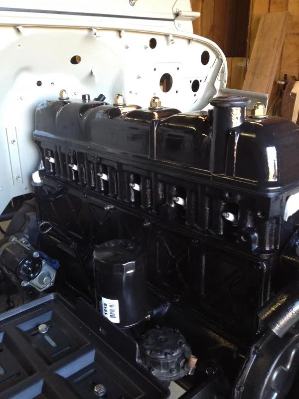

I pulled out the Green Machine and let it run a while in the pasture and pulled 2NDCHNC over to the barn door and let it bask in the afternoon sun while I painted the engine, front frame horns and the big late model turn indicator housing and posts black. I didn't take any shots because the sun was straight on the Cruiser and you couldn't see much. I couldn't pull it out of the barn and get it back in alone as the opening has a slight drop which is a pain to roll back over. Pics soon though. I promise.
