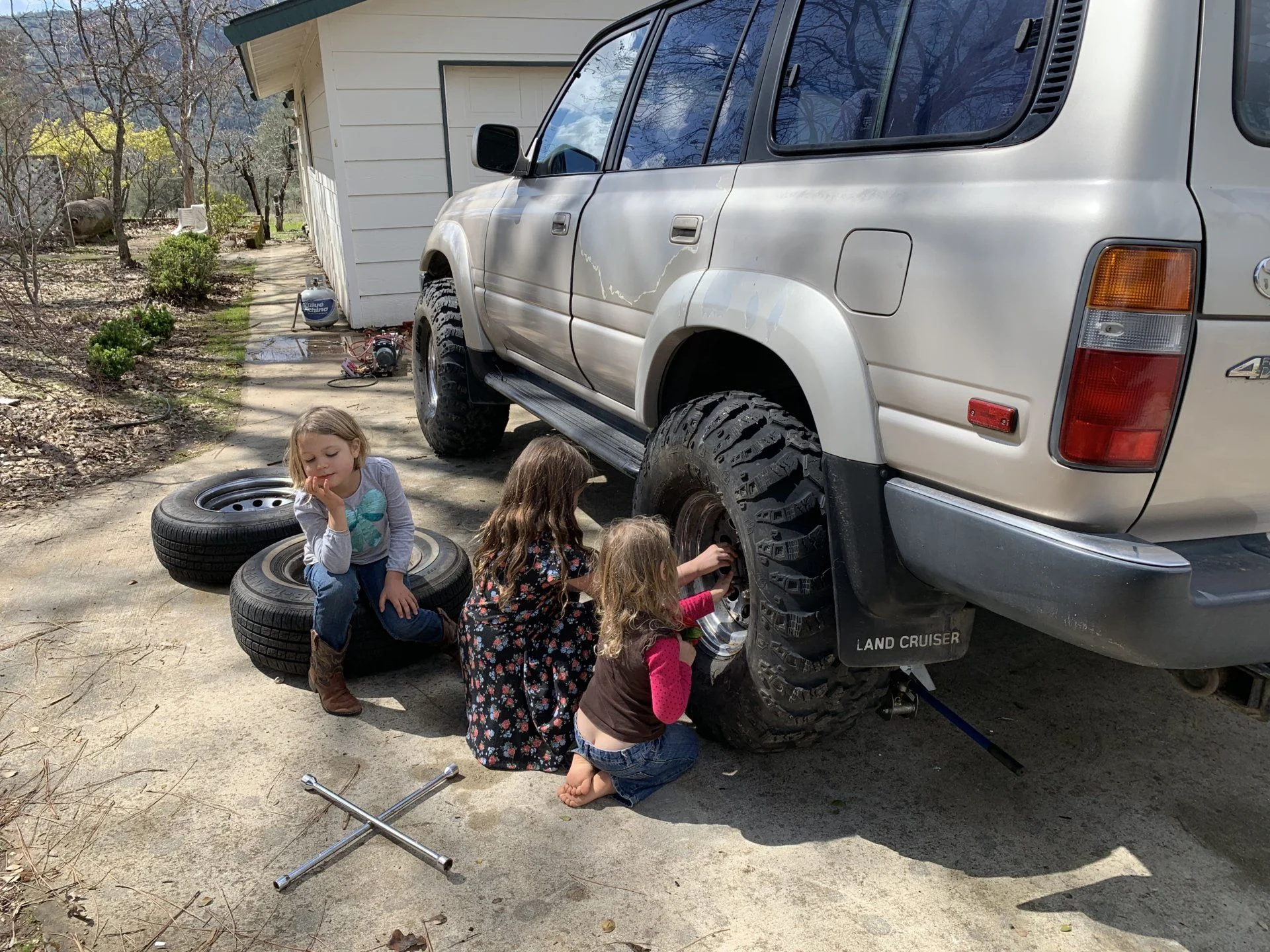

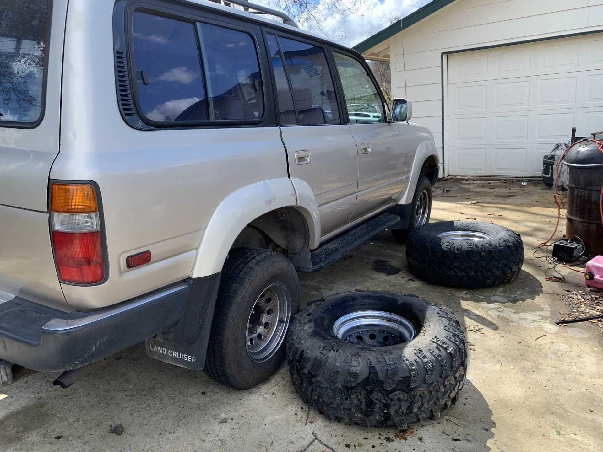

Today, my pit crew helped me put 36x13.50-15 Iroks from my 4runner rock crawler on it, since the PO's 235/75R15 street tires looked ridiculous with the lift. They made the speedometer look pretty cool though. Driving with them was probably the only time the speedo ever went to 90. My cell phone GPS was reading a more realistic 62mph.
I adjusted the throttle cable and kick down cable today. It created an entirely different vehicle. A steep grade in my street went from a 20mph venture on 235/75-15s to a 35mph one on 36x13.50-15s.

Old wheels and tires... From my old 86 4runner rock crawler. I hate chrome rims. Looking for a set of black steelies to mount 35" KM3s on.

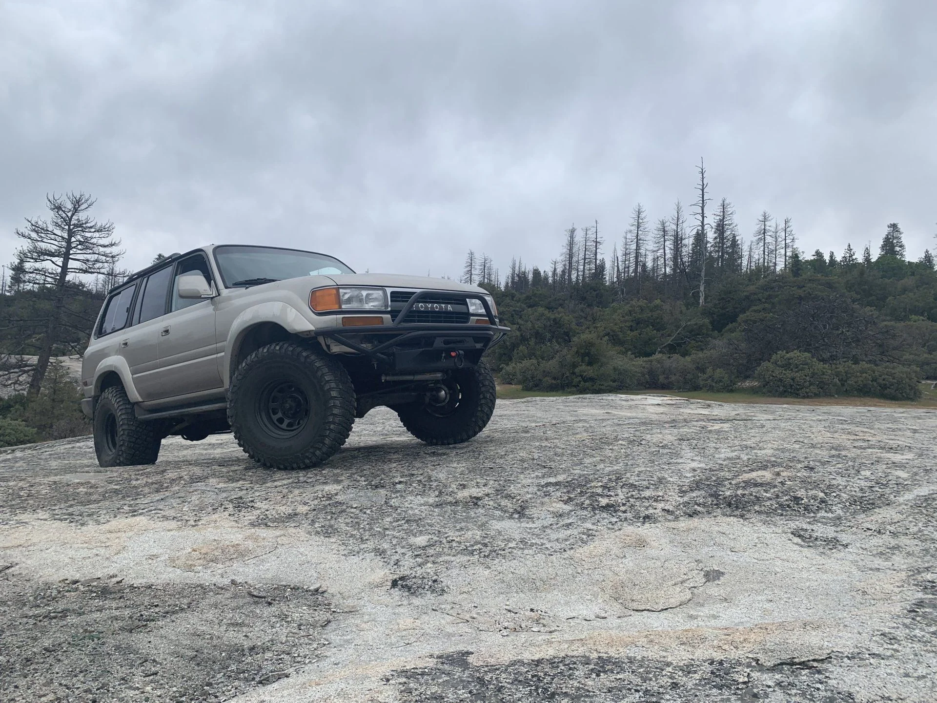

Still, the kids requested a mother's day trip, so off we went.
The stability that the KM3s and the tough dog lift give make this like cheating.
