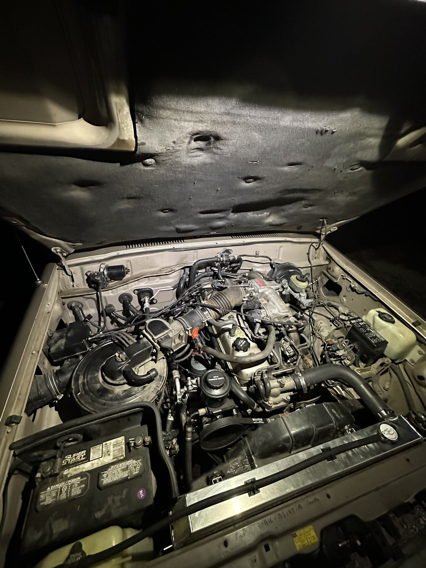

Hey all,

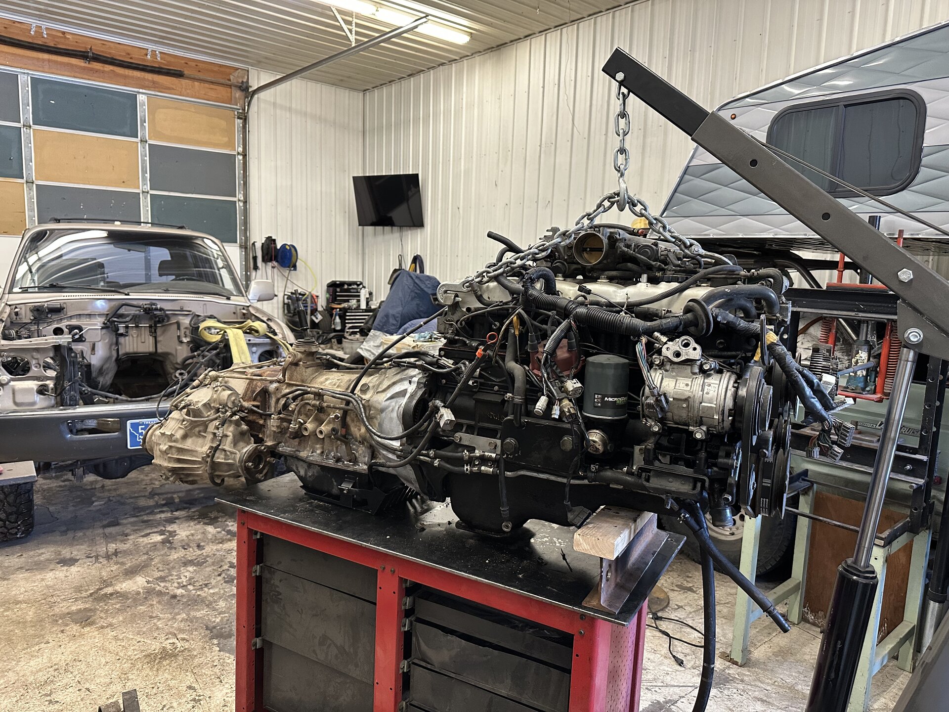

I recently got my 1992 80 running. I bought it with a seized engine and transmission. Found a used engine I went through and resealed and had the transmission rebuilt. It’s running and driving but it’s slow. When I say it’s slow I mean it’s way slower than a 3fe should be. I’ve adjusted the trans cable and it seems the be shifting as it should. The timing I have maxed out and it still idles a bit low after warm up. I’ve reinstalled the distributor a few times and it doesn’t seat where I wish it would to give me more adjustment in the timing(one gear tooth would make the difference) Heard about the golden screw which I will try next but the engine is not as responsive as it should be. Takes a second after the pedal is pressed to rev up which leads me to believe the timing still needs more adjustment. All ignition parts are new. Just feels so bogged down. The engine is desmogged and the cats are deleted. New pugs wires dist cap and rotor. Any thoughts would be much appreciated. I feel like I’m missing something small.

I haven't checked the pressure from the pump but it is pumping. The fuel filter is new and the vacuum lines have been inspected and I replaced what was bad. the routing could be wrong. I looked at all the diagrams I could when I reinstalled the engine but maybe I crossed two lines. Could you post photos of all your vacuum lines. That would be greatly appreciated.

How big are the tires on it? What is the ignition advance at, currently? Are there any vacuum leaks?
it should be under your hood
but this may help
