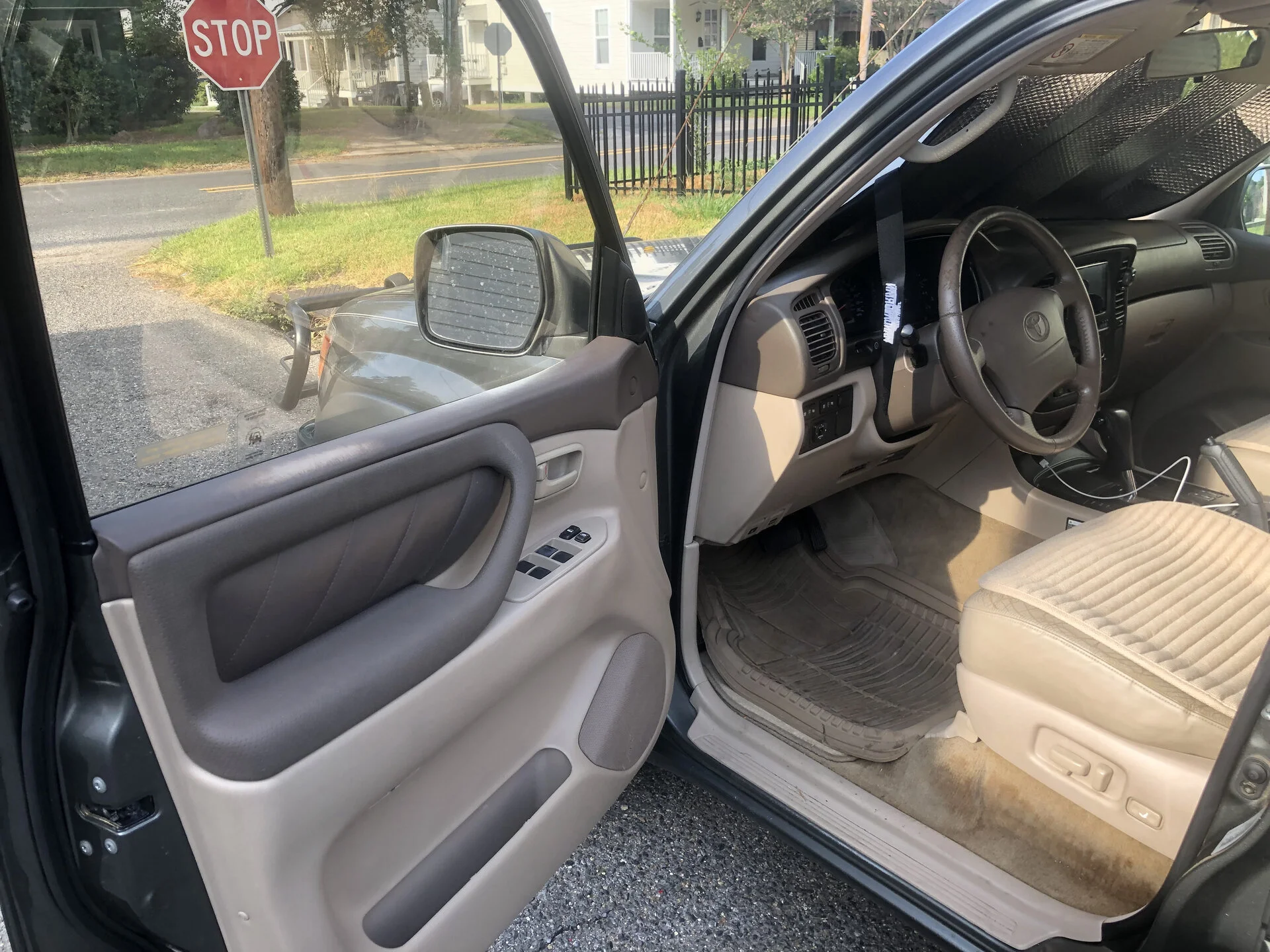

Hi all, I would like to paint the sterling wheel center and the top section of the driver door panel of my LC 100. The interior color is tan and has some brown parts, any suggestions for the perfect color match?

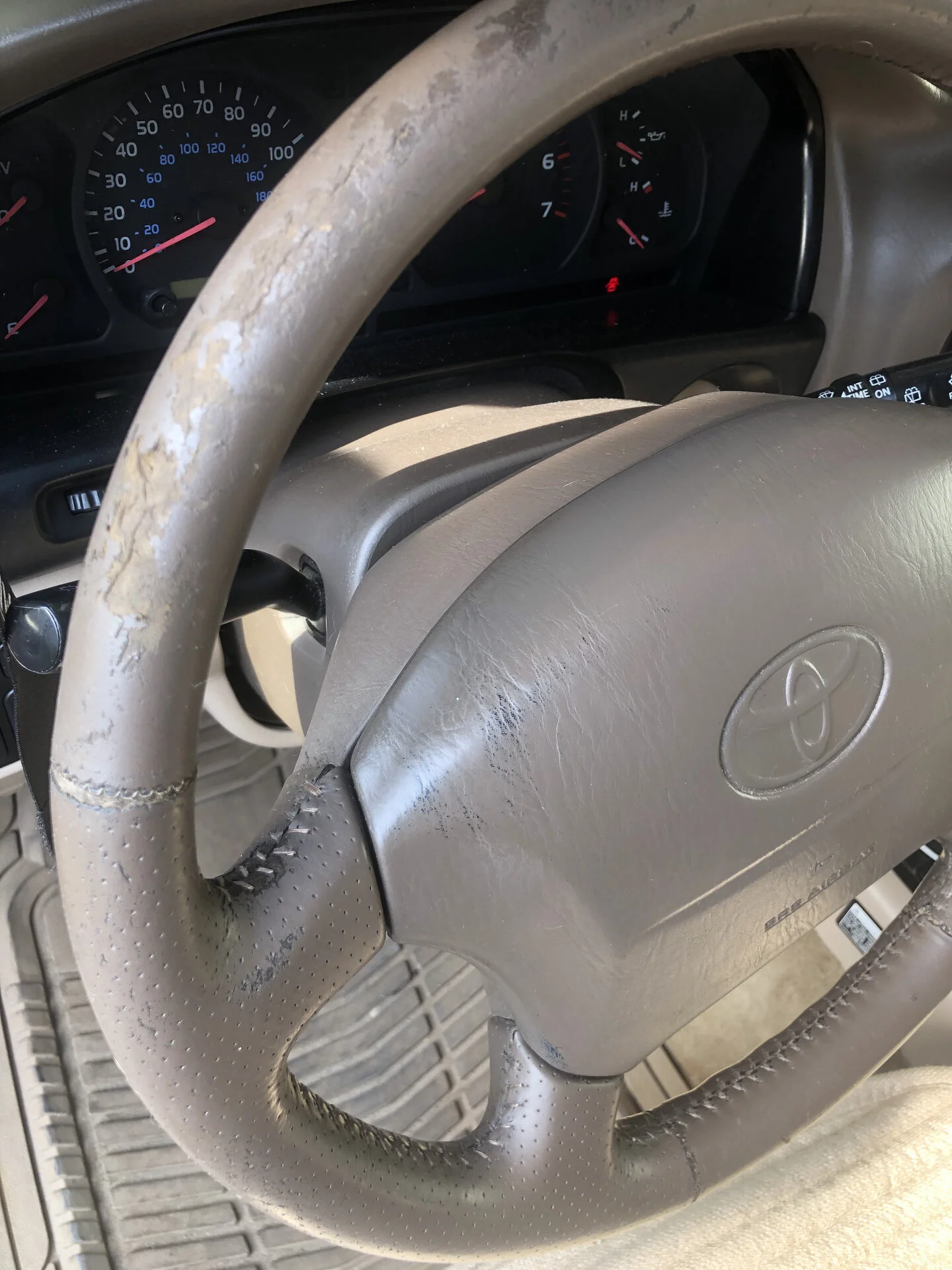

So based on below thread, I have a can of this in my closet, but have not used yet… I would not bother painting the wheel. It looks like the material has degraded. Sew-on kits for like $70 online… which are close but maybe even dye that too with same spray?

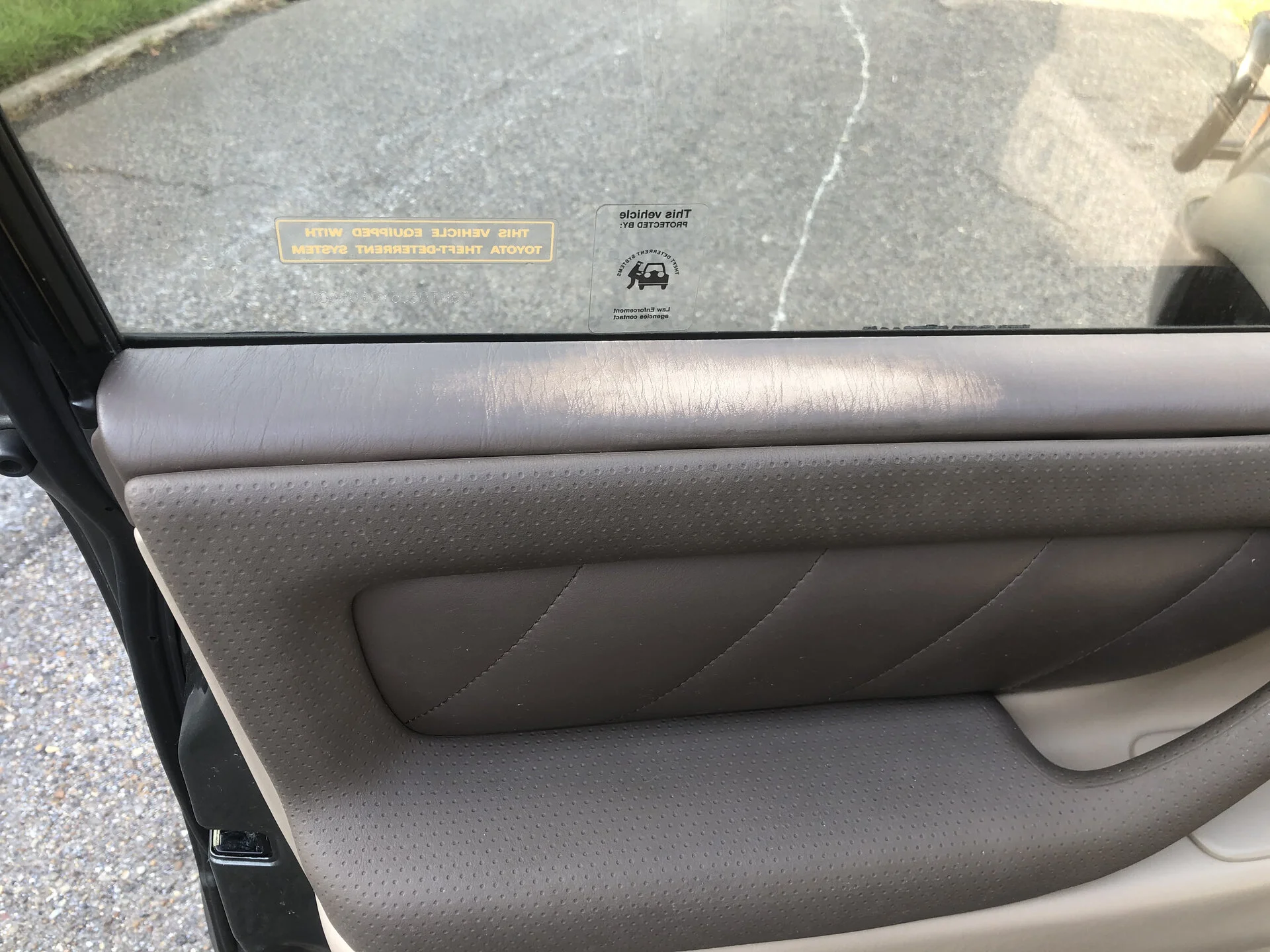

Someone suggested the vinyl spray die color and I bought it and after sitting on the shelf for a year I decided to use it. It is a perfect match. It looked so good I pulled the rest of the panels and did those too.View attachment 2788330

I am going to paint just the center and will buy a leather kit for it
I will say that SEM paint / dye holds up great. A couple years of daily usage and parking outside in Houston, TX Sun everyday. Even where I rest my elbow is perfect. Kids in the back - no blemishes.
Clean clean clean before painting.
You can try on the wheel but I doubt it would look good. I say wrap it.

Just re painted the darker portion of my driver card where I had the "elbow fade". Used the SEM 15723 "Monterey". Perfect match! My Toyota service tech thought I purchased a brand new door card.
