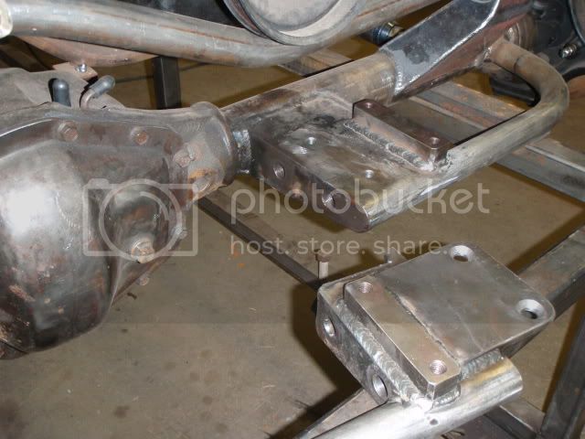

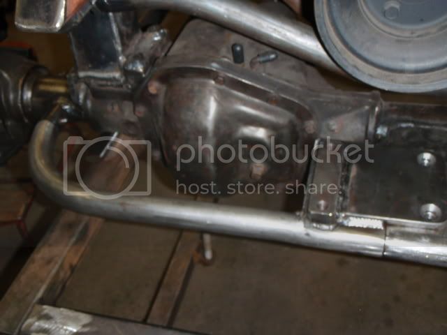

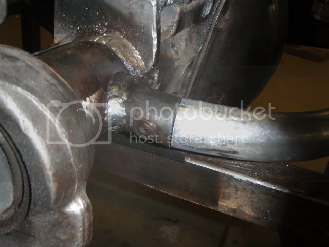

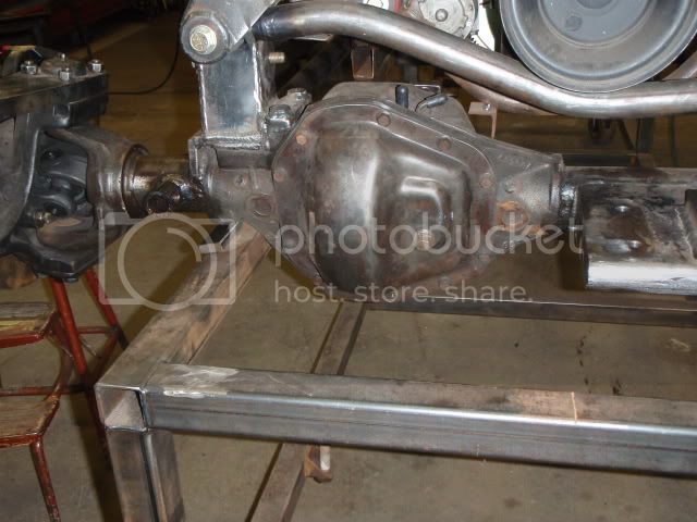

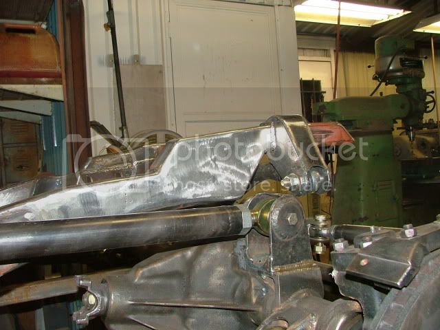

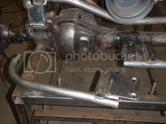

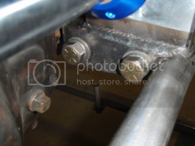

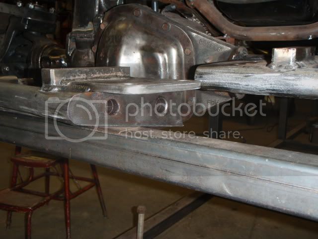

Finally some progress worth posting some pics. We may be in trouble for not spending enough time with our Valentine’s today, but we sure made some progress on the front suspension. After much head scratching and many questionswe ended up building a 3 link with a pan-hard bar.
We still have some boxing in to do and some cleanup on some things but made some major progress.
All of the pics are just past full bump. Ride height will be 3-4" higher with lots of droop
Pan-hard brackets:
Pan- hard bar:

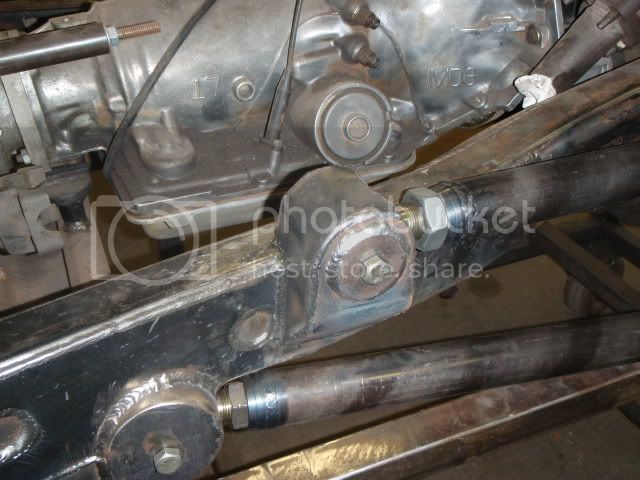

Three link brackets:
Still need to box this one in:
Links:

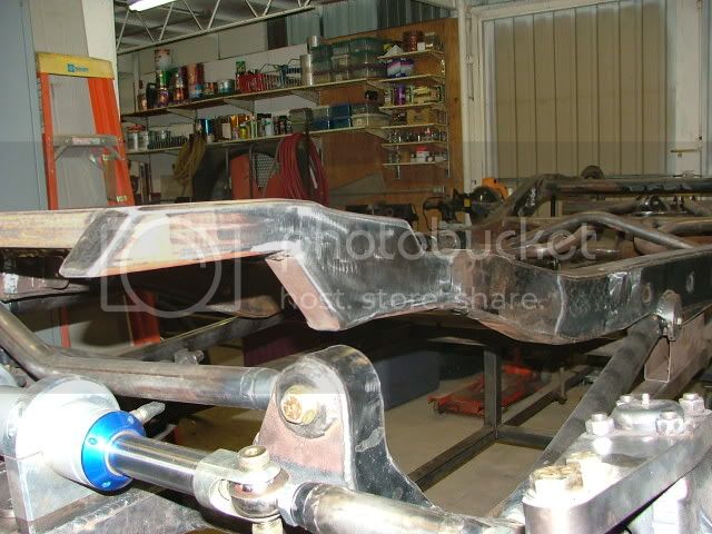

Couple of more shots showing the 2 piece ram mount and boxing in and strengthing the frame extensions on the front.
