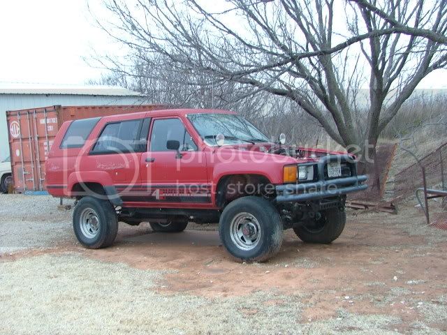

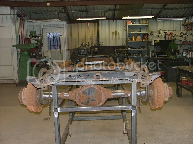

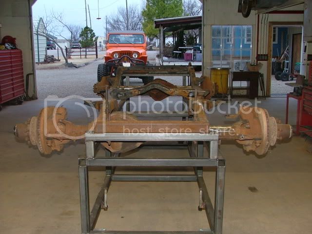

Got the 4Runner started. A good friend of mine who has built some awesome J@##ps and done some work on the Pig for me has it. He has gotten it on the jig table and set the wheelbase. Link material on its way to go with the hiem joints already on hand.
:bounce::bounce2:
Wheel base is going to be 114" + or - inch.
Motor is 4.3 vortec, 700R4, and Atlas II 4.3. 42 IROKS on recentered Hummers. Dana 60 front(5.13, ARB, chromo shafts, CTMs) and 14 bolt rear(ARB,shaved)

Thanks Domek for the answer. You are spot on. We spent 8 hours yesterday just welding up holes and and grinding off stuff and plating the front of the frame. The guy doing the work is an anal retentive son of a gun but he does excellent work. Kowboy, remember I can retire in 11 years so you may be close in your estimate. Course by then you'll be drawing SSI and slobering on yourself. Your gonna make Perk look like a a high society member.

Is that an 86 model? I am trying to sell my Step Dad's right now and it has the same "super fly" stripe package. Just wondering. See ya in a week and a half!
