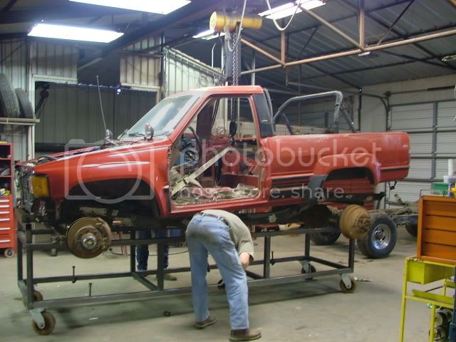

:bounce:Got the body on. Going to have to raise a small section of the floor 1". It took a 1 1/4" body lift to get some good clearance for the tranny. Fit but was really tight.

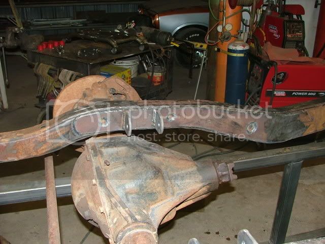

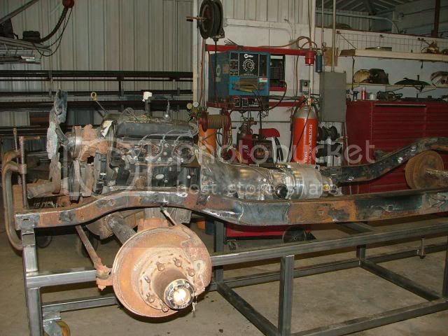

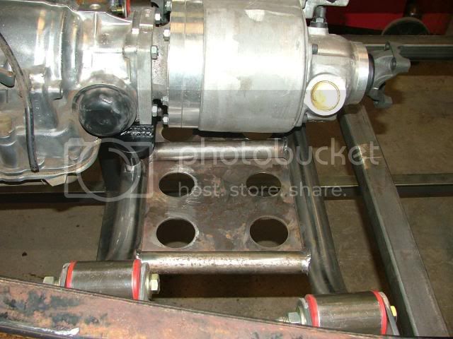

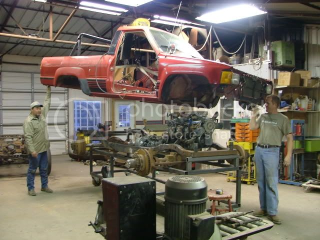

Got some more progress pics. Last week we got the motor, trans and t-case temporarily setup in the frame and we placed the body on the frame to see how it fit. After checking it out we decided to move the rear axle forward 2”, clock the t-case down about 5 degrees and decided to lower the motor about 1 “.

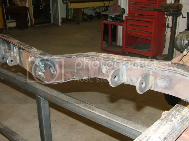

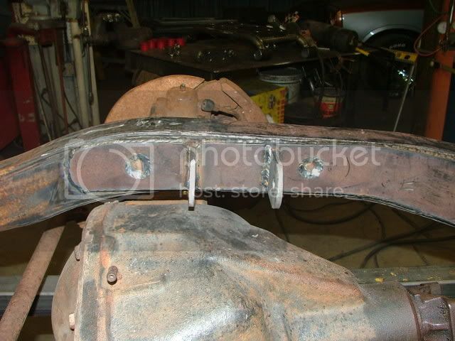

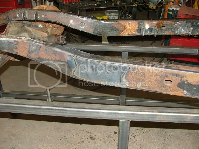

decided to stiffen the front portion of the frame by adding some plate to the inside and fish plating a section on the out side of it. got all the tabs welded on for the motor and skid plate mounts.

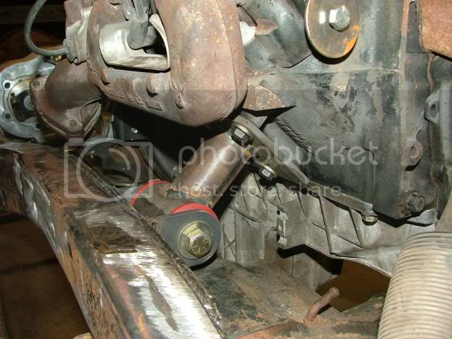

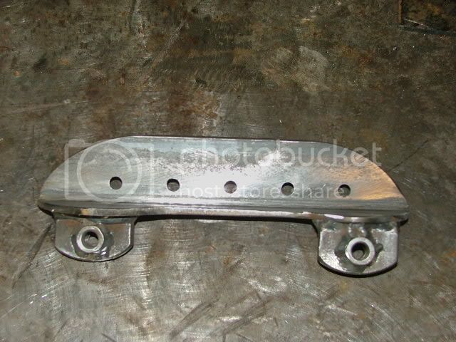

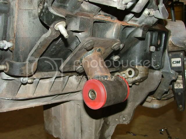

Motor mounts

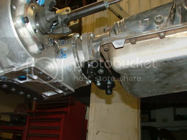

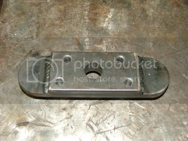

Trans mount
T-case mount

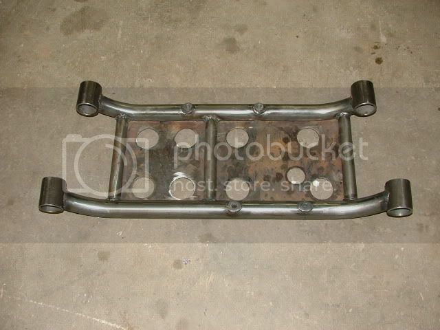

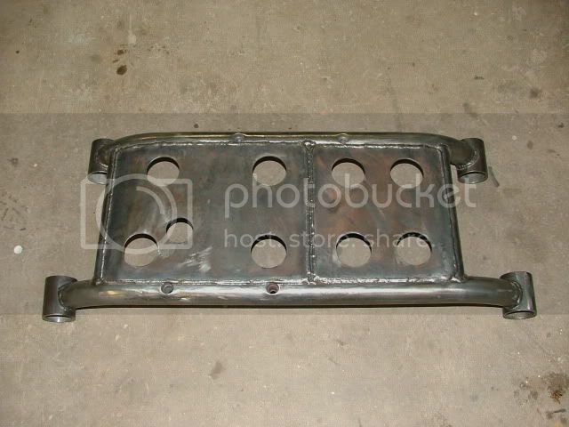

custom built skid plate
Side view. It is exactly 2" below the frame to the bottom of the skidplate.
Going to have to come up with some type of skid plate for the tranny sometime later. The guy doing all of the work is doing excellent. He is an anal s.o.b. I went to Jr High and elementary school with him so he knows I'm a no welding ass who can only sweep floors.
