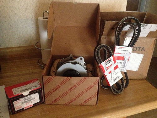

Well parts fairy showed up just now with some deliveries for me!! Just waiting on the JimC pulley which should be here Saturday!!
Untitled by renofizz, on Flickr
So got the new Alt, PSP and belts routed. While I was in there I went ahead and trimmed my slightly kinked WP to T-Stat hose and top rad hose. The top rad hose is going to have to be replaced soon though as I did not realize it was about a 1/2" to large ID and was seriously tightened down. Of course, being the dumbass that I am I did not realize how much coolant would come out when I took the hoses off and so I probably lost a good GALLON of coolant all over the driveway.:doh::whoops: :bang::bang::bang:
Ended up HAVING to trim both those lines because of the fact they were both contacting the PSP and Alt. It is amazing what the right belt and pulley can do. For instance, the original Alt had a double line pulley on it that was not correct, the PO was running this to the WP then the Crank to take out the PSP (it has a slight wobble in the pulley). So the belts didn't fit properly and the alt was ALL THE WAY at the end of the adjustment bracket. Now with the right pulley/alt, belt and the PSP added back into the mix it is about 2" from the WP to T-stat hose and has probably a good 1/2" of deflection at tension (I will have to adjust this I know).

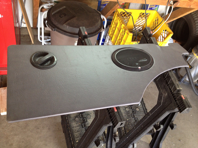

Earlier in the week I had bit the bullet and bought some Rockford Fosgate 6x9s for the rear cargo panels as my dogs has put another hole through one. Found out that my CITI Thank You card had enough points on it that I got my Fosgate R1694's for free!!! So got those on Thursday with some speaker wire and spent most of today completing the rear panels.
Sorry no build picks but I did use 1/4" SurePly that was on sale (got a 4x4x1/4 sheet).

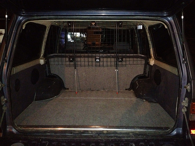

Here is the final build and installation. They sound great! Next will probably be a small powered sub like a 10" Bazooka tube but that will probably wait until next year.
Sorry for the last one but I did not get home from PnP until afternoon, then grabbed some 3/8" Return hose line as a "Just-In-Case) replacement for the PSP. Figured I needed to wait for the PSP and engine to cool down so I started on the panels. After almost 5hrs I finally got them done then went to have a :beer::beer: with some friends then came back and finished routing the wire and installing the panels. I still have to screw them in but for now they are in there just fine!!
Those panels look good! I am needing to do something similiar with mine, they are flopping around and kinda torn up. What did you use? 1/4" particle board? (Sorry if you previously posted)
