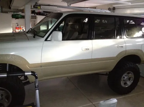

Wish I had known about this a little bit sooner. I had just finished my Al's liner job when I saw this hint. Oh well. The hardest part for me was taping the damn wheel wells! I could not get the tape to stick to save my life. I'll post pics later today.

Here is a quick pic of my Al's liner job.
