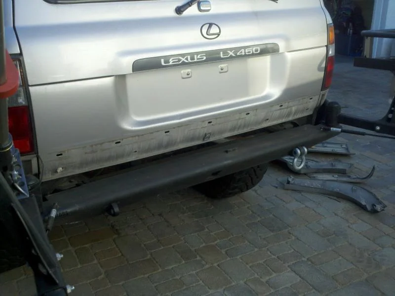

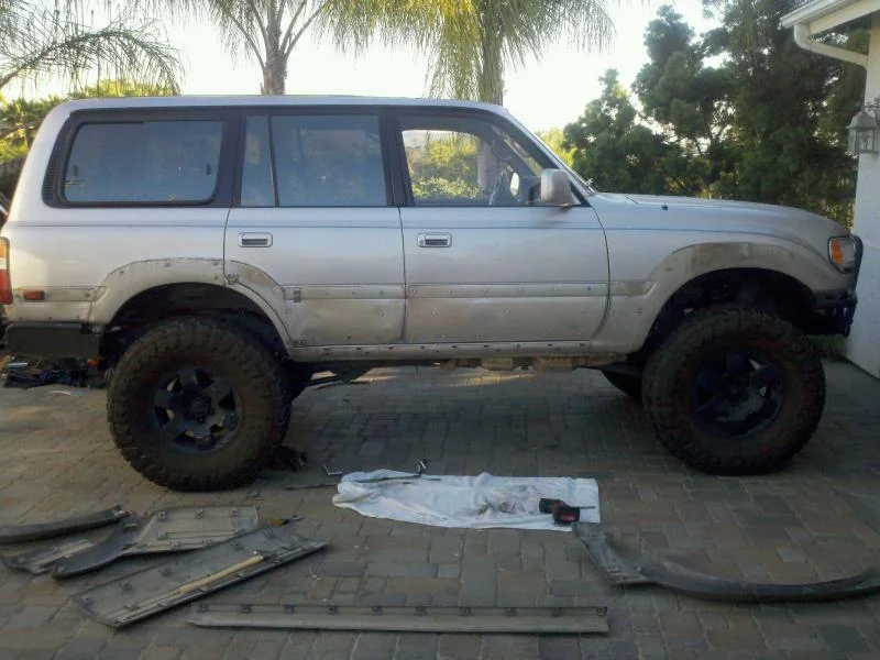

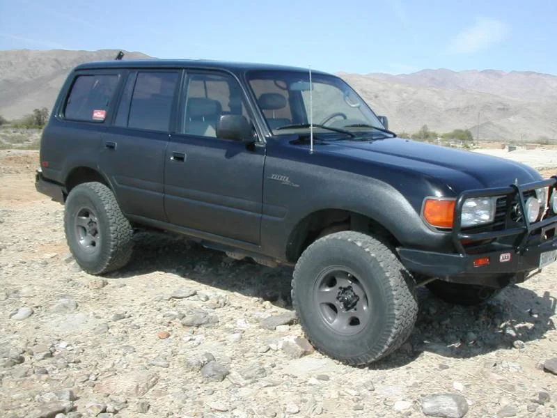

So, after many encounters with the rocks on my wheelin' trips, I finally decided it was time to de-flare my Lexus. Originally my plan was to spray Al's Liner on the same lines of the flares. But, after my last run, I have decided to spray the liner on the higher line like Landcrusher70 did when he Upol'd his rig. Tonight I started this project by removing the flares. Next will be body work and the filling of all these darn holes. Here are some pics. Before, Landcrusher70's rig, carnage, and removal of flares.
First, before and the rig I will match with my liner:

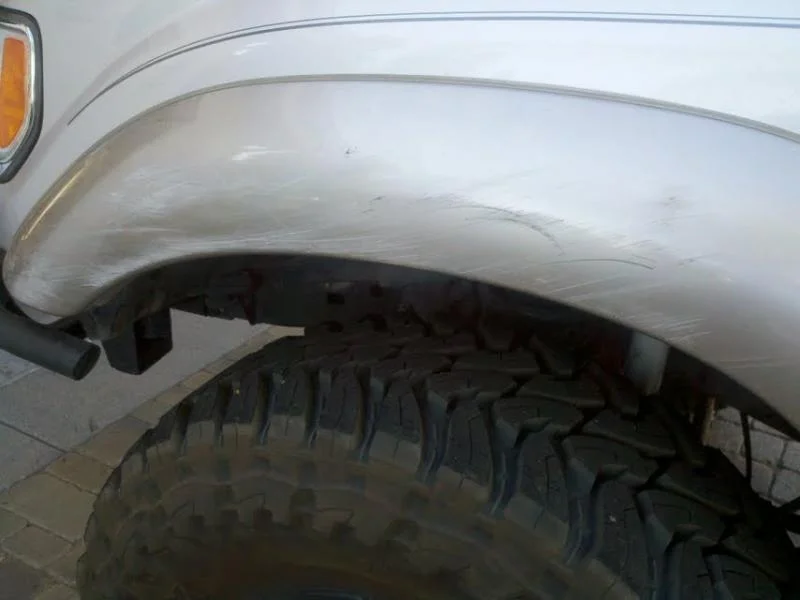

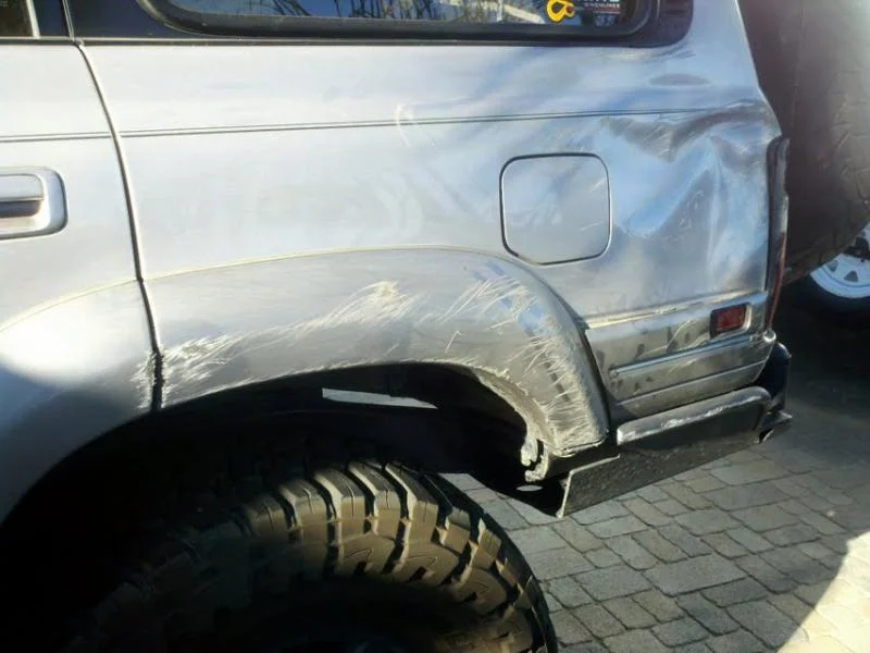

Here are some pics of my recent carnage:
More Carnage
More pics:

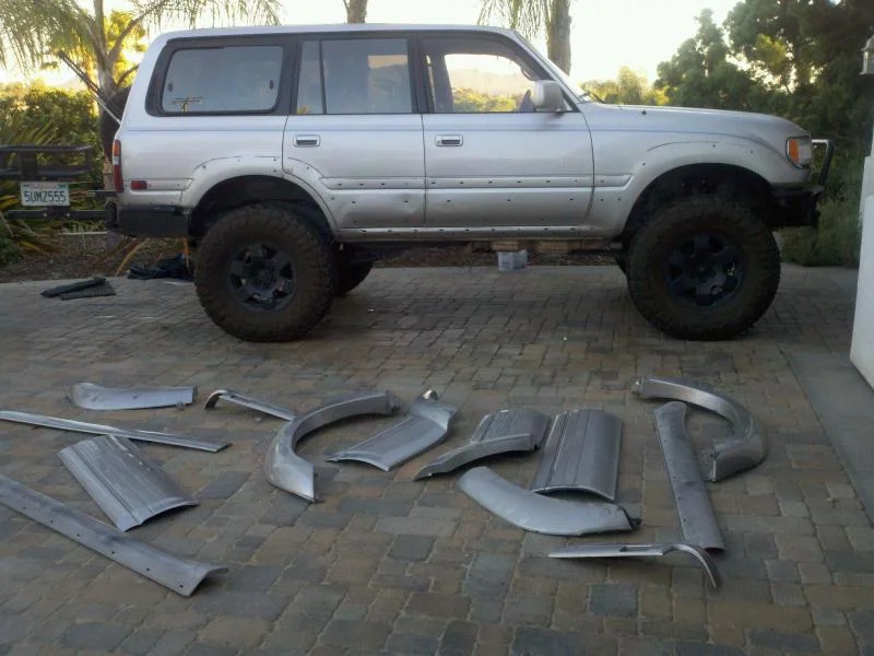

Time to demo, oh what fun. Next will be filling all the holes. More progress pics to follow.

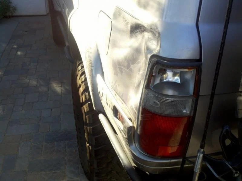

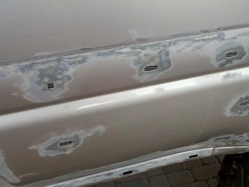

I've been crazy busy at work so I haven't been able to work on the cruiser 'til this weekend. I started by taping the backside of the holes with fiberglass mesh tape. It is self adhesive but I used 3M Super 77 spray adhesive to help hold it. I then went to town with the Bondo. Dang there are alot of holes!!!:bang:
Pictures of the progress:
Very nice! and welcome to the De-Flared Club!!! You won't regret it! You are lucky the Tupperware didn't cause any dents in the body, mine did on one wheel well.
Looks like you needed a Hanna rear bumper to save that rear quarter panel. I will go ahead and trade you mine for that 4x4 labs straight up to save that other quarter panel.
Nice try on the bumper Mark, :p. I am actually going to add some tubing to the wings for protection.....I see more BIG rocks in my future :hillbilly:. Regarding the Tupperware, it did provide protection, but I still ended up with some hidden dents.
Look closely at the rear passenger door:
Dang, that is a lot of holes.

I only sprayed some zinc stuff on the holes from the outside and covered with aluminum tape. Should I be worried about rust from inside the body?
I heard thats how to do it, just treat the holes, splap some tape over it and line it.
I guess moisture and water/mud could sit in the holes and rust though.
I dented my rear quarter like that and I was able to push a good amount of it out from the inside
It was not perfect but it worked and was fairly easy.
