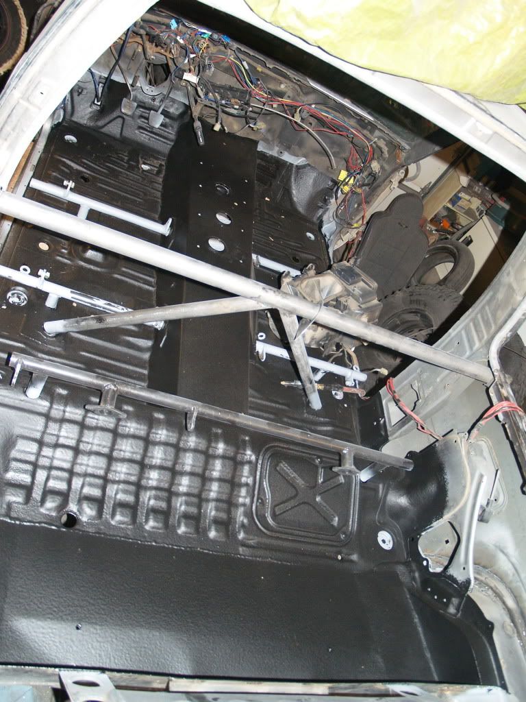

I used Monstalineron the floor of my 4runner and I mixed the whole can at one time.
After rolling on the first coat and waiting about 3 hours the remaining liner was still wet enough to roll on the second coat.
By the time I was finishing the second coat it was starting to get too thick to roll it though, but that must have been about 5 or so hours after mixing... it is very dry here in Wyoming though.
Happy with how it applied, no real durability info yet
