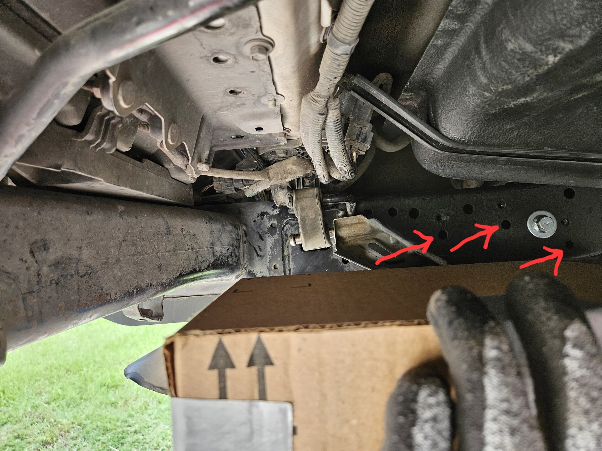

I have some charcoal canister problem-solving to do. Very first task of the day is relocating the charcoal canister. Plan was to mount it in the passenger side bumper wing. While the canister technically fits there without any hoses or mounting brackets on it (oriented with the connections facing forward or backward), there is zero clearance left for any connections. Not to mention, it leaves insufficient body / frame clearance.
It will not fit flipped up on its side.
If I turn the canister so it crosses the frame rail, then there just might barely be enough clearance between it and the subtank to make the connections. There is enough clearance from the frame, too (at least an inch) as long as I can figure out a way to mount it as tightly as possible against the body.
If that doesn't work, then I'll have to consider mounting it in the engine bay like @grinchy did.
I'm also going to have to figure out how to mount the spare tire bracket on the lower holes, since the lower set of holes interfere with my E&E bumper mounting bolt.
A stock LC bumper would fit the canister fine, flipped on its end so the connections are pointed up (and would probably just mount it to the frame using the threaded holes where the LX's AHC pump would go). But I don't have a stock bumper. Will figure it out, though.

Temporary solution until I figure out what to do with the charcoal canister.

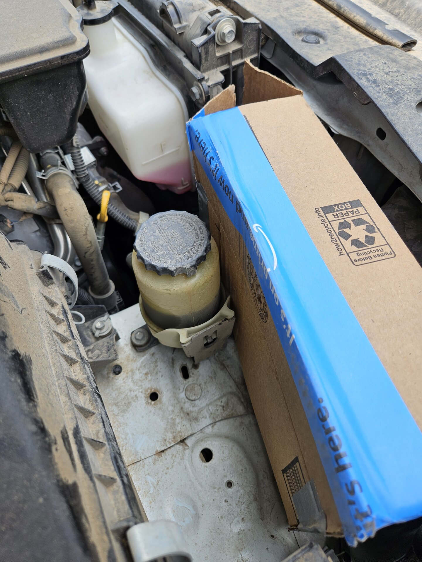

Cardboard mock-up of the charcoal canister. The extra flaps on one end show how much extra space is needed for the connections on that end.

I see two possible places in the engine bay. The first is on its side in front of the power steering reservoir, which would have to be relocated backwards an inch or so (I think that's what @grinchy did). The other is on top of the main fuse box, perpendicular to it. It appears to fully clear the hood when closed.

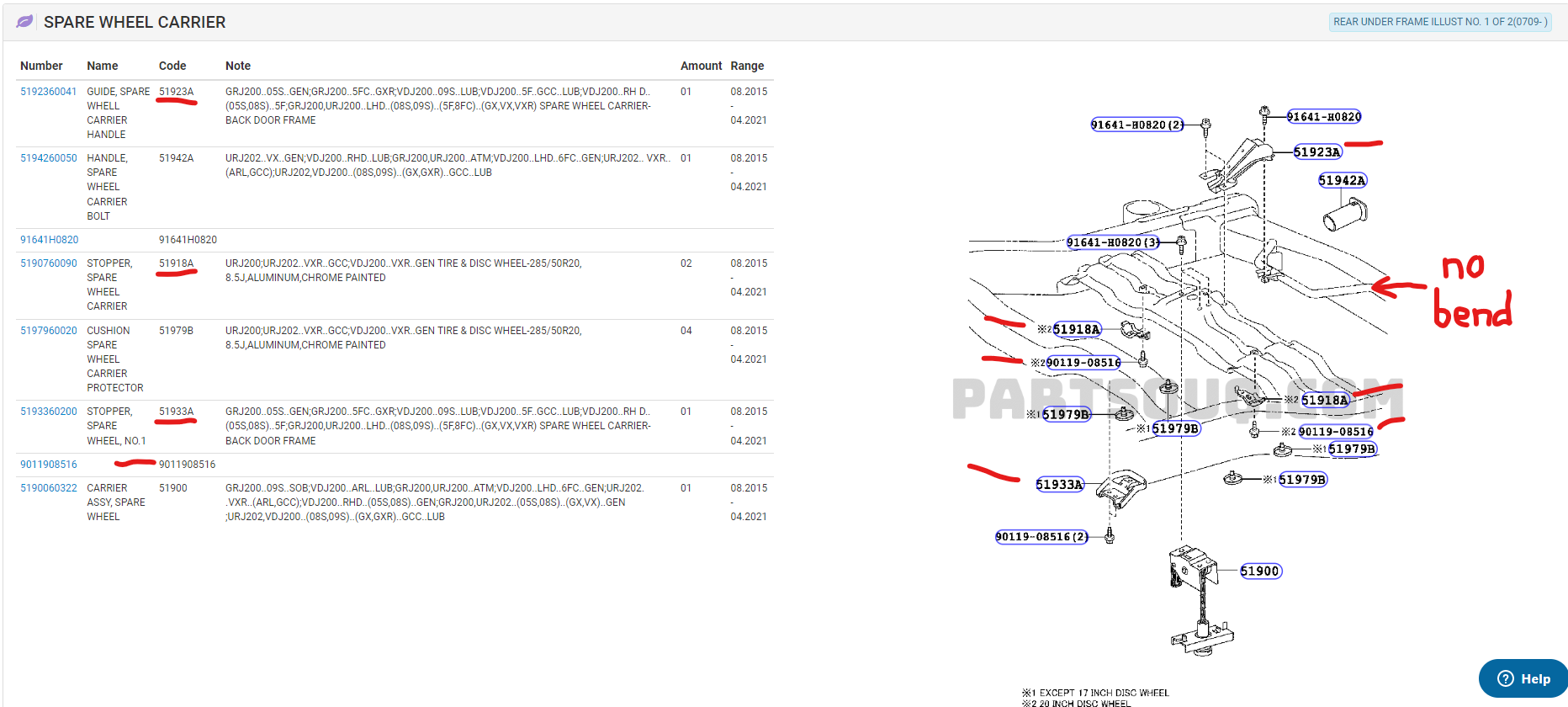

Learned that the spare tire stopper near the axle and the spare tire carrier guide are different part numbers when you have the subtank (since the tire sits lower). Also, there are two additional stoppers that attach the the spare support bracket itself. I think these last two stoppers likely make it so that bending the bar right behind the bumper is no longer necessary.
EDIT: The two stoppers do nothing, and are actually only used for LX 20" rims so that the larger diameter rim only contacts the rubber stopper instead of metal. You still have to either bend the bar (which I did not do), or deform the carrier guide (which I did do).
I have fond memories of doing the same thing. if you do relo to the engine bay, reuse the existing hardline for canister fume burn off as the vent in, and then the only hoses needed are in the engine bay (much shorter).
Yes, I had to cut quite a lot off the top of the part 51923A to get it to fit under the sub tank. The part is not structural (it's only a tube for the lowering rod to go thru). Easy work with an angle grinder.
