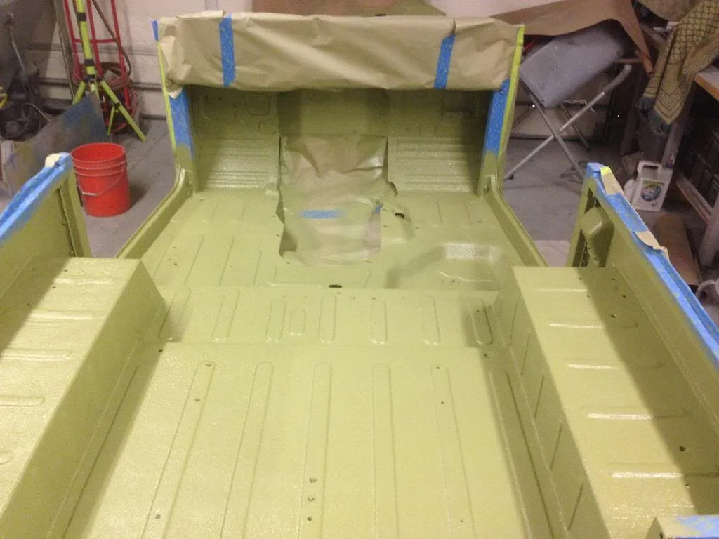

Like this?

I wonder if it would make a difference on the bedliner product??? It seems to me that LineX is a very stiff liner, where Rhino and Reflex are more of a rubbery product?? I wonder if the rubbery ones would do a better job at protecting the metal/paint underneath? Just curious if anyone has any experience with other brands...
