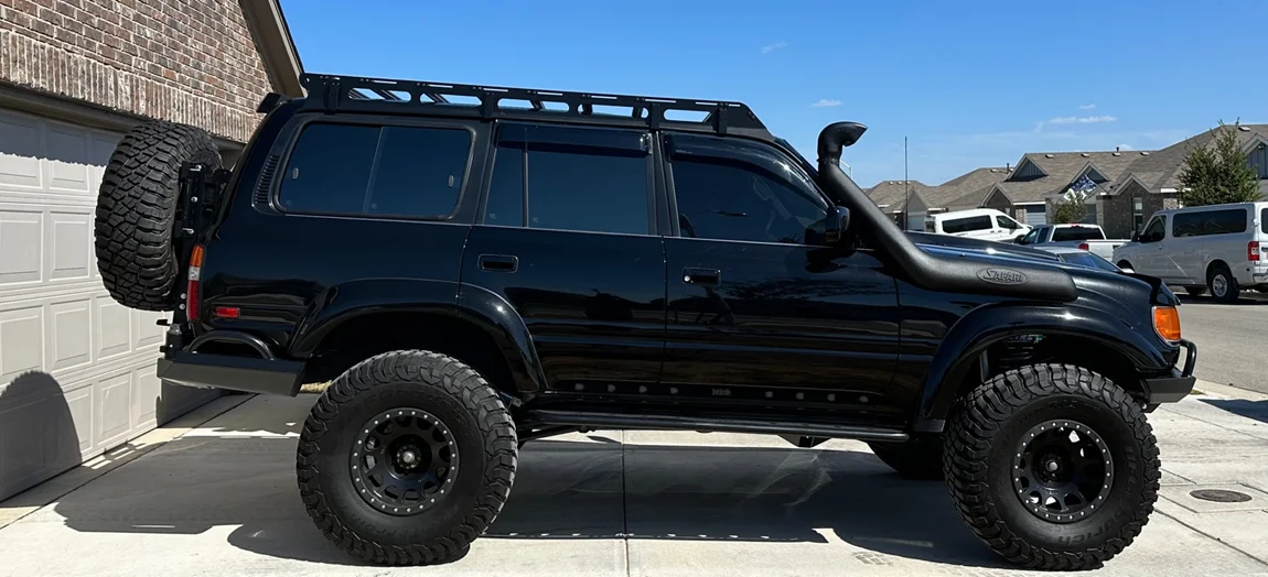

Could you post a profile photo of your 80 or a link?
It'll make you feel bad about our rust buckets. Nick has the most immaculate 80 I've ever seen. Looks like every nut & bolt is brand new!
Sounds awesome! My interest was in seeing the stance of his 80 on the Slee 4” lift. His opinion concerning a firm ride is rare and I share that with him. My rear coils are Slee 4” heavy progressives several years now. They do lift the car near 6” empty but we can load what ever we want and she maintains 4” lift and doesn’t sway all over. I went to his Instagram but his name is very common and didn’t get me anywhere.
Here's a screenshot from one of his pics
I like that bumper…. Overall, the rig is too clean for me. What’s a Land Cruiser for anyway?
Yes it sits about 2” higher in the rear. My plan was/is a sub tank and rear drawer set up. If I end up not finishing it and sell it. I am going to swap in non heavy’s to even out the stance for auction pictures.
