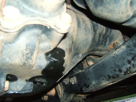

After only owning it for two months, I took the kids snow skiing and thought I’d try out the all wheel drive with street Michelin’s. Not a good idea, but I found the weak link of the 100’s. The two pinion front diff let loose and it was car trailered home. That started a list of modifications, my introduction to the ih8mud forum, and my first thread posting about exploding differentials. After $900 and my own labor, my new front diff was installed.
Yeah, three holes in the case

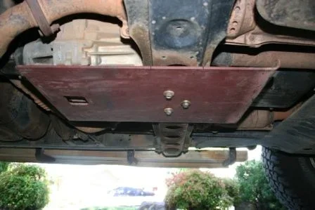

I cut the bracket off and welding it down into place bracing a little more for hitting those rocks until the skid plate is done.

The new plate is at the side yard for the new skid plate, but I couldn't wait for the transfercase plate to go on for a run so it's in place now and will be tied in to the main skid plate.
