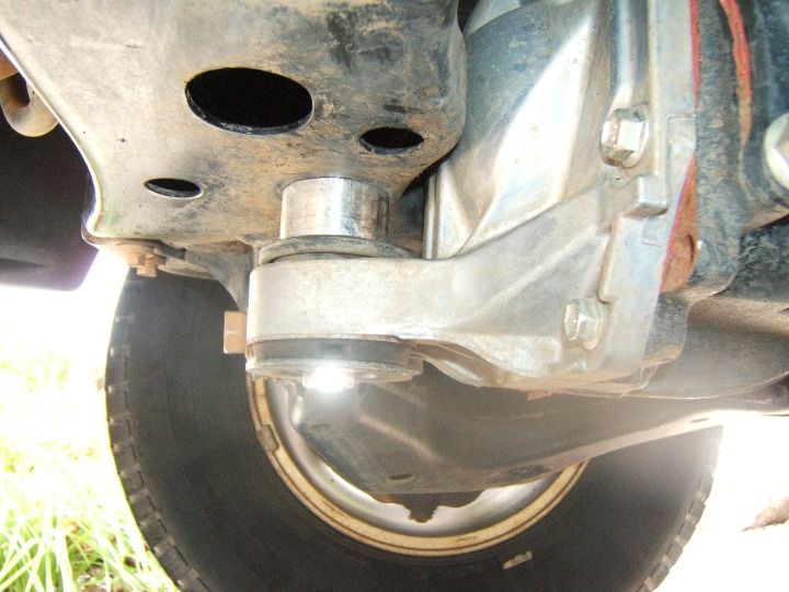

Had a little extra time today so I put the Cruiser up on ramps and started unbolting things. I made my own Diff Drop with the specs from Shotts site and scrounging up some nice 1 7/8 Stainless round stock from the local closed down Naval base.

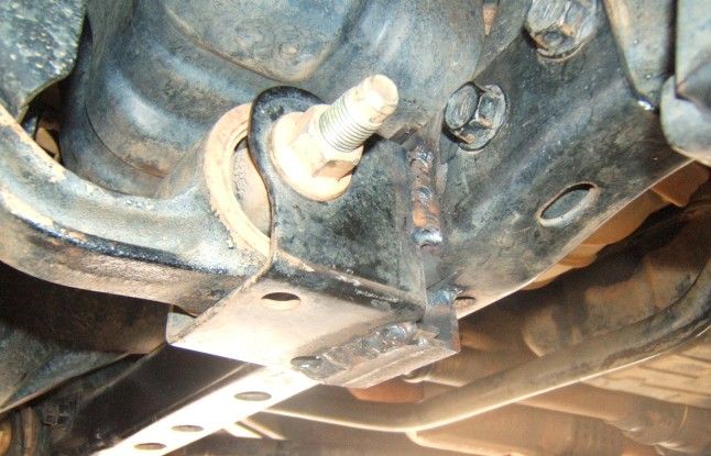

After removing the cross member and looking at drilling the relocated holes and having to cut out the bracing, I opted to just cut the whole bracket off the crossmember and relocate it 3/4" lower and welded it into place. Total time was about two hours of playing after making the spacers a couple of weeks ago. I tried to have the spacers made at my local machine shop, but after trying to cut this stainless stuff on a lathe he just asked me to take my surplus alloy and get out. So after burning up 7 Sawzall blades, I have really nice spacers that will NEVER rust.

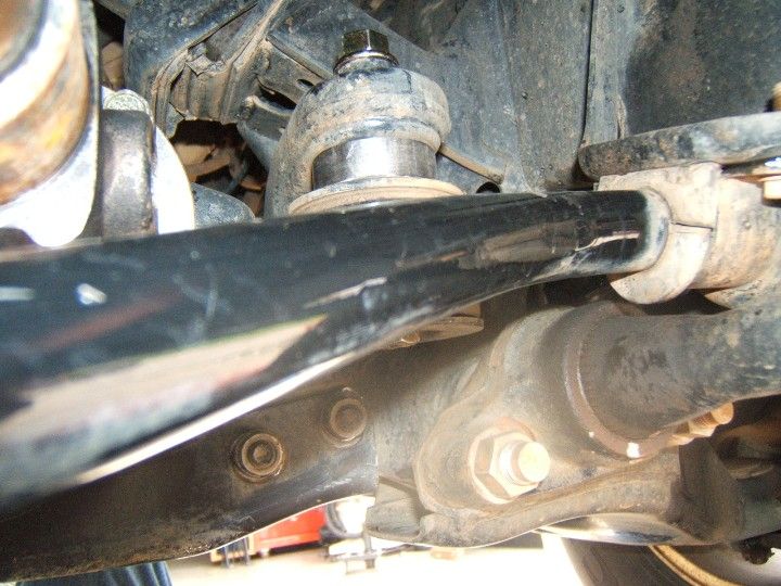

This is my differential drop that I fabricated out of some surplus stainless steel. Pic one is the 1" spacer on the front cover mount. I installed a longer 1/2" bolt and then had to fish the nut into the crossmember for the top of it. Notice the new four pinion diff there!
Picture 2 is the welded mount relocated 3/4" down after cutting it off the crossmember.
and picture #3 is the rear mount spacer at .57" with the longer bolt.
